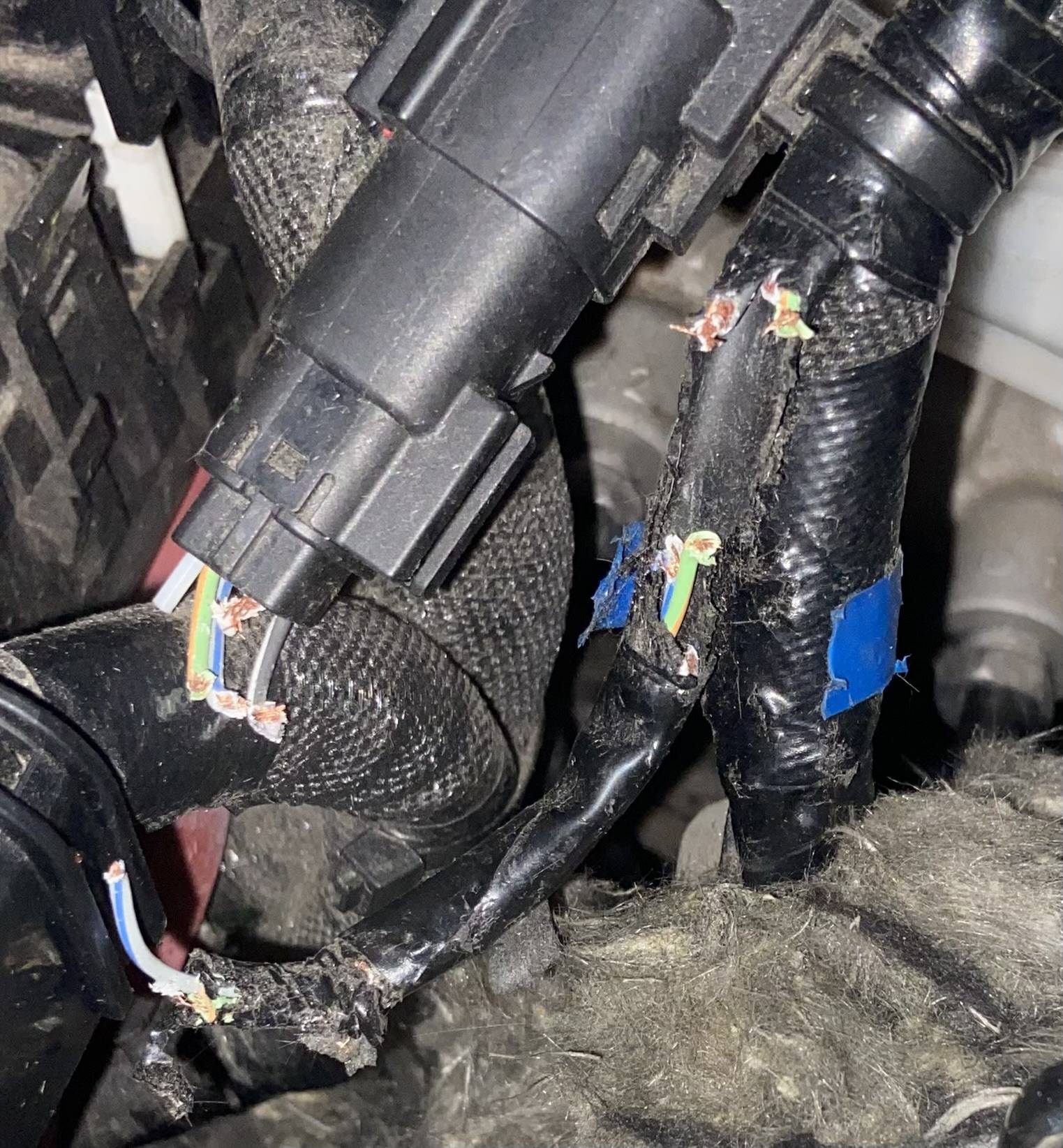

interested to here what your dealership says, my service manager seems to think its an electrical wiring issue/damage somewhere
Could be anything, including rodents.
At least one of those four chewed up wires below is for the pre-collision system. Ask me how I know.

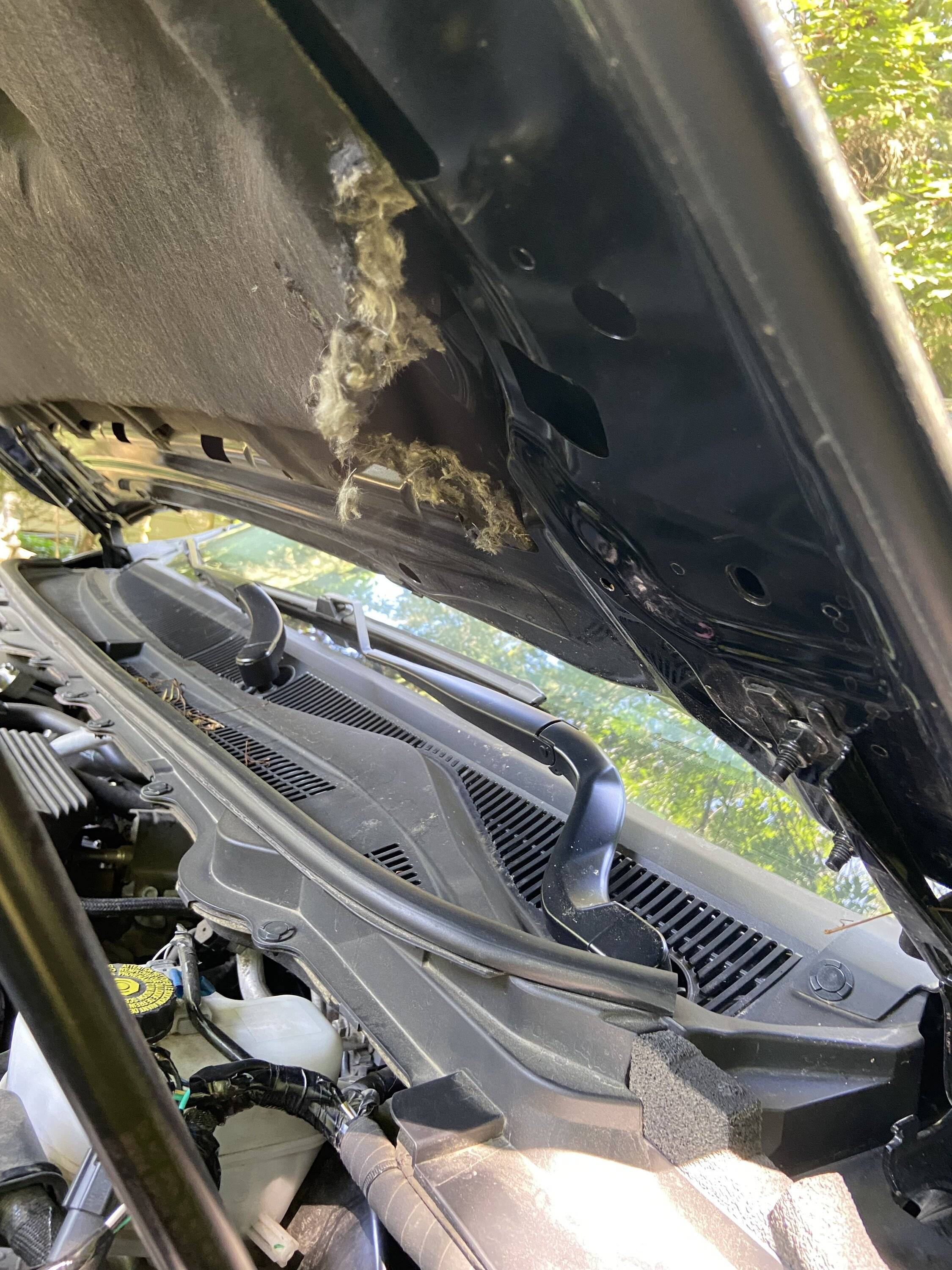

Is that a dead rat or cat!
That’s the hood insulation - I guess he felt like a nap after his snack and tried to make a nest.
