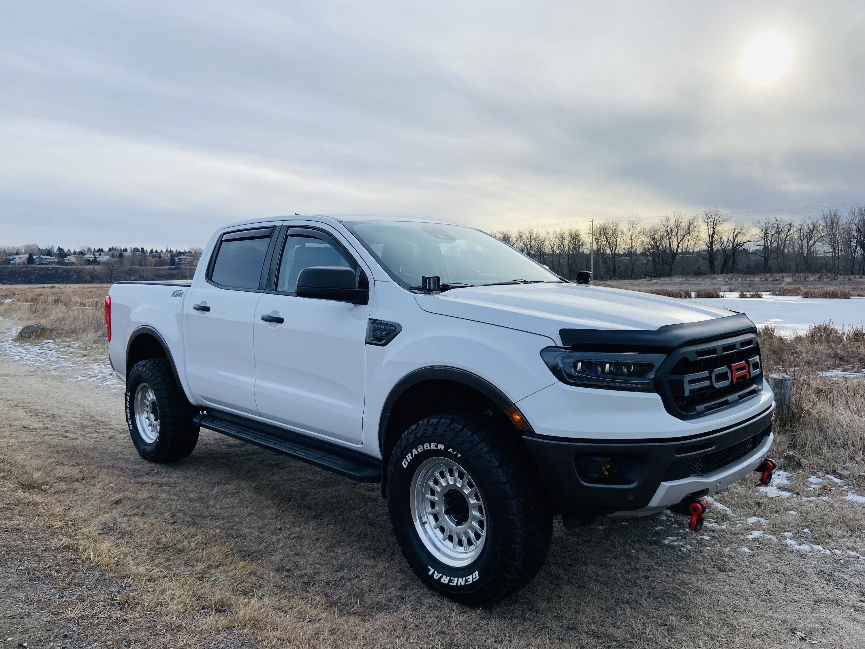

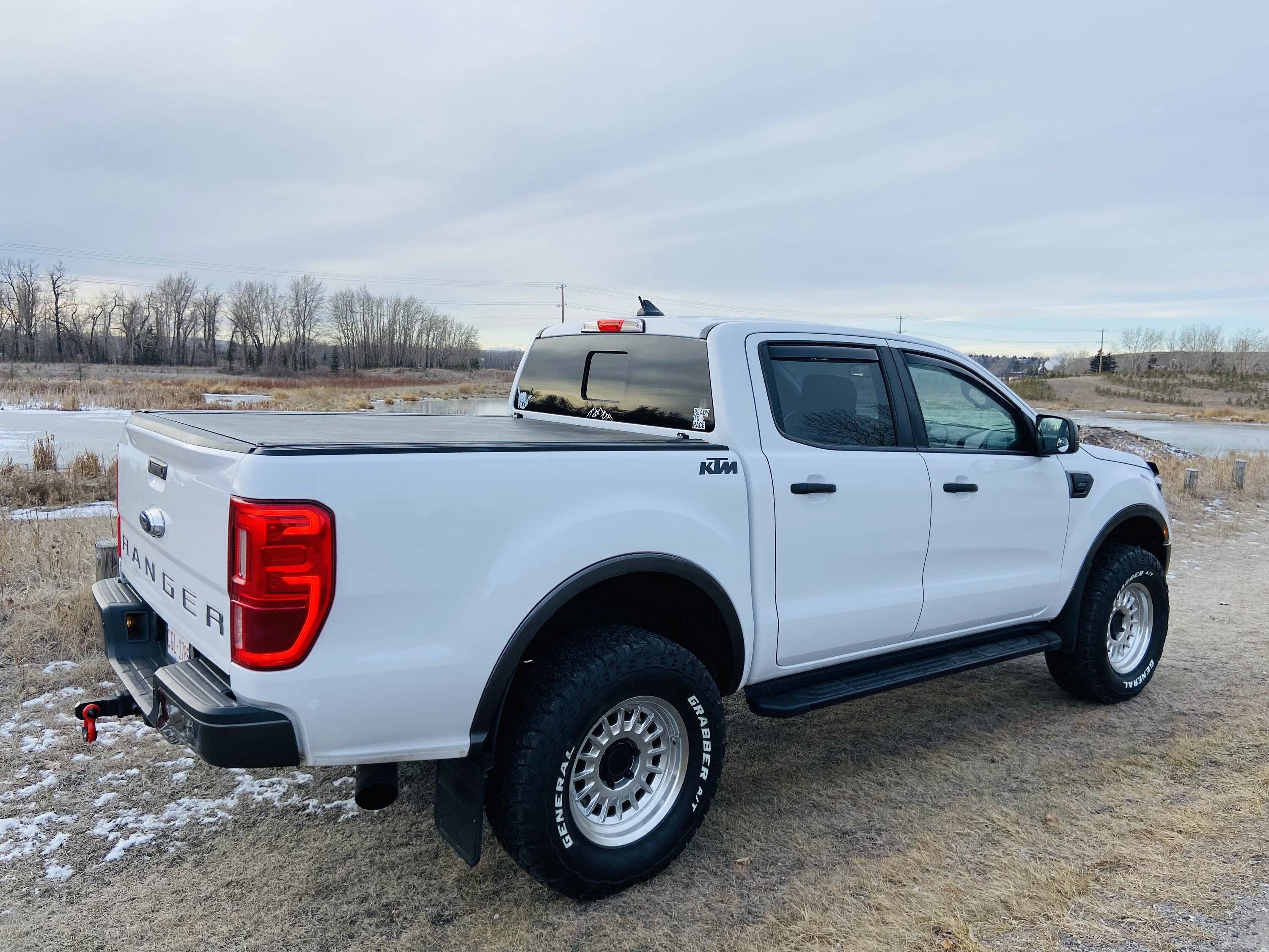

I’m running the Eibach 2R suspension with Icon leafs. Truck rides phenomenally. Eats everything. I’ve also deleted the sway bar, my only issue now is the top out clunk on the front which I’ll likely fix with limit straps. I’m on 33’s as well. Truck is super fun with this set up. Especially running the Ford Performance tune and Flowmaster catback.
