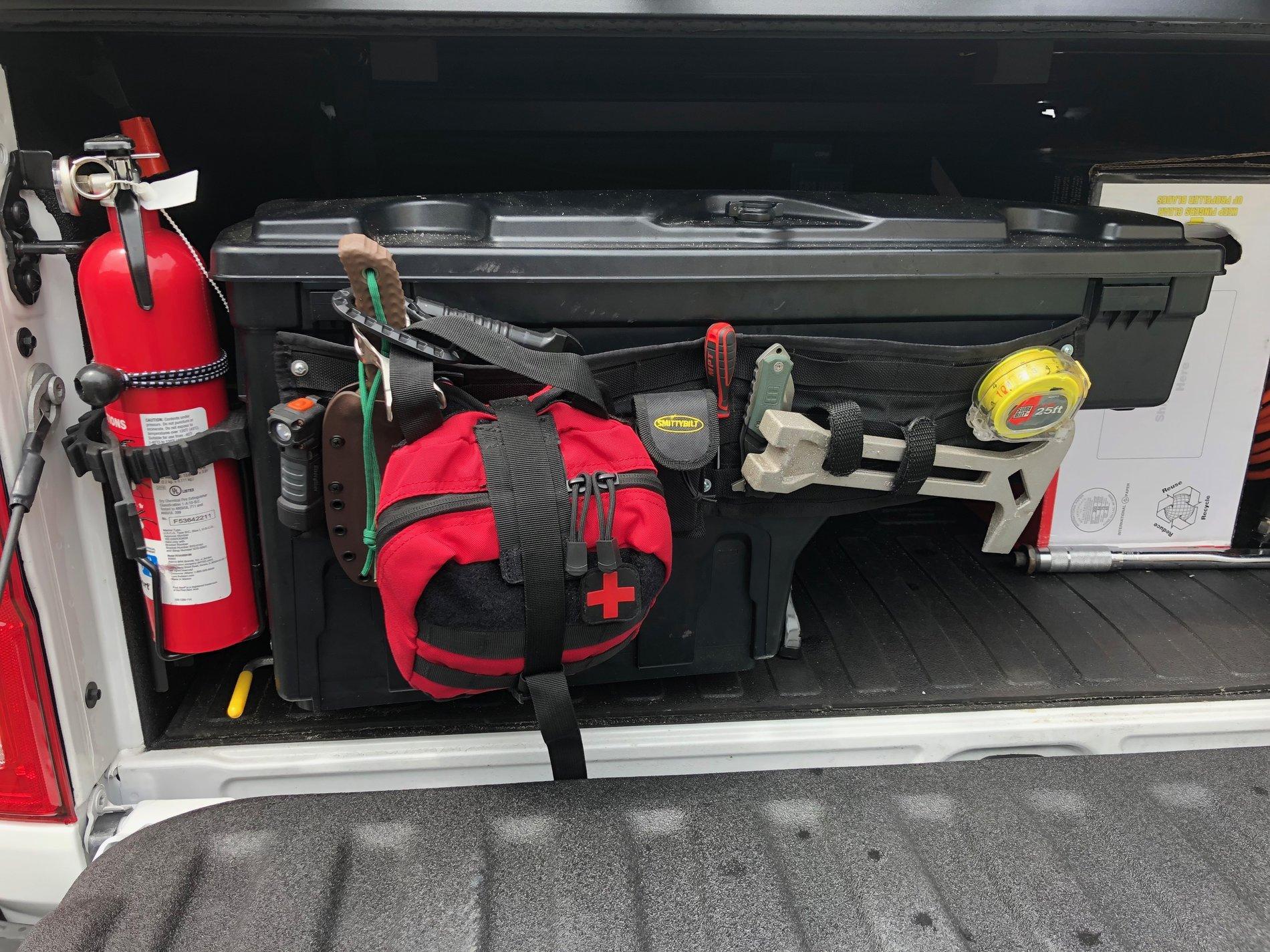

I have 2, one on each side. (Added a few things to it
https://www.ranger5g.com/forum/threads/slight-mod-to-the-ford-oem-swing-out-tool-boxes.2397/)
I actually converted the passenger side to hold my onboard ARB air compressor :)
The brackets it comes with seems pretty sturdy, the actual tool boxes themselves are decent size and quality.
(Although I wish the material was a bit thicker, or heavy duty)
It does help organize stuff in the bed, if that’s what you’re looking for.
PS- the cup holder feature is not useful, as anything you put on it would just slide off.
I LOVE this setup! I have a full emergency kit in my Subaru and I want to have a copy of it in the Ranger. This looks like a fantastic way to make it happen.

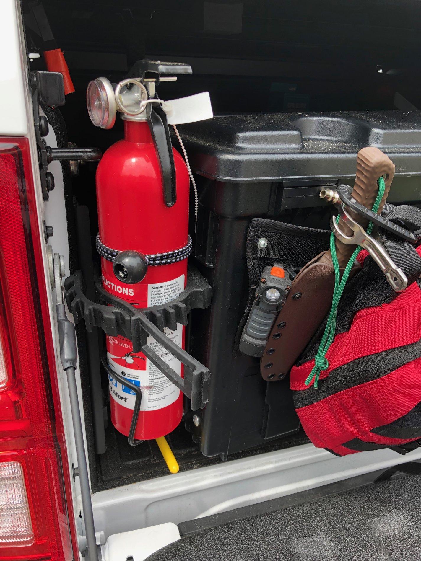

I will also echo, how did you attach the fire extinguisher? Also, I see that you have the spray-in bed liner. Any issues with installing these with the bed liner?

Thanks, I used an aluminum bike water bottle holder and a large Quick Fist clamp to mount the fire extinguisher. No issues, even after hundreds of miles on highways, rough roads and bumps.:)
BTW, the only minor issue with the factory bed liner, is that you have to scrape off some material from the oem torx bolts before you can remove them (so you can reinstall them with the tool box mounting plates).

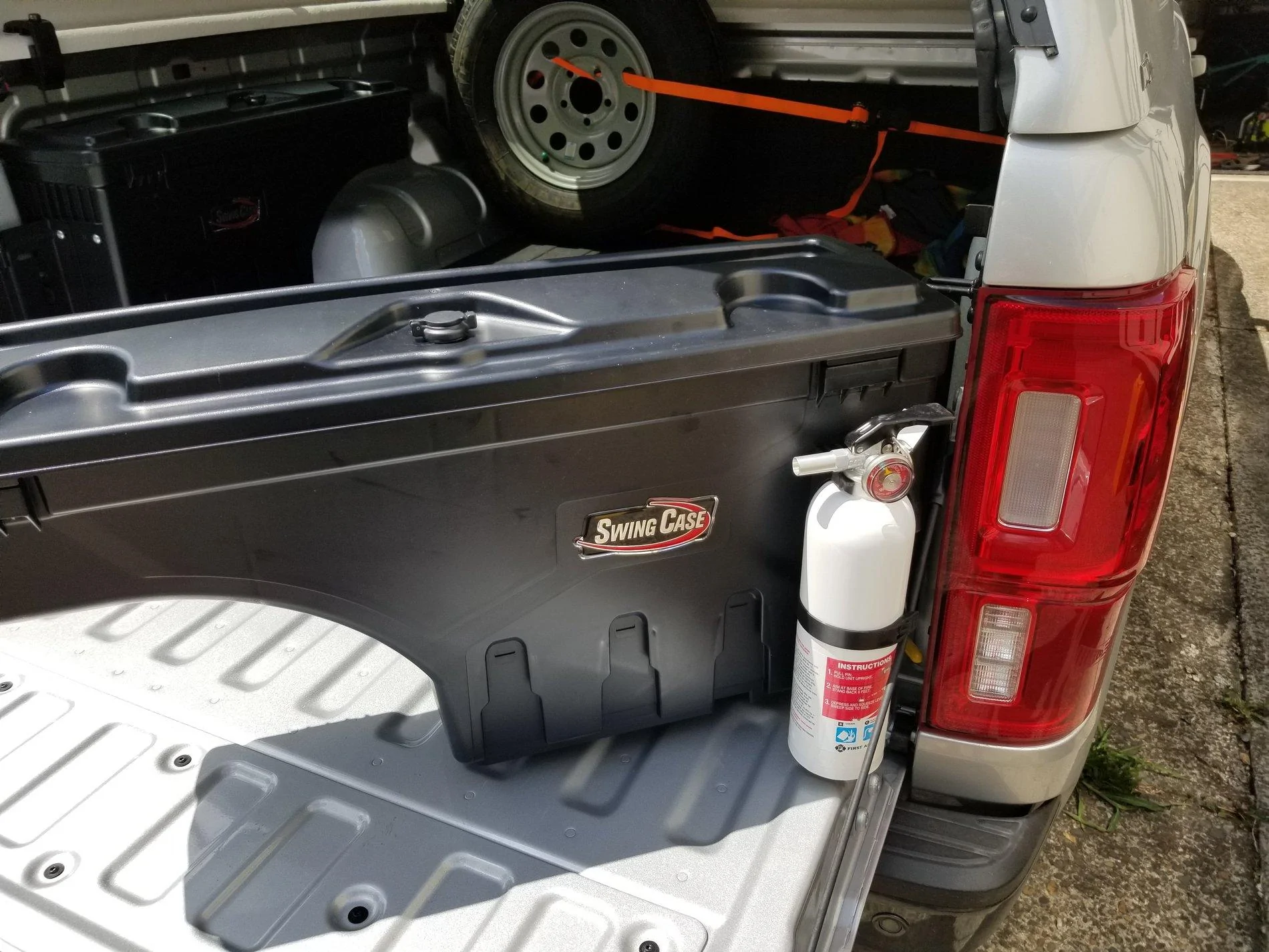

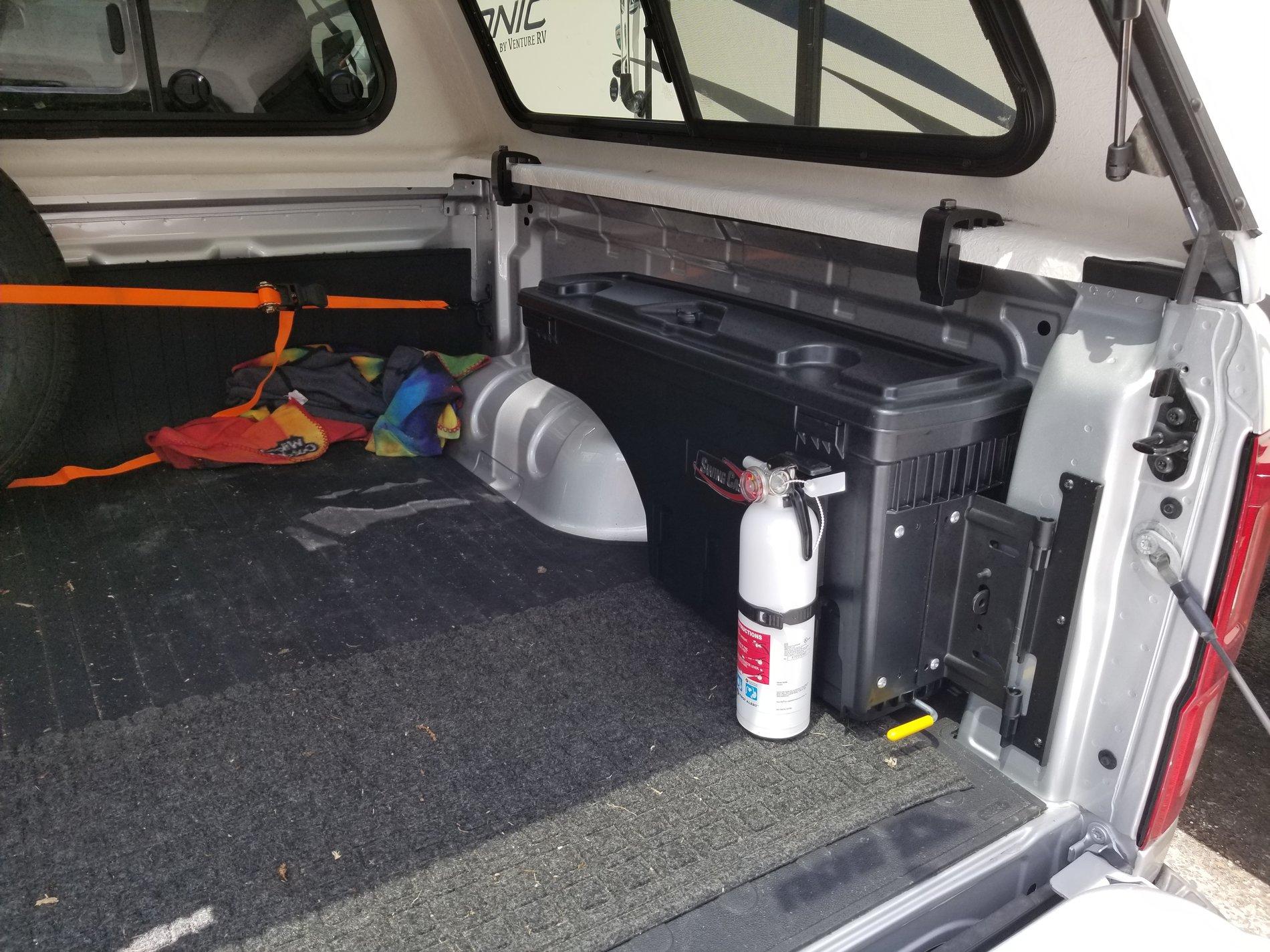

Hi everyone,
I ended up getting a couple of these swing boxes, and I really liked the idea of have an extinguisher mounted to it. I wanted it to not interfere with the ability to swing and remove the box, so I changed the mounting location. I reinforced the bolts with a thin piece of aluminum barstock on the inside of the box so the bolts wouldn't pull through.

Does the Fire Extinguisher mounted there interfere with the box swinging out at all? Looking to add one on my Pivot Box.

I can actually swing it out towards the edge of the bed with no problem.
It really depends on how you mount it, and the size of the fire extinguisher.
(Like I mentioned in my other posts, I used a an aluminum bike drink holder, and large QuickFist clamp. BTW the fire extinguisher is a smaller, slim UL type for auto and home)
