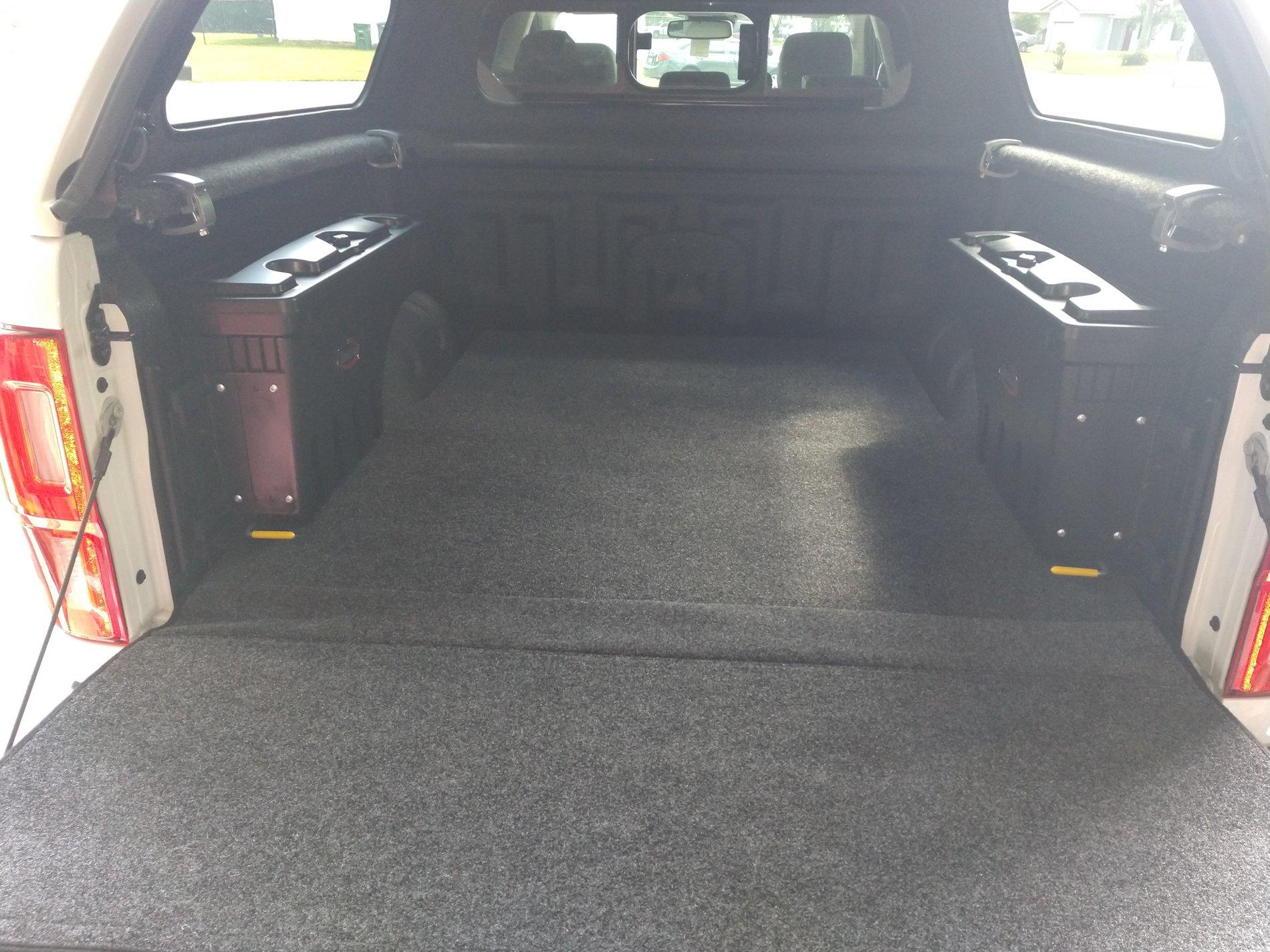

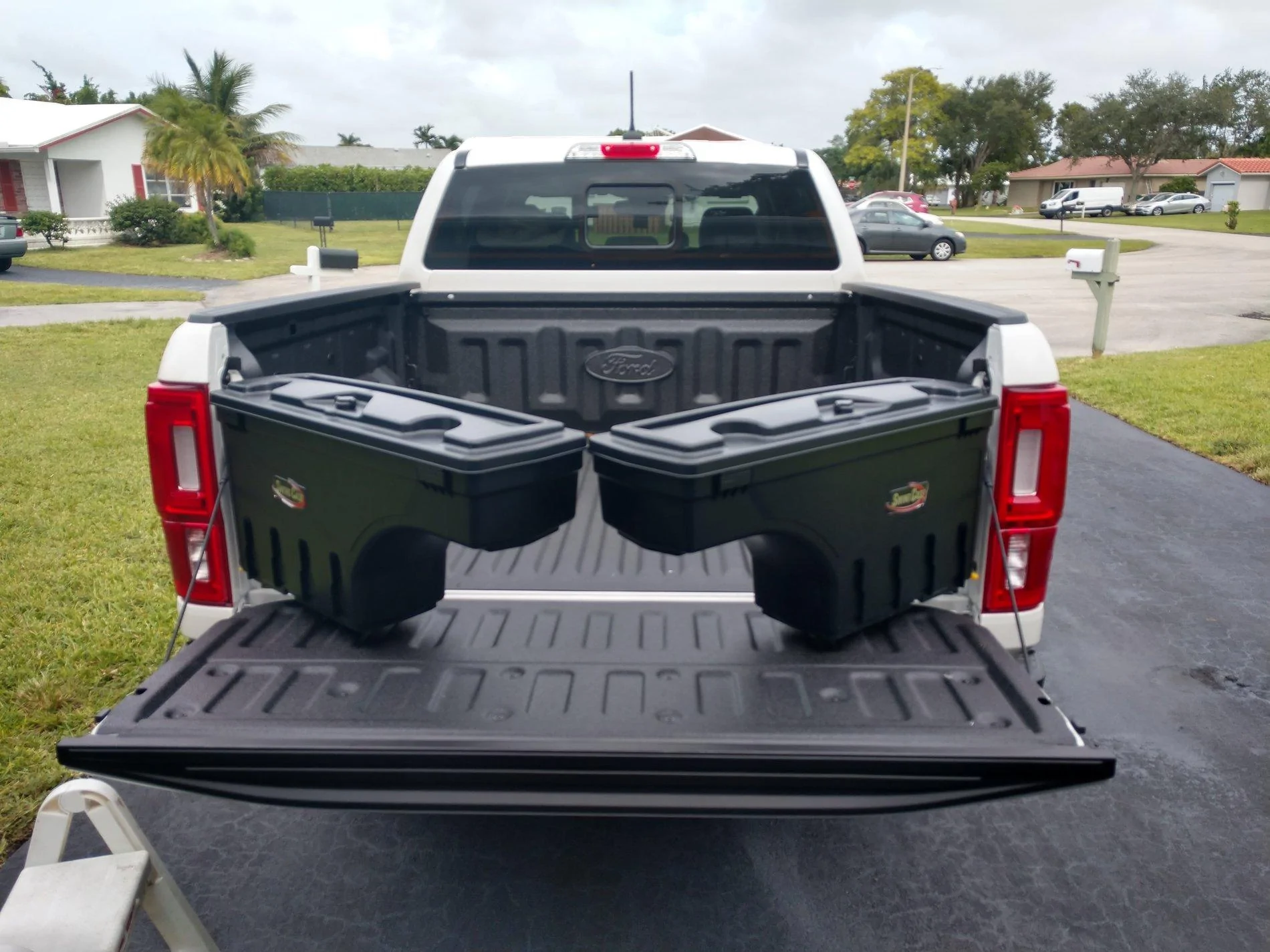

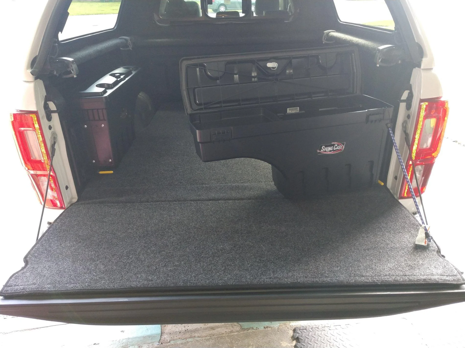

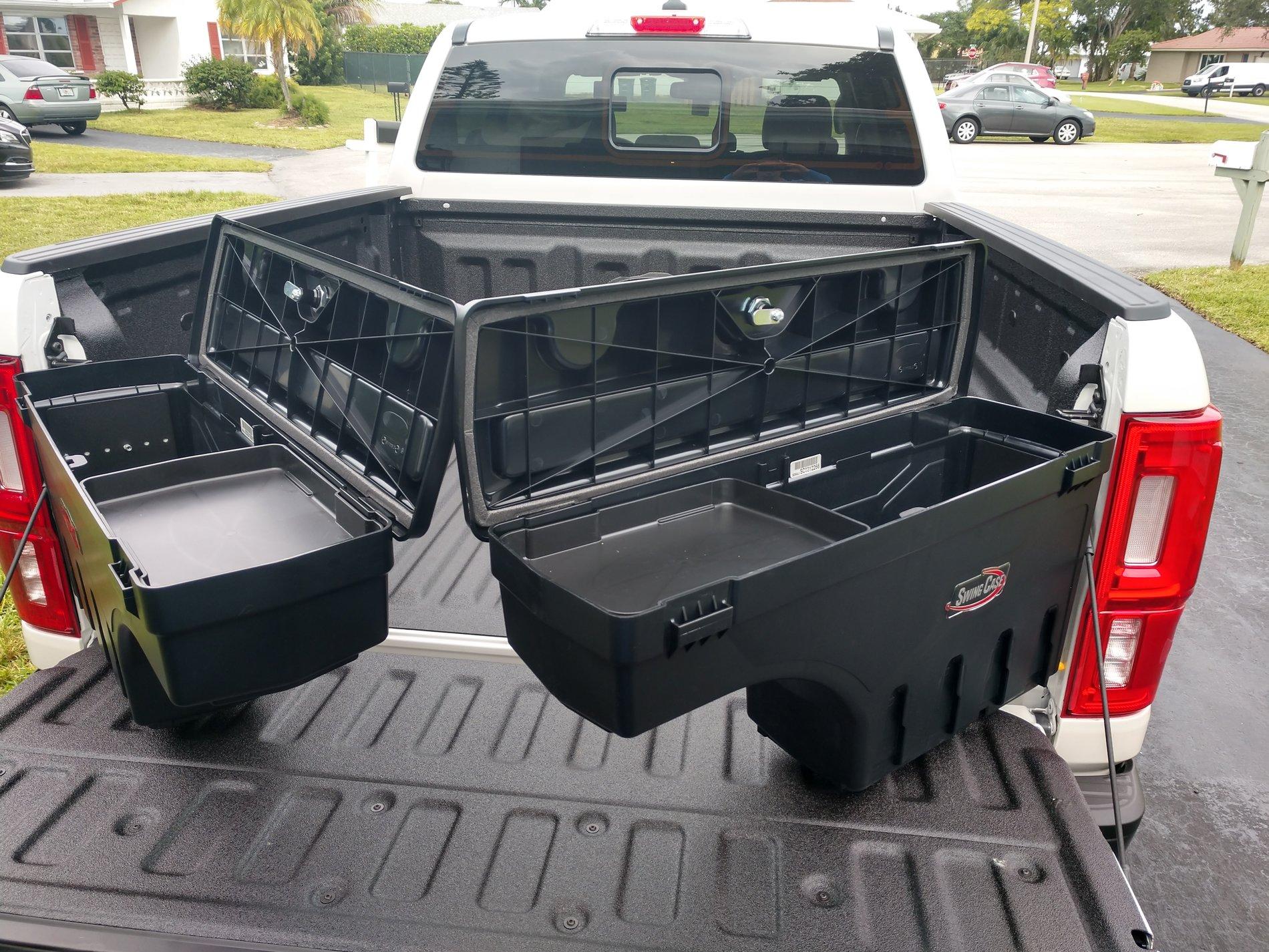

DONE! Swing cases in.
What a PITA. Why?
I was missing the middle tie downs so I had to use a tap to clear the threads that the Fordp spray liner covered and had to remove the spray liner from the screw heads to get them out.
I had to get additional screws because of the missing tie downs in the middle.
Good news is, I now have my 4 tie downs in the middle and the corners near the cab. The tie downs in the corners near the tailgate are completely useless with the swing case installed so the swing case brackets at the tailgate have two metal loops for a padlock so I can use those as the new tie downs. For now, I removed the swing cases and put them in my garage until I get my A.R.E. topper installed on Monday. When complete, I can put the swing cases back on their brackets and install the bed rug.
Very happy with the quality of the swing cases.
Truck is finally coming together.

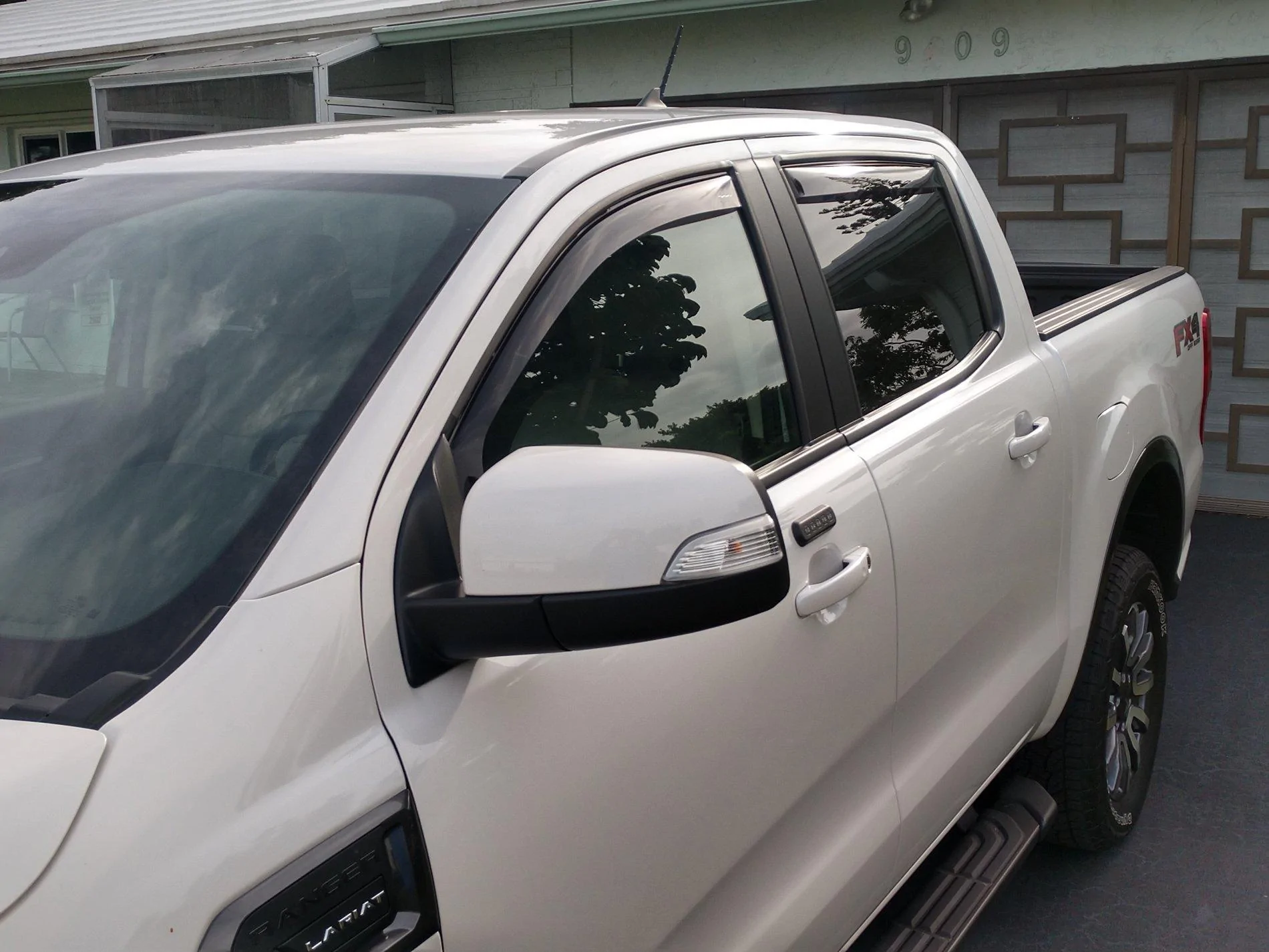

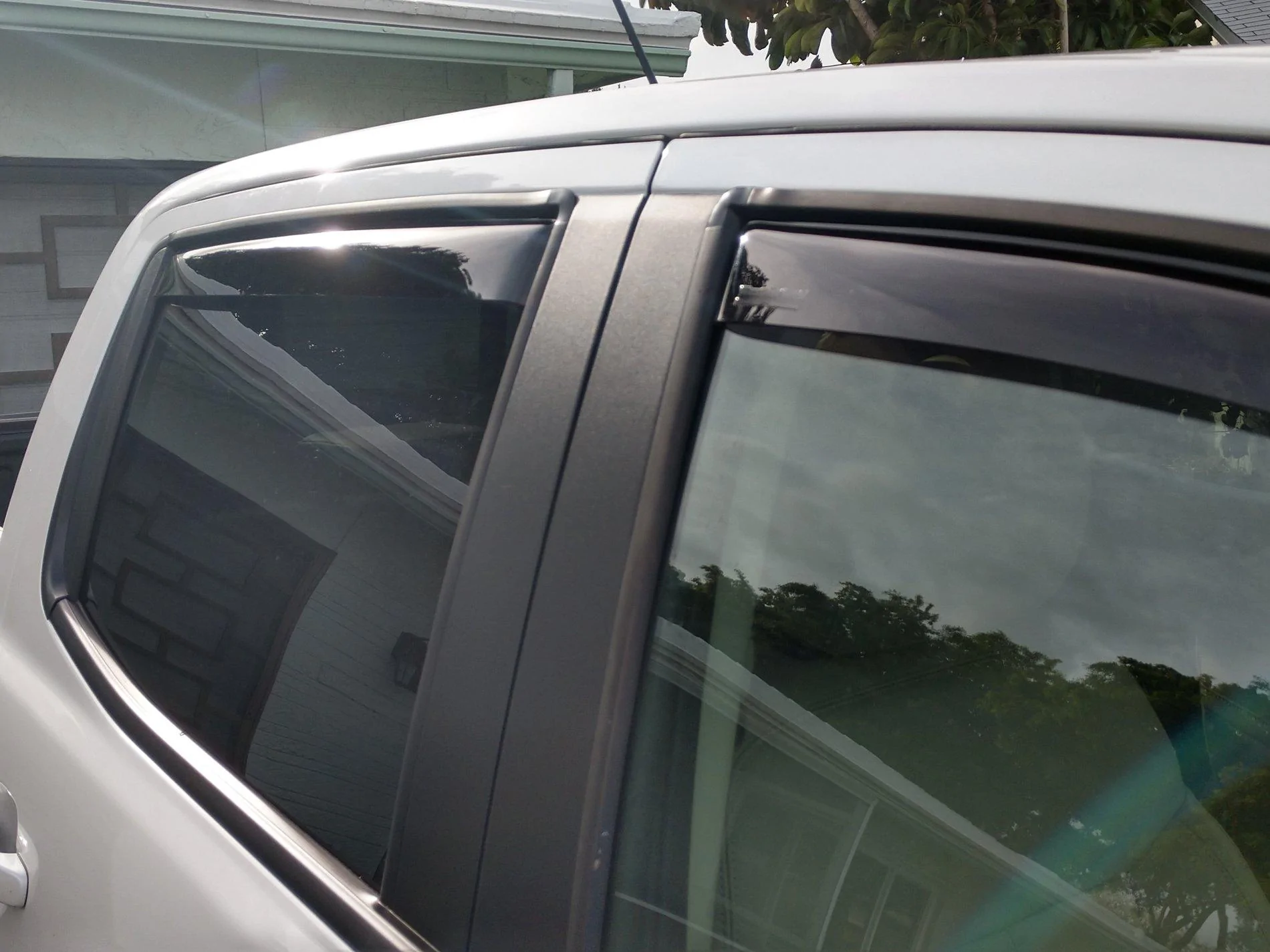

Next...install my Weathertech window visors. That should take no more than an hour. Lastly, the Wheelskins leather steering wheel cover. THAT project is several hours minimum.
Pictures didn't load in the order I chose them but you get the drift.
Weathertech in-channel window visors are VERY low profile and very easy to install. Took 15 minutes for all windows.

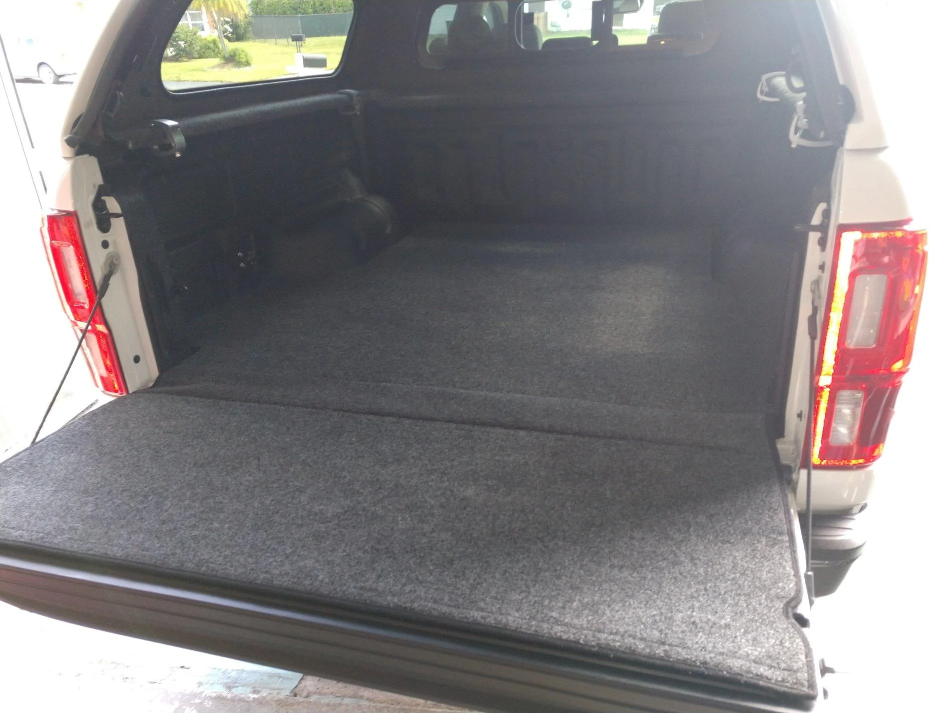

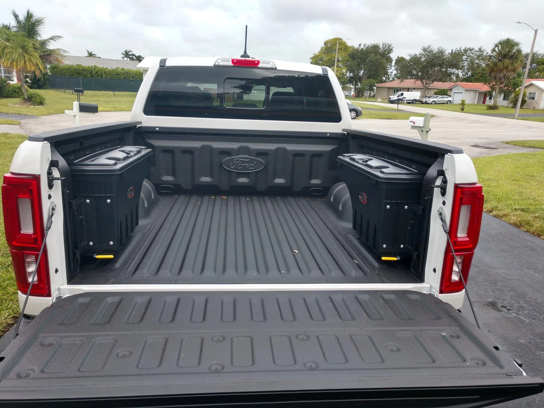

Looks too good to get it dirty in there!
I have a tarp for the inside but will be looking for a rubber mat to hold any dirt/fluids. I occasionally carry a generator and more frequently carry gas cans. For the most part those items would be the dirtiest things I'd put in the bed.

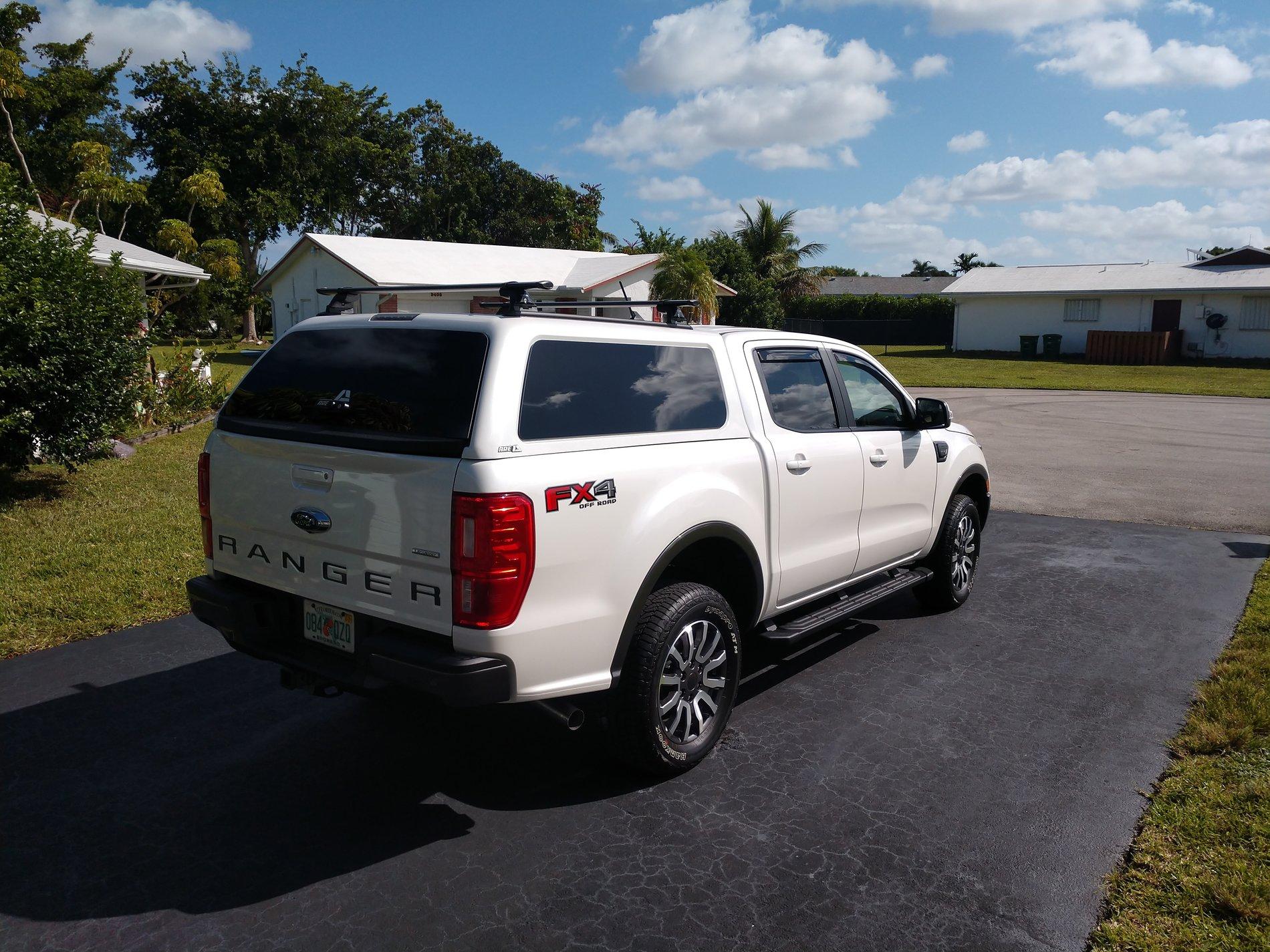

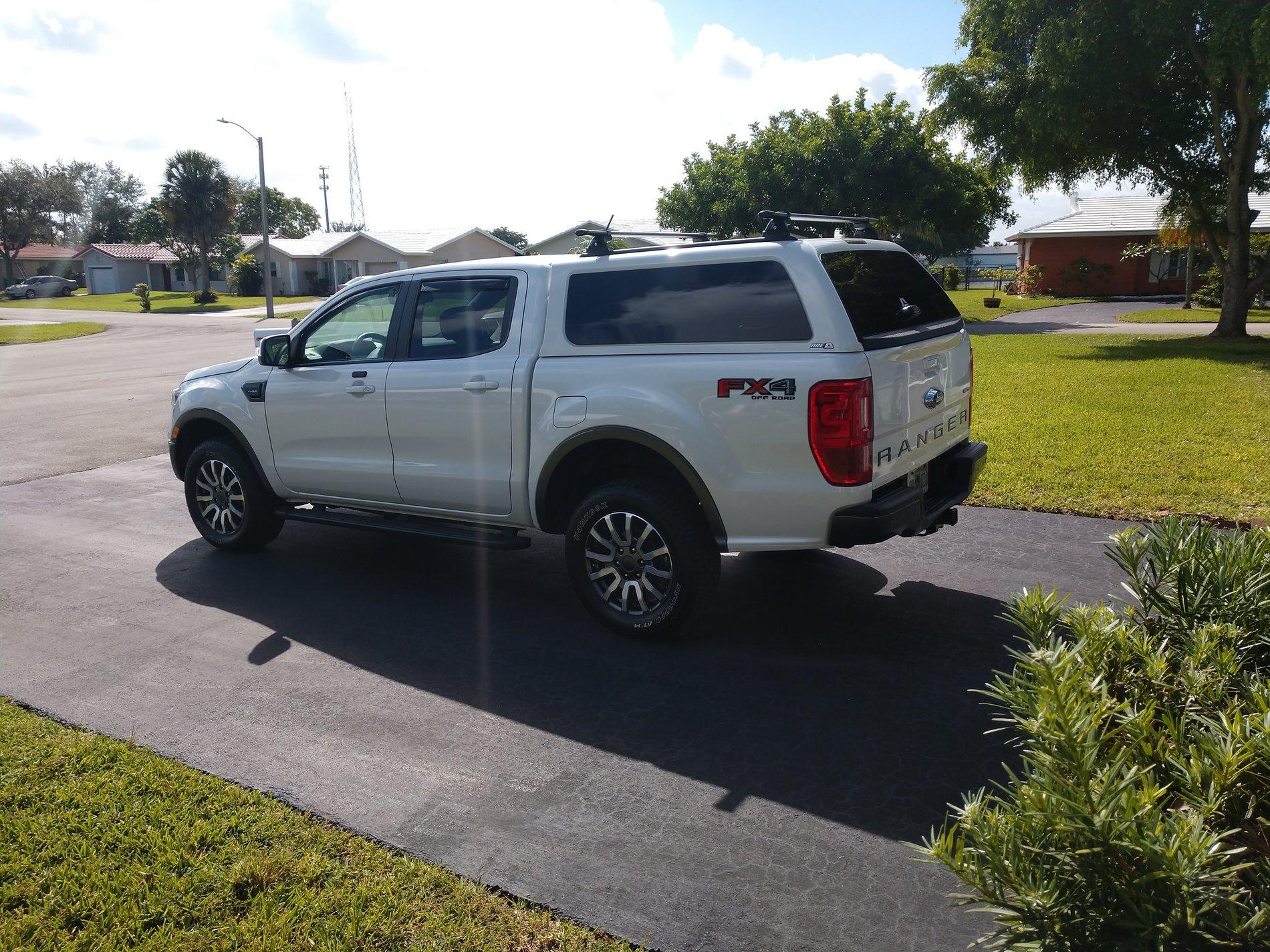

The pictures don't show it well but I have a Yakima rack on the topper to secure lumber and larger items. I'm looking for the same rack to put on the cab to extend the length of the rooftop storage of materials to be secured, ie. Plywood, 2x and 4x lumber and such.
Still a work in progress trying to make this smaller truck (inside the cab as well as the bed) as functional as my F150 Supercrew with a 6 1/2' bed. I know it'll never be the same but I'm going to continue to try.

If you're asking about the Pivot Box mounting bracket whe mounted it is about an inch above the bed so the bed rug fits underneath it and the box swings freely above the rug. I installed over the rubber bed mat which is similar in height to the bed rug and no clearance issues.

I think he's talking about the bedrugs with the sides as well. I'm like you, my bed rug is on the floor only.

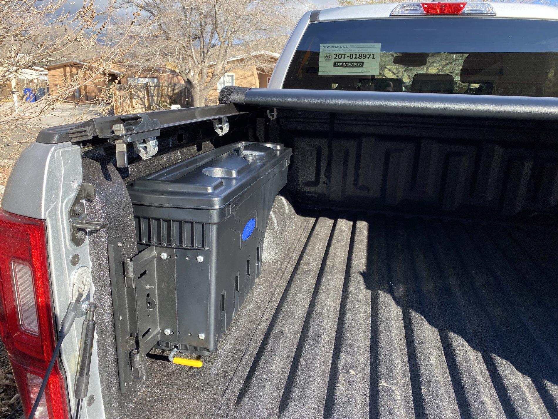

Does anyone know what the 4 slide in notches on the bottom exterior of the cases are for? Do they have any use or is it just for looks?

I would guess that they are for 2x6 wood to create enclosed areas. You'd need two swing cases for that to work.
That's my guess.
