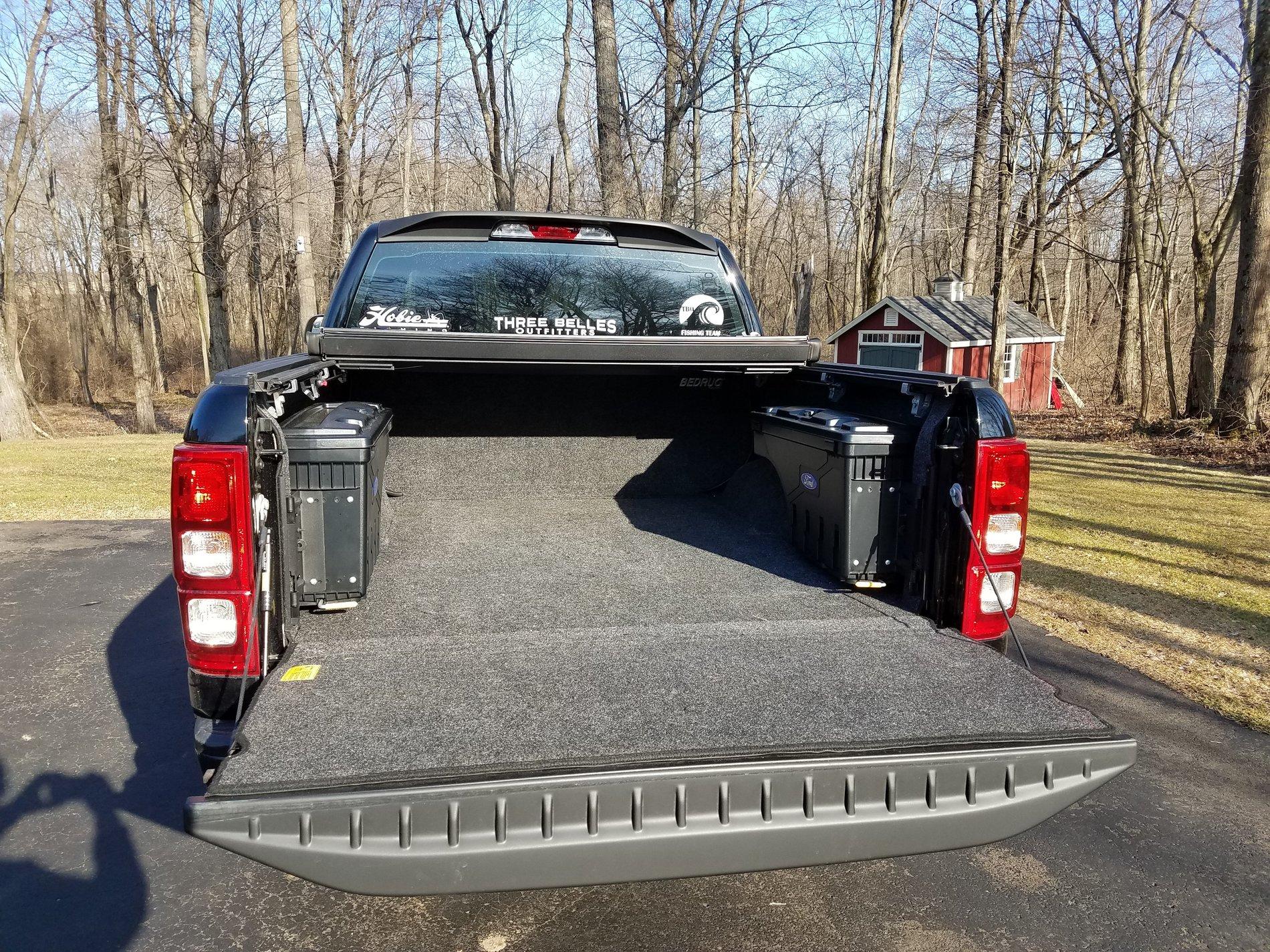

Installed tonight I moved all my tie downs over the bed rug as well, no issues installing over the carpet. didn't want to cut the bed rug more than i had to.

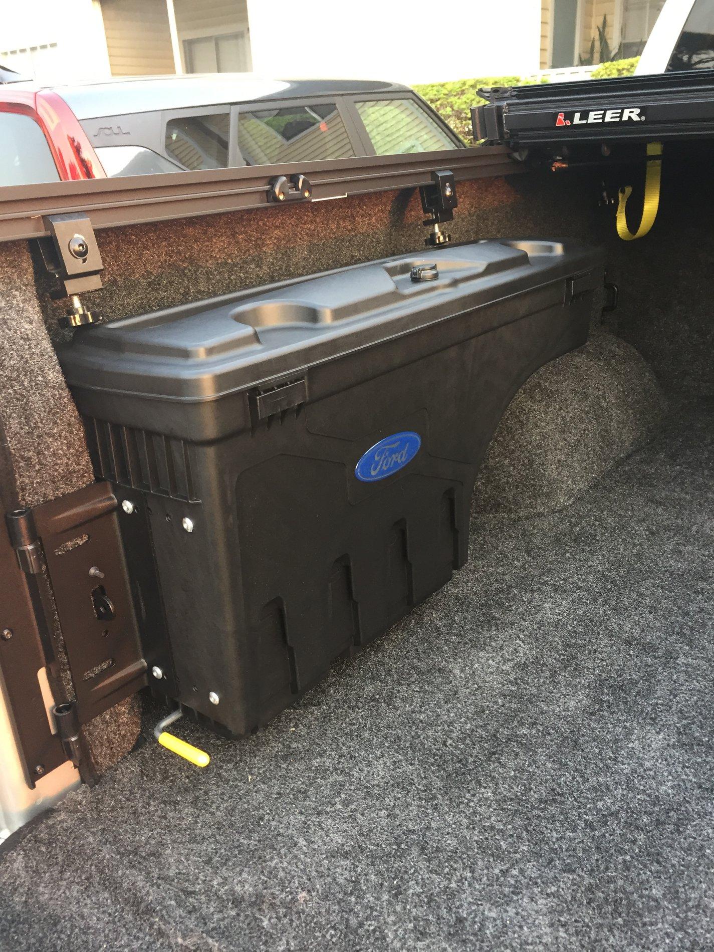

Just installed mine...driver's side.

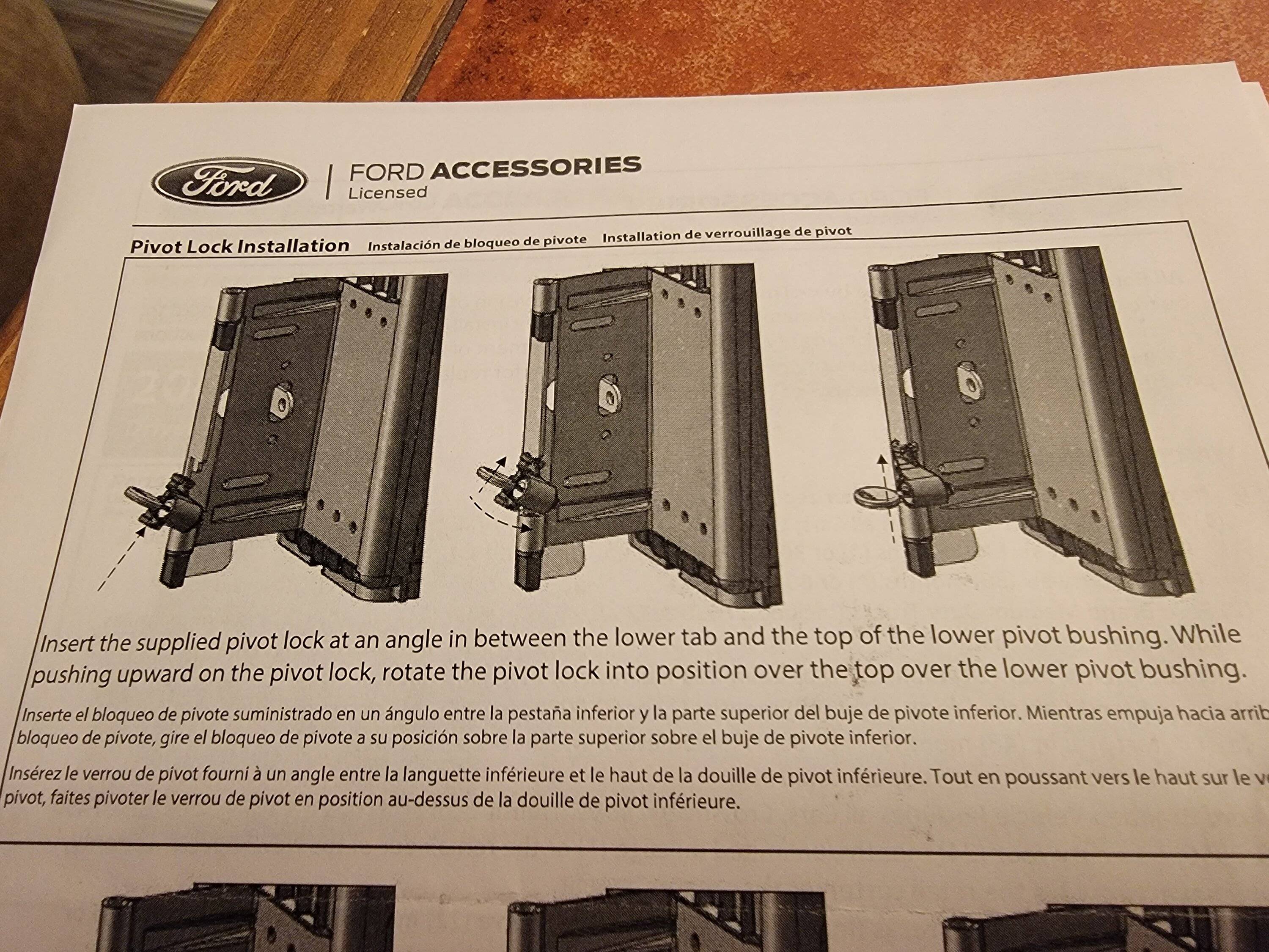

Instructions say there's a pivot lock that latches on the bottom swing post that keeps the box from being lifted off the posts but there was no lock like that included in my kit.
Did any of you have such a lock in your kit?

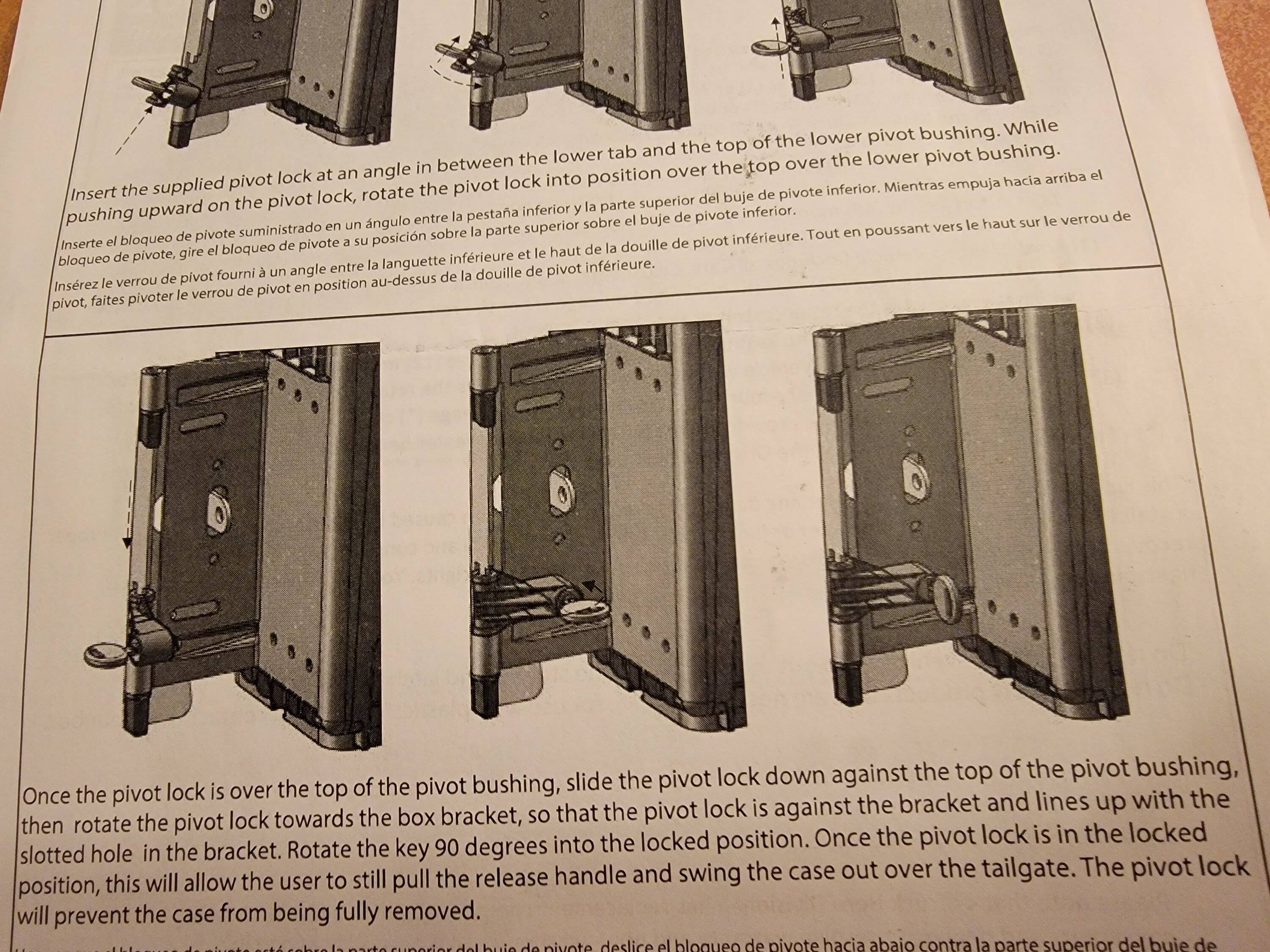

I'm gonna have to buy a padlock for the bracket for sure, but the directions say there's a lock that attaches to the pivot post itself.
That's what I was hoping someone had experience with.
Pic of instructions to follow
