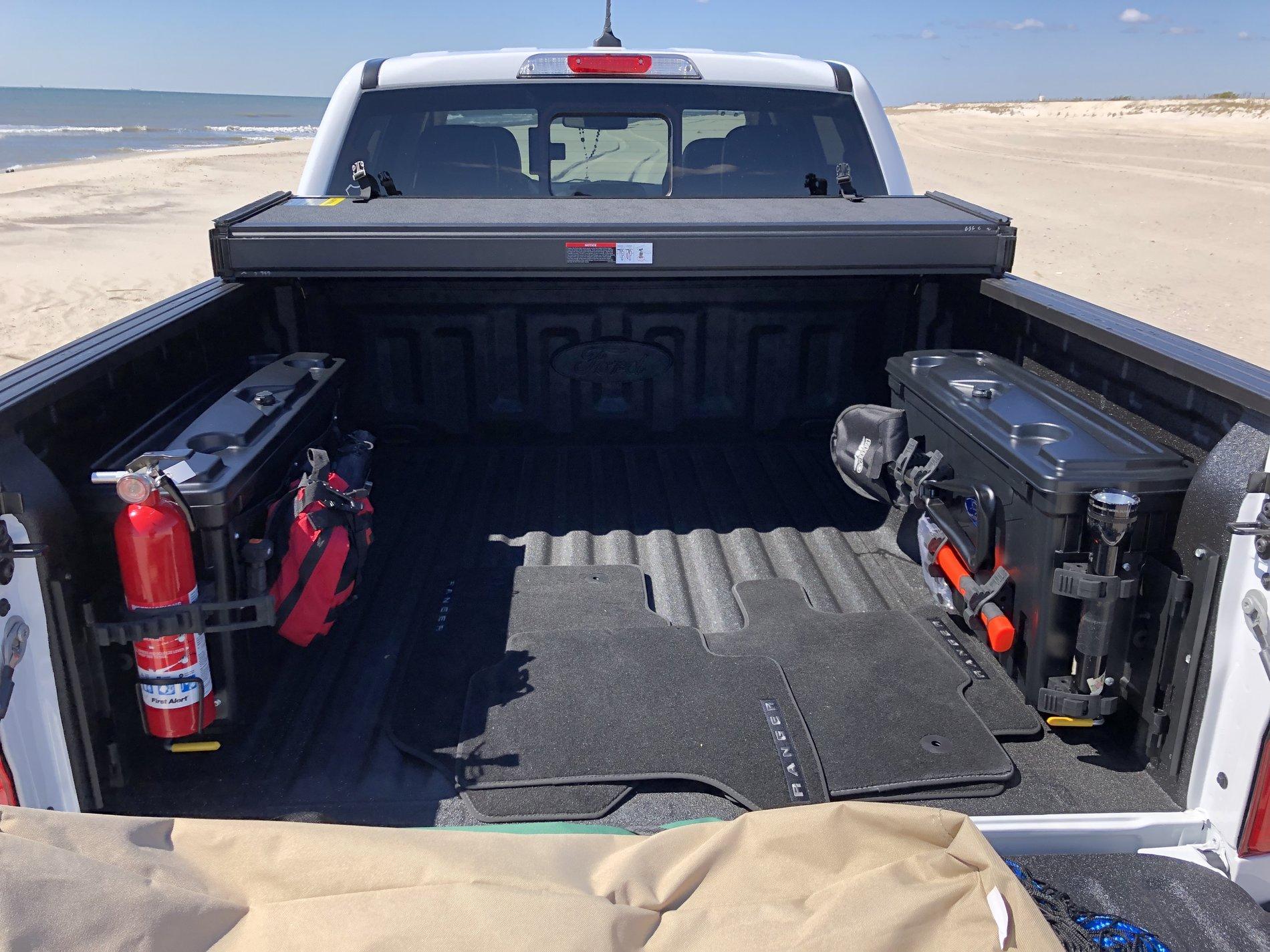

Not really a build thread, but thought I share this idea ( to anyone interested).
The Oem swing out tool boxes are great, but not alot of space inside for all the other stuff( shovel, axe, first aid kit, etc).
I used QuickFist clamps, assorted metric nuts and screws and a power drill.
For the fire extinguisher, I used a bike aluminum drink bottle holder and large QF clamp on top(trimmed to fit).
The Molle panel has metal grommets on the backside making it easy to secure with screws.
Anyway, anyone with basic DIY skils can do something similar to this if they want to. :wink:

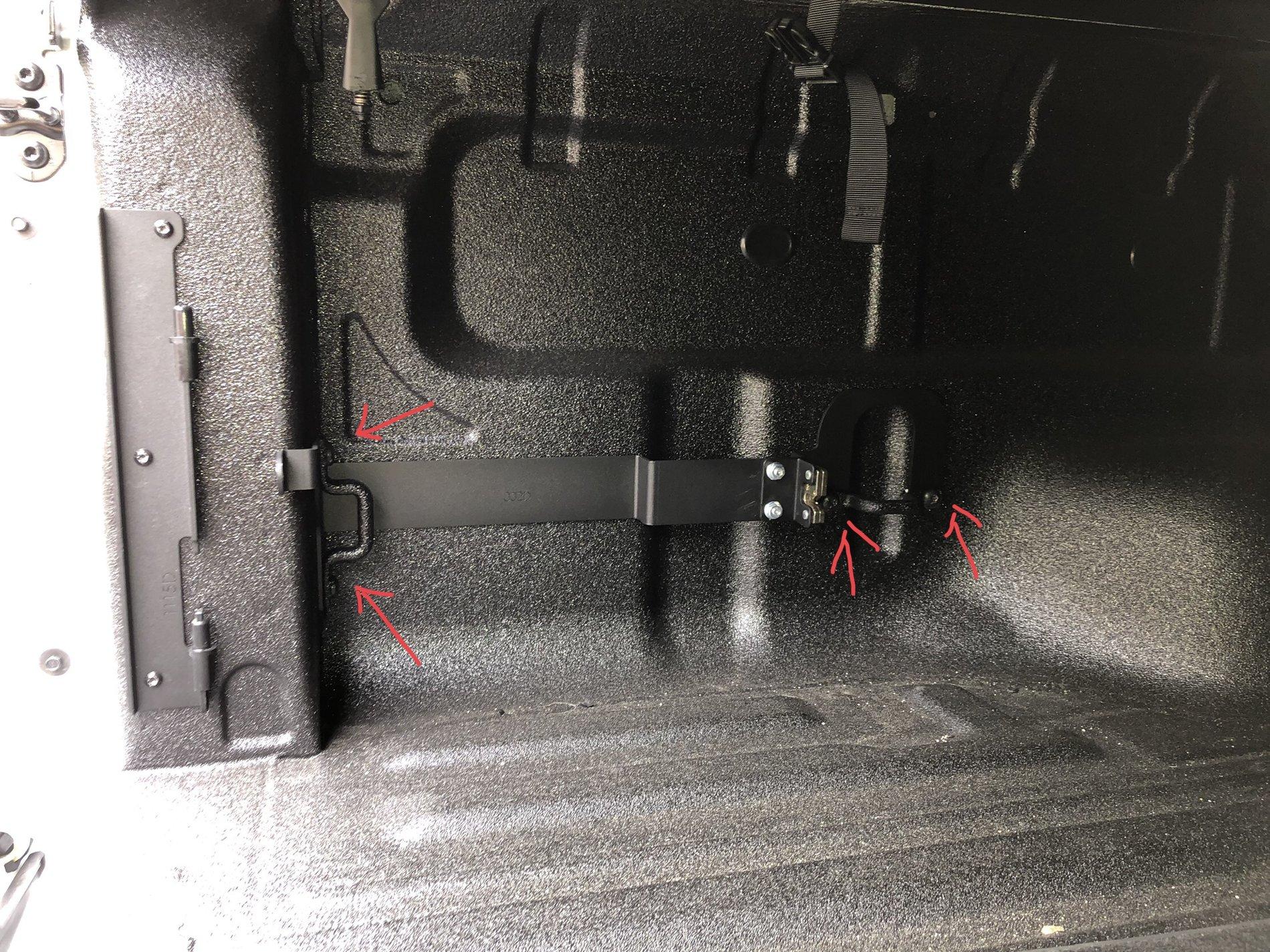

For those with factory spray in bed liner, This pic shows the 2 oem bed tie downs with the 4 torx screws that you have to re-use to install the large tool box bracket. Use snips or small knife to expose or scrape just enough bed liner material off, til you clear the screw head. Do this for both sides of the bed.
