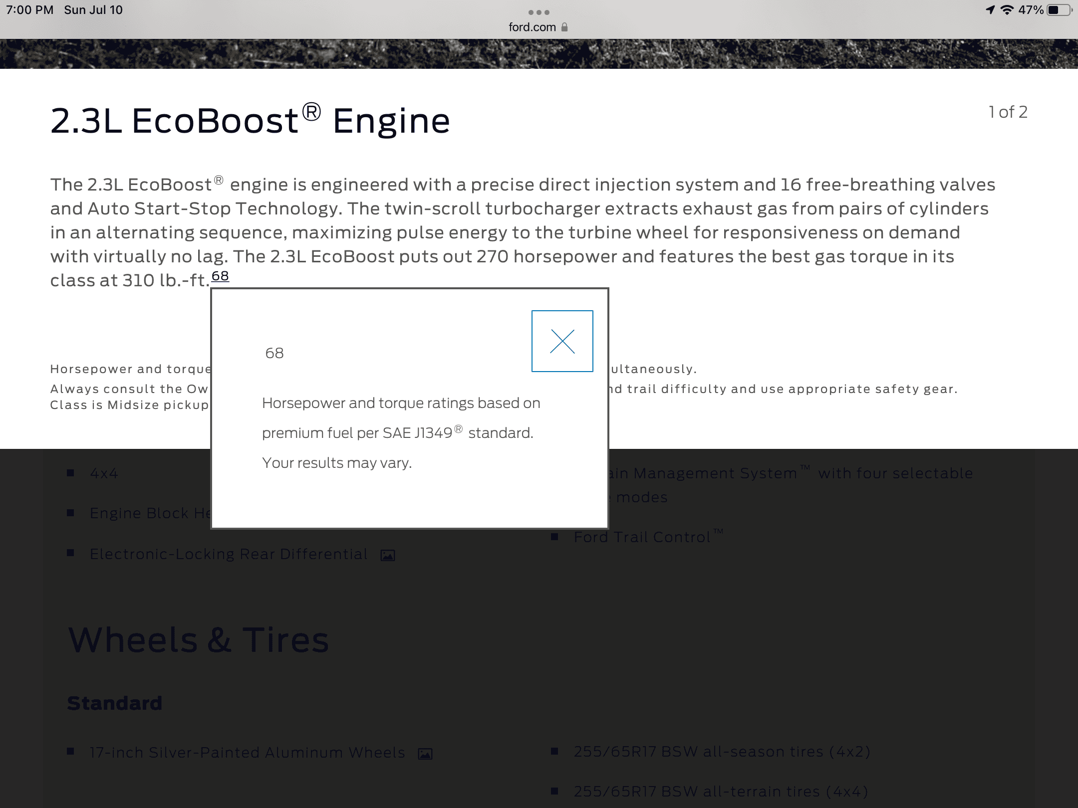

From the Ford website, the 270/310 is with premium fuel.
I would say that is a mistake by the marketing folks that put the web page together. There are a lot of inconsistencies and contradictions on the Ford web site.
The evidence is pretty overwhelming that the power rating of the Ranger Ecoboost is based on 87 octane.

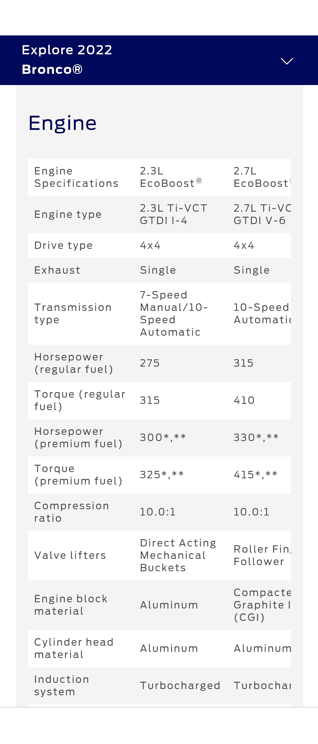

3. The Bronco web page lists the power on 87 octane at 275 and 315 on 93 octane which supports the tech articles and Dyno tests.

The Bronco actually publishes power figures with 87 vs 93, I'd expect our engines to be similar.

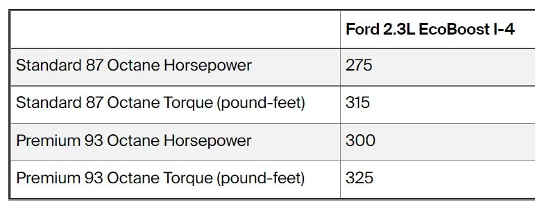

Keep in mind that the 270 HP rating Ford advertises for the Ranger is using 87 Octane. The 310/330 Ford advertises for the Mustang is with 93 Octane. Also, Ford advertises the HP rating on the 2.3 Ecoboost in the Bronco as 275 HP on 87 Octane and 315 HP on 93 Octane. It would be nice if they did the same for the Ranger.
So if you run your Ranger on 93 octane you will get around 300 HP. There are a number of threads on this forum that discuss this topic.
