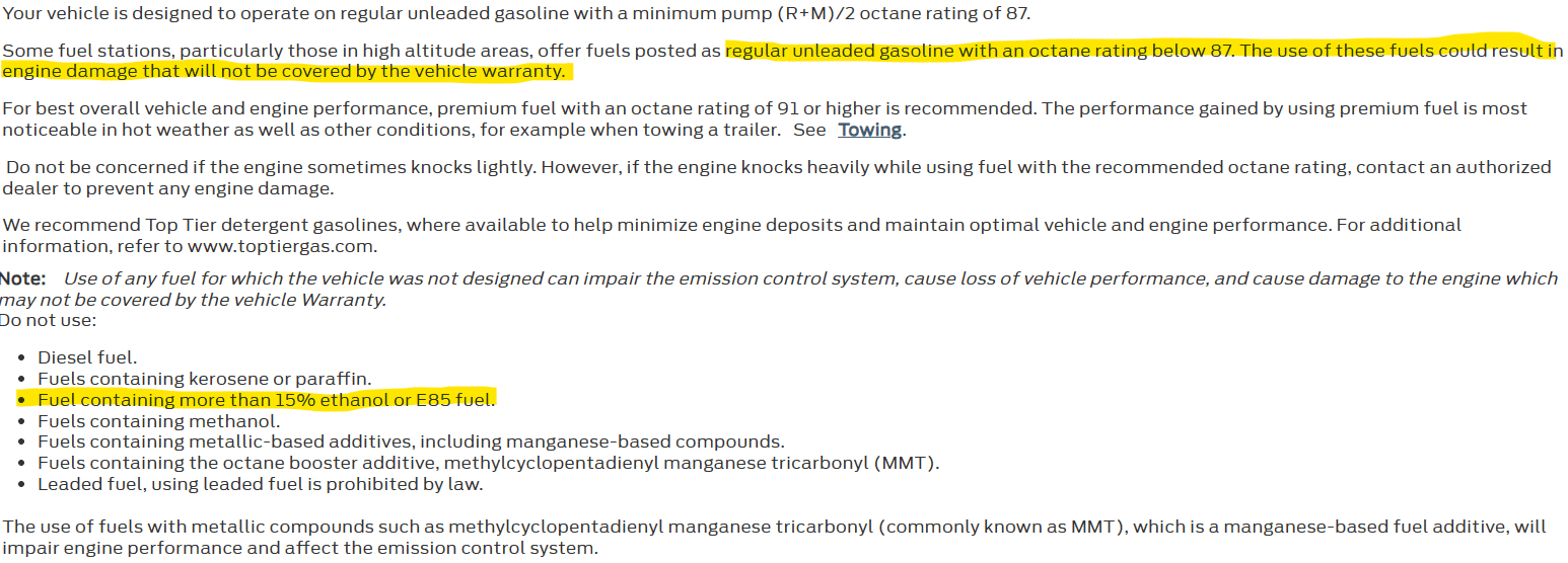

The Ranger Owner's Manual says it's ok, but not to use E85 (85% alcohol) also called Flex Fuel:
