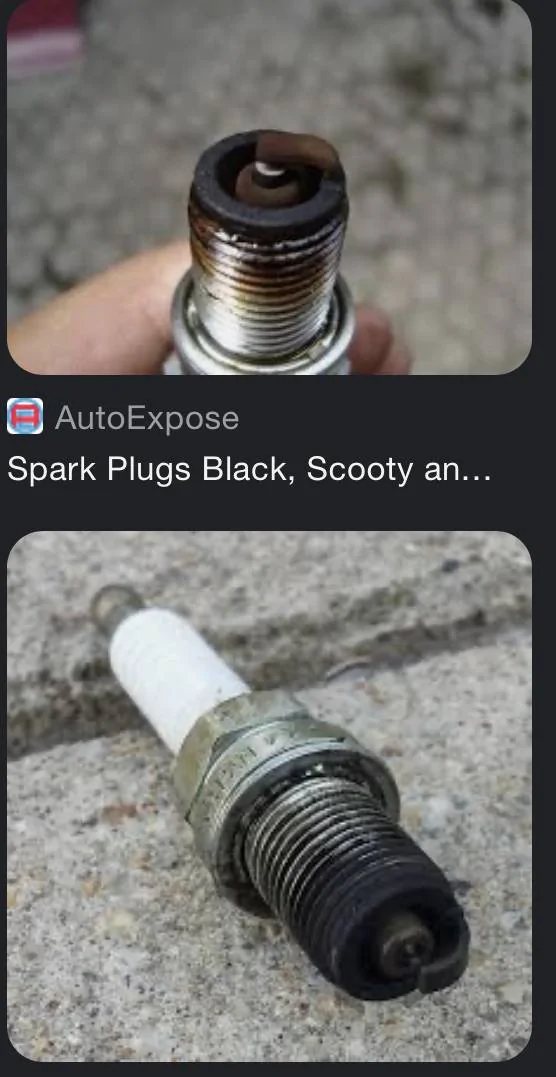

Pictures of old plugs?
Didn’t take pics. Old plugs are in my cans, but I’ve missed garbage day 2 weeks in a row not so I am not about to try digging. They looked like somewhere between these 2 pics.
Somewhere in between those two would tell me it is either running rich or you use the go pedal to its full advantage a lot or you drive a lot of shorter trips.
