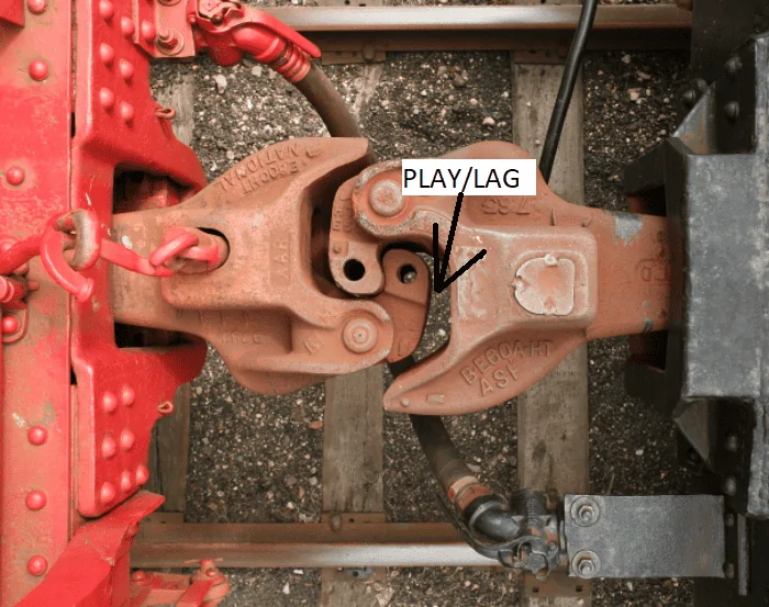

There is a noticeable difference in pedal response in all of them with the throttle controllers. The most noticeable of all is on the mustang as the power is immediate. the other two are both turbo and you cant get rid of that turbo lag from a stand still. the Mustang is almost undriveable from a stop in the top settings due to the power coming on too quickly.
Here is an analogy I came up with. You have a train engine pulling a train car behind it. The cars are held together by a Railroad coupling. there is some play in that Railroad coupling where, when the engine starts moving but the car behind it doesn't move right away because of the play in the coupling. If you tune your engine it will not take the play away. The train with more power may move faster but there is still play in the coupling. A throttle controller removes that lag and. at the same time, also lets you push only part way to get as much power as pushing you foot to the floor, depending on the setting you have it at (as many of you have already commented). Not perfect analogy but you get the idea.
The other thing these devices also do is have decreased throttle response for a better economy mode or for doing things like backing up trailers or going up/down off-road inclines where you need to control your speed better.

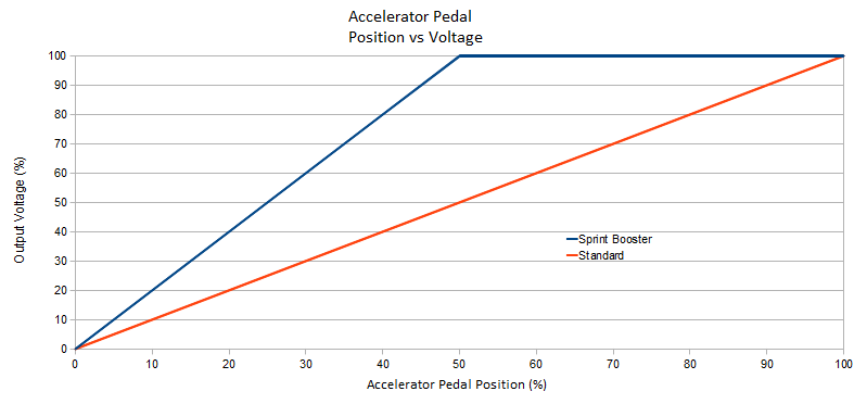

Yeah I'm sorry, I typically stay out of these pedal tuner discussions, but that isn't even closely analogous to what these pedal tuners do. There is no "lag" between your throttle pedal and your ECU beyond that that naturally occurs to the speed of electron flow through the components. The only way possible for these devices to increase the speed at which the ECU responds to your pedal inputs would be to literally accelerate electron flow.
All these pedal tuners do is give you more(or less) output for similar inputs. THAT IS IT! The exact same effect can be achieved by remapping the driver demand tables in the tune, minus the on the fly variability.
Sprint booster is the originator of this technology and someone graciously wrote a white paper on how they operate 14 years ago. They all have the same principle operation. I know people love these devices and the effect is powerful, but the whole "removes lag" aspect is patently false.
https://www.evilution.co.uk/files/info/sprintbooster/sprintbooster.pdf
https://outbackjoe.com/macho-divertissement/macho-articles/sprint-booster-is-it-worth-it/

I was certainly not talking about the technical working of how these work. The "lag" or throttle delay is a perceived feeling I have (and I am sure others) when I push on the gas. The device removes this. Sorry if you don't agree with my analogy. It was meant to be a simple comparison which I believe gets my point across.
I think that’s exactly correct, but that is all most people want or need. That’s why they are so popular.
