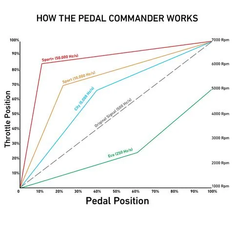

I did not read through the replies but all this does is remap how far open the throttle body opens vs pedal position. It does nothing more than you can do by pushing your foot down farther. I don’t understand how this thing sells? Oh the good old day with cables when 1/2 throttle was 1/2 throttle not 3/4.

This has been standard on the Toyota Prius since 2010. ECO, Standard, and Power settings. All are the same at WOT, but the mapping is different at lower speeds.

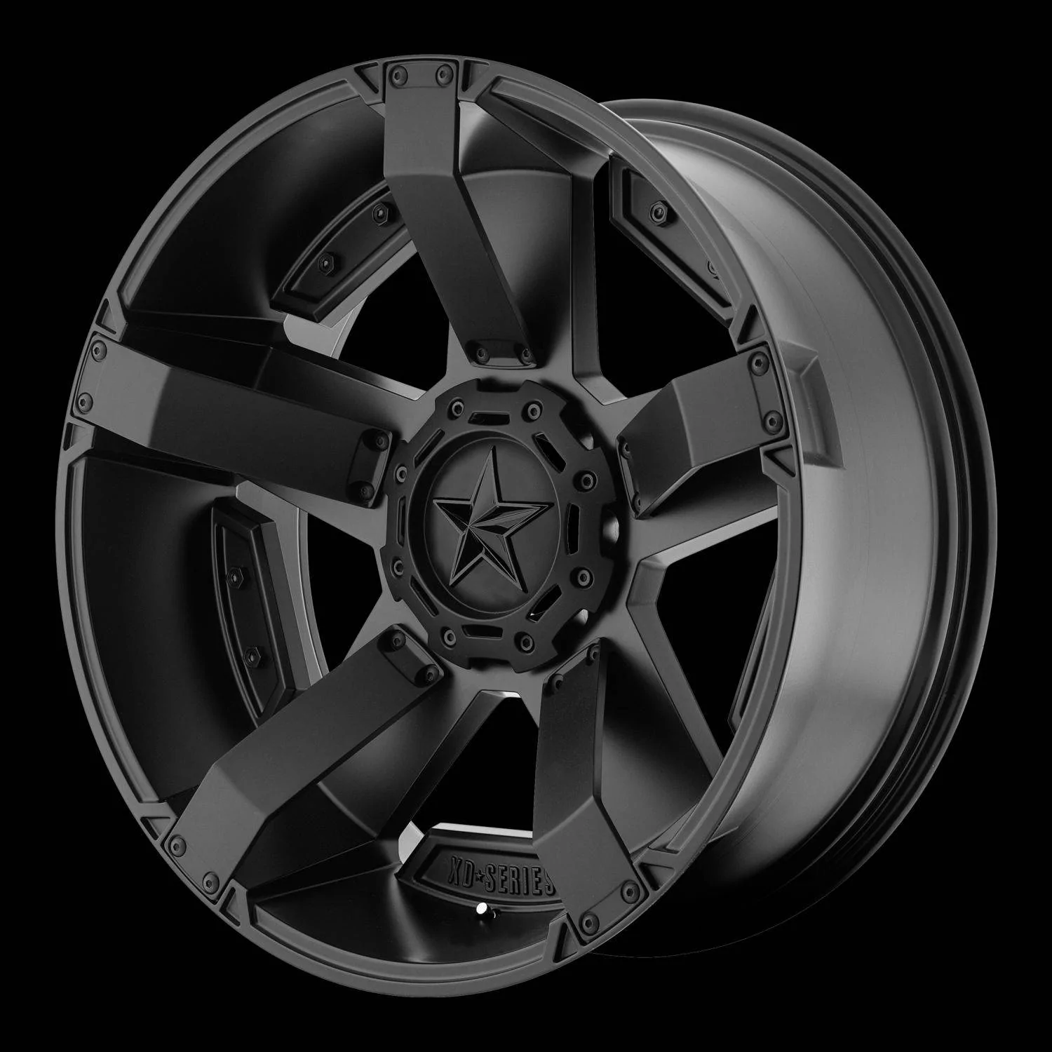

Update...
Instead of the pedal commander I've decided to FINALLY put some nice wheels on my Ranger. I've got her looking pretty good but those stock wheels have always bugged the heck out of me. I'm going with the XD 811 Rockstar II's....
That's going to set me back a few bucks so the PC will have to wait for now. ;)
137,226
Update...
Nice looking new wheels Mark and a better choice to get these before the PC. :like: Post some pictures once they're installed.
Thanks Dave! I ordered them last night through Discount Tire....they go on Monday afternoon. Pictures to come. I'm still not convinced on the pedal commander. I think I'll give Anthony at Livernois a call and get his take. I know they sell a Ford/Mercury "throttle enhancer" for $300. I'm thinking that would be the equivalent of the pedal commander.

Incorrect. Obviously you do not own one. Those of us that do know what it does. If pushing my foot down to the floor returned the same results then don't you think those that actually purchased and used them would post things like "I just bought this pedal commander. Recommend not to buy as I get the same thing if I just punch the gas"?

But, that is exactly what it does according to their own literature. Don't need to own one to understand how the pedal position circuit works on a torque based driver demand ECU. The only thing your ECU is looking for from your pedal is position, therefore the only possible thing these devices can do is manipulate the position data. This is what they do, feed your ECU an exaggerated(or low in eco modes) pedal position voltage which makes your ECU perceive your pedal is pressed down further than it actually is. As was stated, the exact same thing can be accomplished by pushing your pedal down further.

How Does Pedal Commander Work and Why Do You Need One?
You must have noticed that when you step on the gas pedal with the intention to overtake a slow-moving car or just beat the guy next you, there is some lag between your foot mashing the skinny pedal and your engine reacting. This is because the digital signal from the pedal first goes to the engine control unit, which eventually transmits it to the motor for action.
The Pedal Commander is designed to reduce the delay in the signal between throttle and engine. It basically speeds up the signal thus eliminating the delay. Not only that, but the Pedal Commander offers 30+ individual settings allowing you to fine tune the the sensitivity of your gas pedal to your exact desire. There's even an Eco mode designed to help slow the pedal to save increase fuel economy. Or turn it up to the Sport or Sport+ modes and get near instant response!
Install takes minutes and can easily be removed. It does not reprogram the vehicles ECU so there aren’t any footprints for the dealer to see. It does not add any horsepower or torque. While it feels like you’re gaining power, it’s actually just removing the throttle delay and causing the vehicle to react faster. These are now Bluetooth enabled allowing you to adjust settings on your phone in addition to the unit itself.
