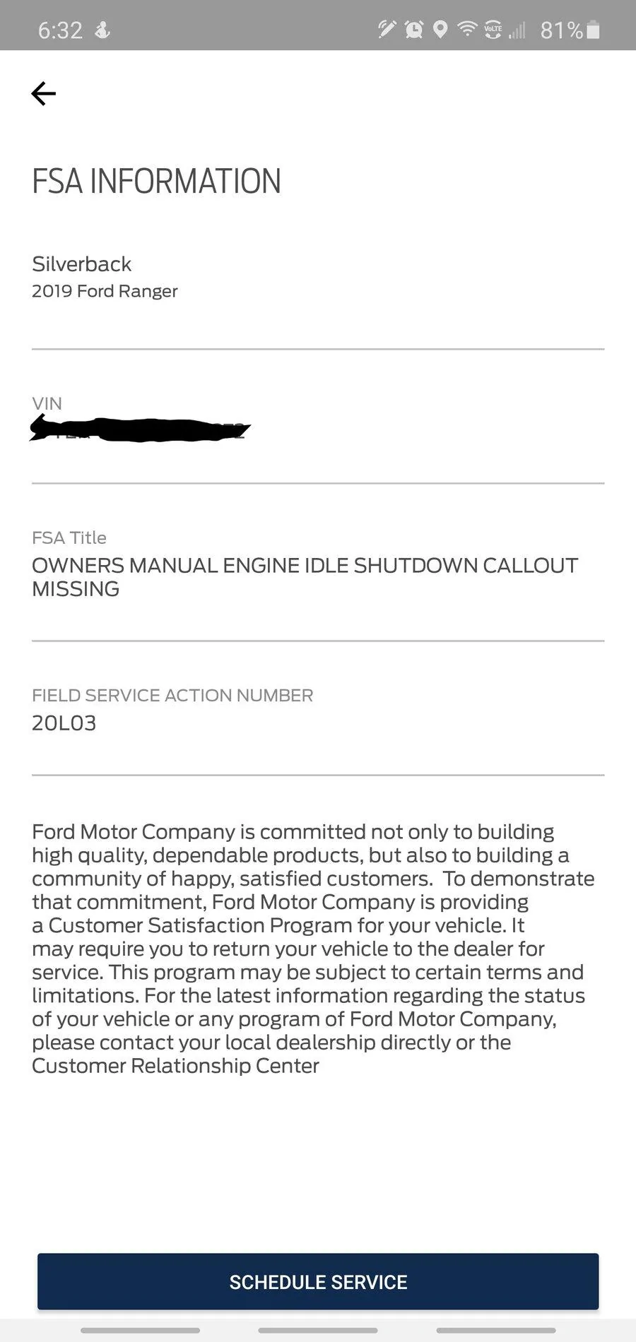

I opened up Fordpass today and its telling me there's a new recall. I've tried googling this but I have no idea what it means? Anyone else get this?
[Field Service Action number 20L03]

Field Service Action Number 20L03:
I had the same question. Called Ford customer service and no help. Called 2 different dealers and here is the status: This is not a recall nor a notice for service to be performed nor anything that needs to be done on the vehicle. It is a physical insert to be placed in your owners manual and relates to additional information about the Auto Stop/Start feature. Ford will mail this insert to Ranger owners. "keep on truckin."
Hi Paul,
I called Ford Customer Service and they said no more mailings. Gotta go to the Dealer. So I called my POS local dealer and got a fellow that knew the drill....I stopped by today and he handed me a computer printer printed page to insert in the manual and then took the FSN off my vin....What a crock!
We did this dealer visit on the way to Home Depot as wife decided that we are changing kitchen faucets to update to the HGTV shows latest fashion is Black faucets for sink and Reverse Osmosis....Out about $500 and a plumbing job tomorrow...Seesh!

Okay so if no one's done this yet just go to your local dealership all they have to do is print out a piece of paper for the owner's manual hand it to you and they get paid 0.2 hr per vehicle on this. Not much but something.

Just went to the dealer and they installed the new page in my manual. MAN this truck runs great now! Easily added 10-15hp! It's no tailgate damper but wow!*
*This comment was written in the "sarcasm" font.
