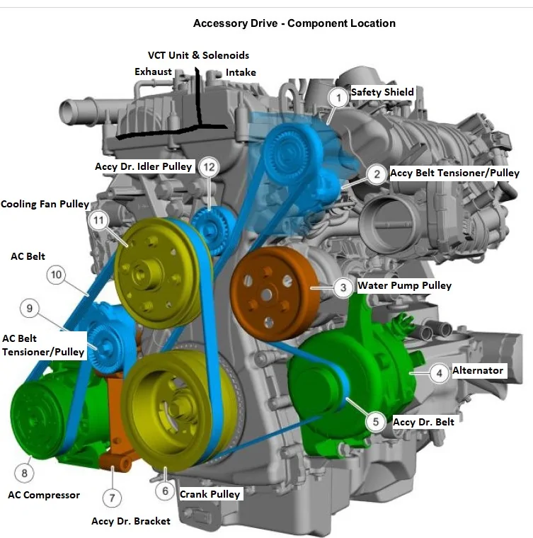

Normally the old school way was to find a (perfect sized) shorter belt and by-pass the AC Compressor - so it would be a trial & error situation.
So, the question is: can you get enough tension on a shorter belt bypassing the AC Compressor?
I won't say impossible -I just don't see it working due to the design and layout

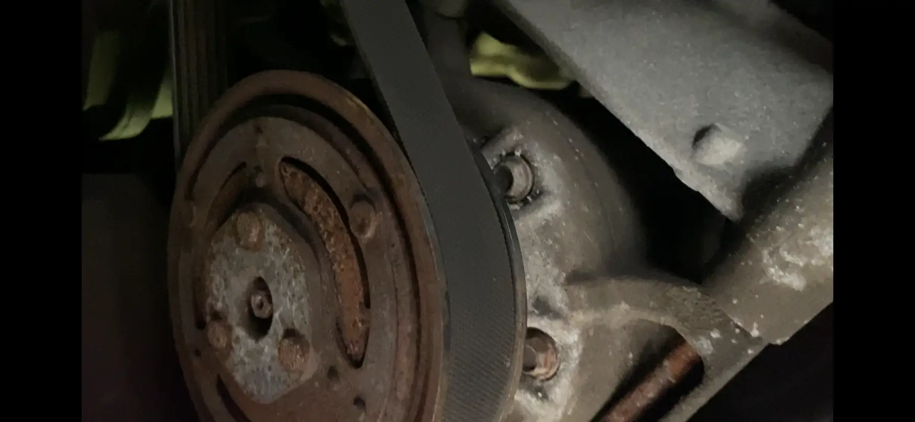

You may get lucky and only need the clutch, can you place your hand on front of the clutch and turn it - this will give some indication if the compressor is locked up.
Normally it's easier to replace the clutch on a bench but can be done (on truck) with the compressor unbolted.
I have replaced a few clutches, but normally just replace the unit.

Yup, I can spin the middle part of the pulley no problem.
According to FORscan I have 550kPa (80psi) of pressure so I'm not out of refrigerant unless the sensor is wrong.

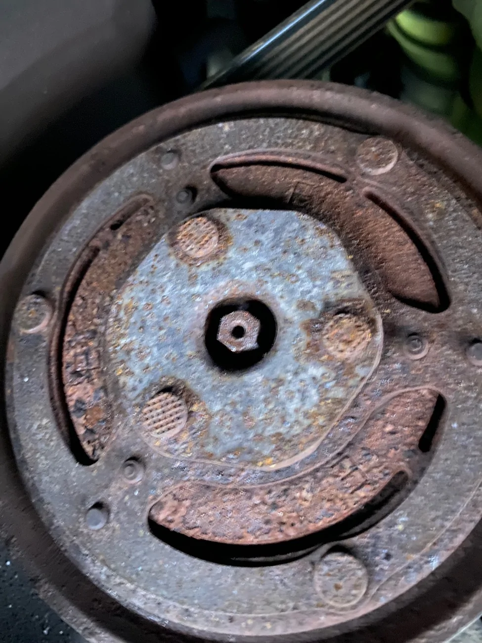

Does anyone have any suggestions on how to hold the clutch plate while I try and loosen the center bolt? Is that bolt LH threaded?
I can't see any places where a pin wrench/spanner or a pulley holder would work and I can't put a strap wrench around the pulley either.
I was planning to run through a PCM key-on self test and unbolt it when it activates the clutch, but turns out there must be some other problem because the clutch doesn't activate when I do the self-test.

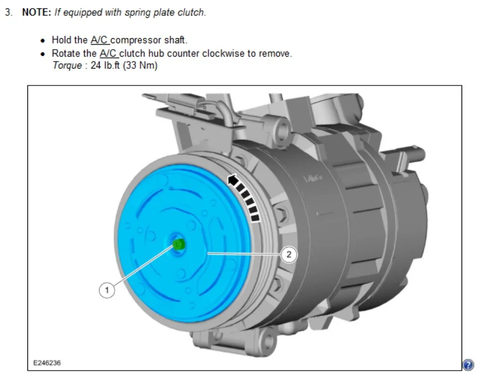

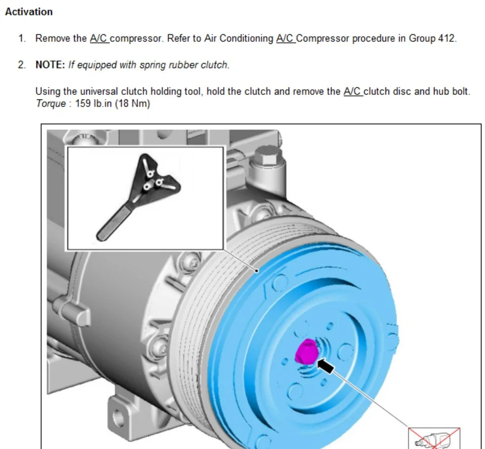

There is a tool to hold it if equipped with a spring rubber clutch.
If equipped with a spring plate clutch:
Thanks for that page. I've downloaded the free service manual that I found on the forum, but I don't think I have that page. Or if I do it's hidden quite well.
I've got the spring clutch plate. Any ideas on how to rotate the plate while holding the bolt? I think 24 ft/lbs is a bit more than what I can generate using just my hands/fingers.
Maybe a strap wrench?

I don't think so. It doesn't protrude a whole lot from the pulley face, and if I put it around the pulley, the pulley will just spin.
Looks like another special tool is needed.
What section number in the service manual is this in?
And yeah, I'll have to figure something out for holding that clutch plate.
Section 412-00 Climate Control System - General Information 2019 Ranger
General Procedures
