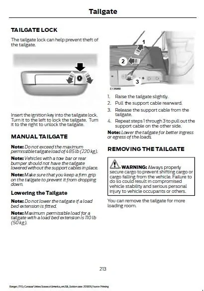

Wow.. you sure jumped off the deep end there Ryan.
The tailgate is only designed to hold 485 lbs. What makes you think your cables can't handle 243 lbs each? I'd bet each one can handle 1,000 lbs.
