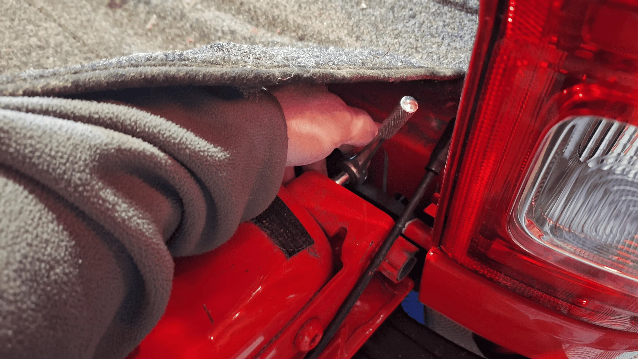

You can semi-permanently do this with a McGard anti-theft lock. It would be some work to remove your tailgate with awkward reaching and angles with a ratchet. But It won't lift out with it on.
My install: https://www.ranger5g.com/forum/thre...-your-ranger-today.3511/page-1381#post-625657
You may be able to achieve the same with a hose clamp.
