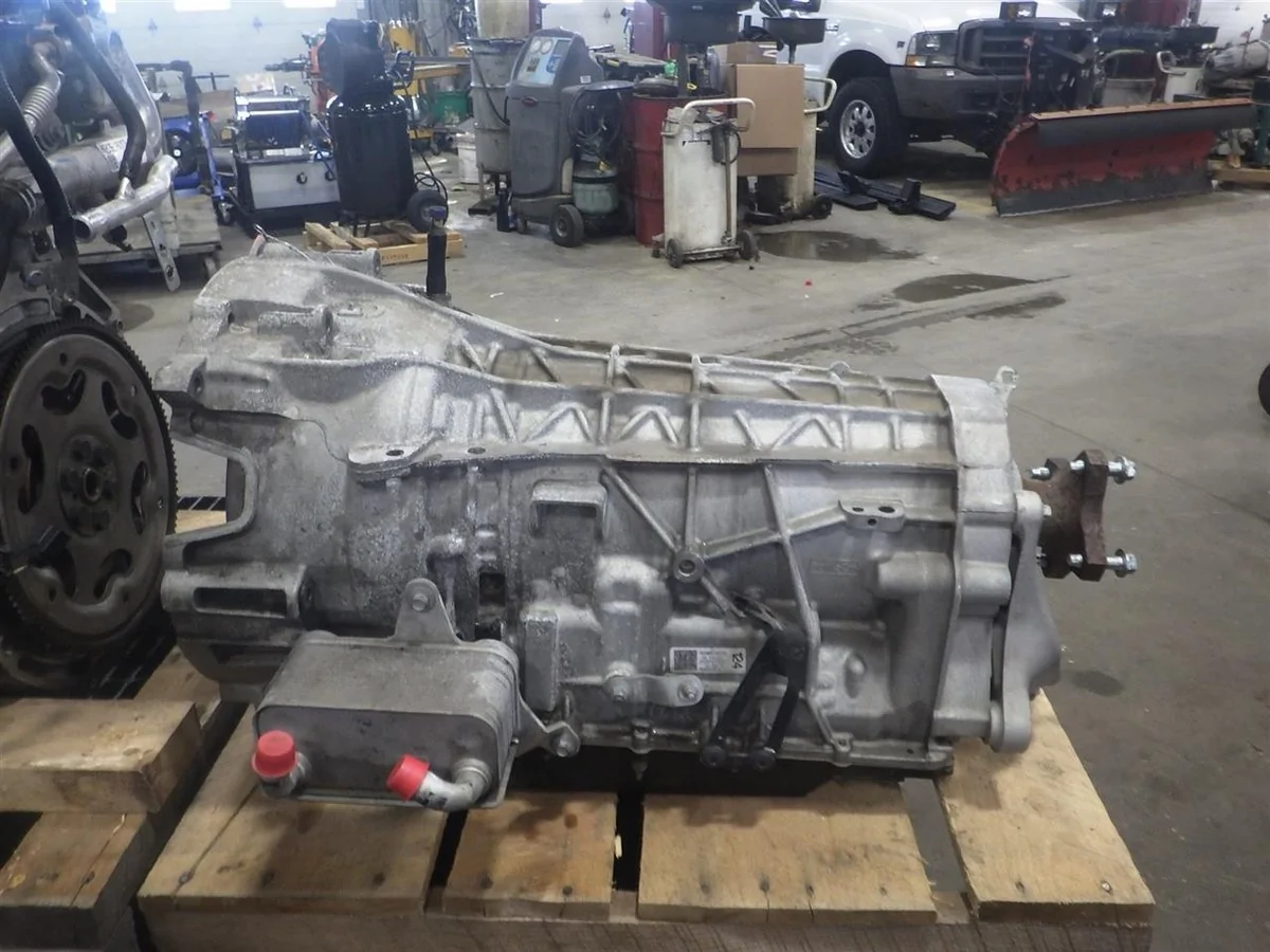

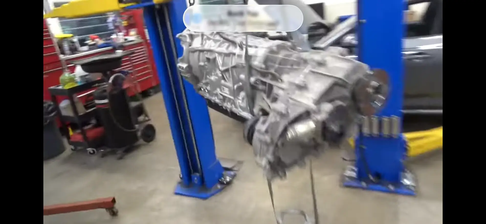

Will the Tom Woods Driveshaft fit o a 4x2?
Stevedbvik1
Oct 4, 2021
2,820
8,541
2022 Ranger Tremor XLT
The 4x2 driveshaft is longer than the 4x4 one that TW offers. The length difference is because of the transfer case attached to the rear of the 4x4 transmission. It appears to be at least 10” longer. You would have to contact them and give them measurements of your driveshaft to see if they would build one for you.
