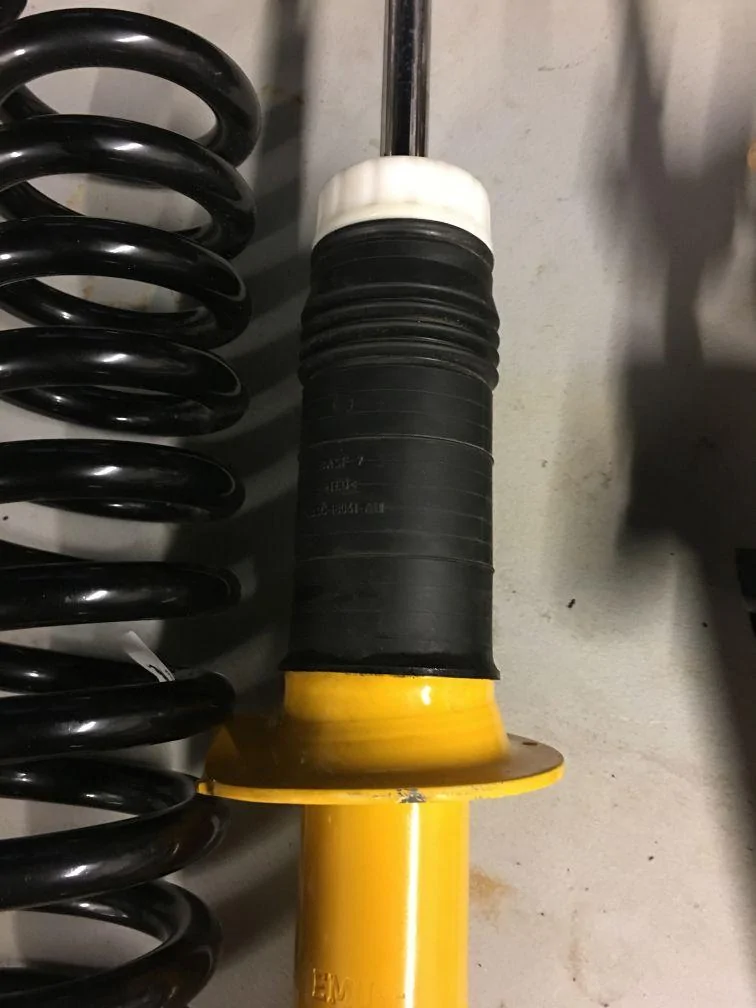

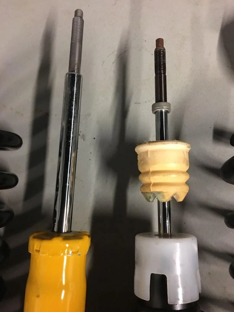

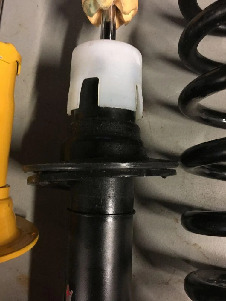

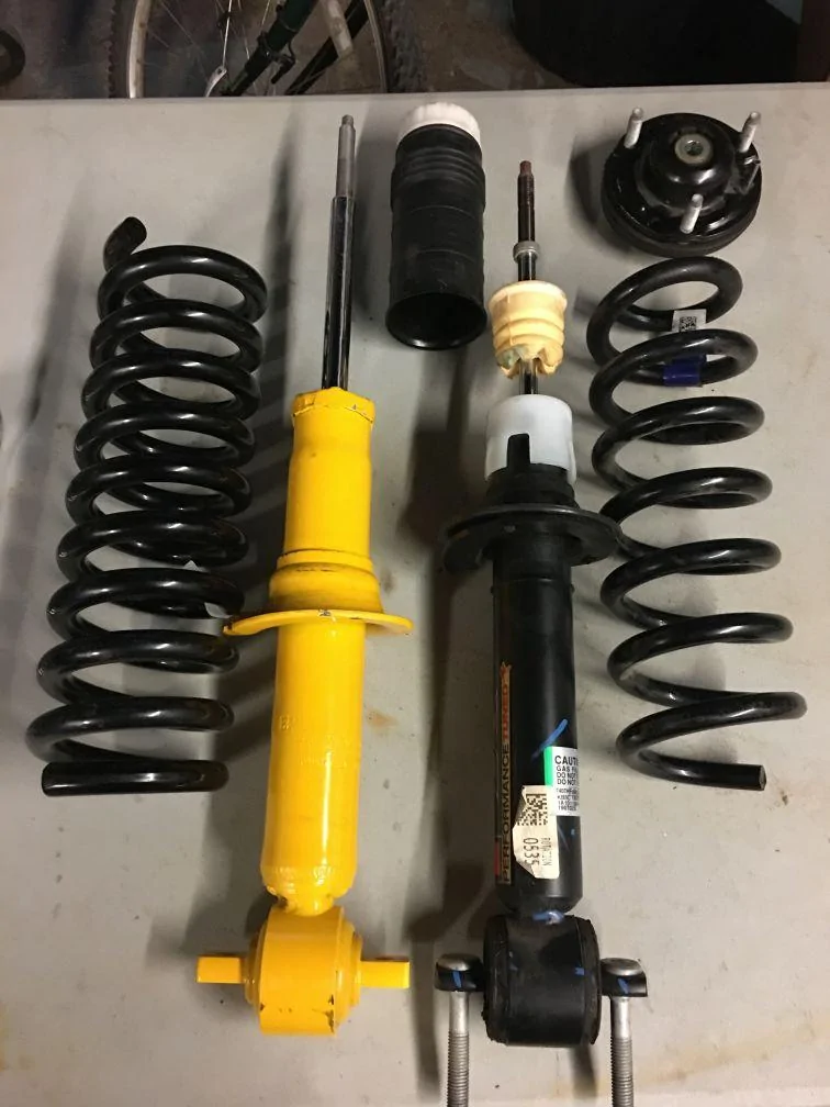

I've trying to figure out how this thing goes together. I'm not sure the bump stop can be reused. the shaft is a different diameter. Not sure how you remove it from the old shock either. It has that ring holding it on. Did you reuse the lower spring isolator? It has some rubber extrusions that are keyed into holes on the OEM shock. There aren't any corresponding holes on the OME. I guess you could cut them off and just lay it on there but I would be worried it might slip and wear. The dust boot does fit on there no problem. maybe a little short.

You will want to use all the factory hardware. Just pull the bumpstop off. It will clip into the white plastic hat on assembly and the black dust shield goes over top and into the groove.
The white bumpstop strut cap probably wont fit, but the ome strut looks like it has one built in already. I would use the rubber isolator if you can get a retention hole to line up, but I would need to see more pictures to how it sits and fits.
Did the kit come with new lower bolts or studs ? They can be difficult to press out.

I already talked to him over the phone on what to do since I have installed this kit on my truck a few months back. The bump stop and dust cover swap over and there are new bolts for the lower mounts. The only thing that doesn't swap over is the plastic insulator
