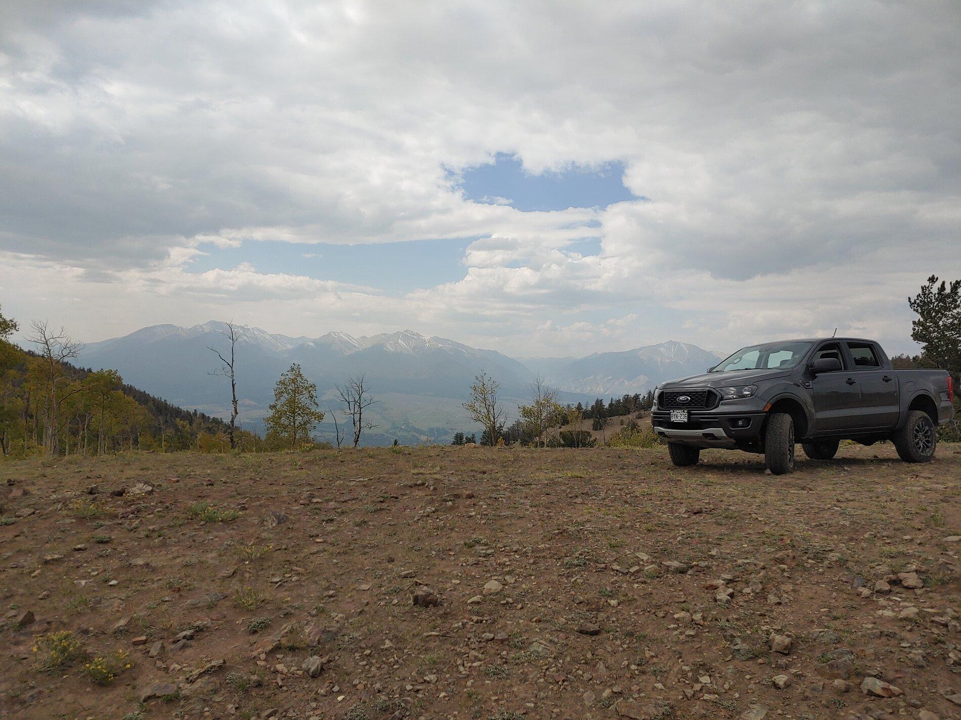

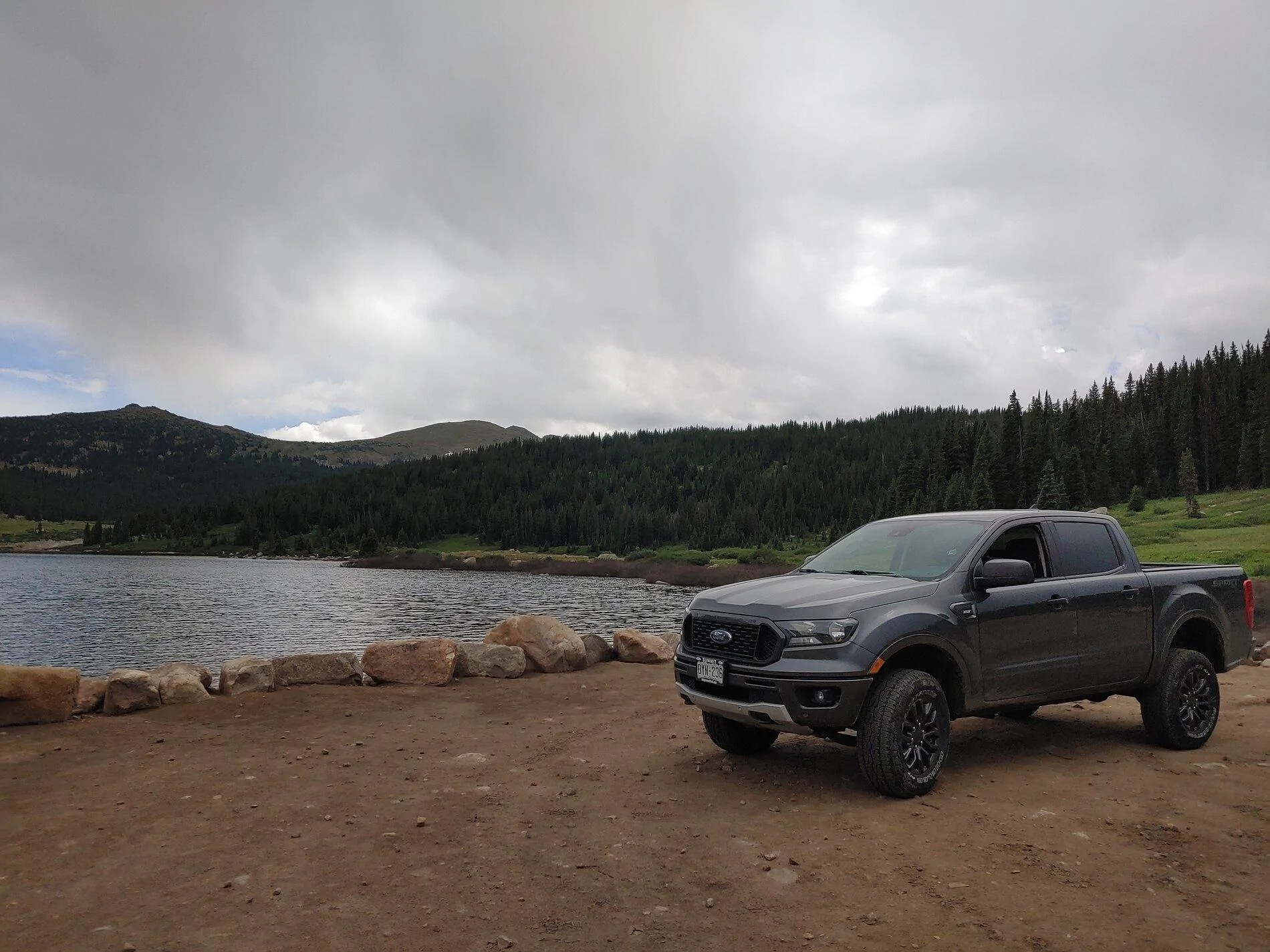

Hello there miles.
Let me clear up some of the questions for you. I myself have just the standard old man emu lift kit and the only things that really upgraded was the right height and ride quality. Because it is the standard lift kit and not the heavy duty lift kit load capacity is still considered the same for payload and Towing.
Now I live out in Colorado and there are some roads that are pretty rough. I can't compare them to Canada right us if they haven't been in the parts you have been in but during the Michigan it's not really that bad.
Comparing with the stock suspension to the old man emu I can say I was really impressed overall. Some people like to say that the suspension is now a firm but in my opinion old man emu isn't really firm but comfortable. You have way more travel in both the front and the rear. The front gives you an extra 2.4 in of travel and the rear gives you an extra 1.4 in of travel. Because of this the Springs are able to be a little softer in a way. Also the shocks old man emu makes have very nice compression and rebound settings. The settings are so nice that you do get a very good comfortable ride.
Have I been off road with this truck as well? Absolutely I have I'm actually doing a little bit off-roading today as we speak I just have to find a little stopping point where I can give you some more information. I have hit the light trails that you're talking about hitting and comparing to stock you will get a nice smooth ride.
With Towing I can't say the comparison between stock to lifted with the old man emu because I have never told anything with this truck when it was stuck but Towing so far is pretty well even with the lift kit. I recently towed up to 5500 lb with a U-Haul Auto Transport in my old 1983 280ZX and I can tell you the truck did very well at handling it. It didn't give me any issues whatsoever on the power and the handling and comfort. Yes I did notice it was there but not to the point that I was really bothered.
Here are some pictures of the truck with lift and with my load that I was towing.

You sure did. Grew up in Colorado high near alpine so I know the terrain well and it’s quite similar to what we have here.
Nice looking truck! Looks like a few inches on front and a bit in back? Still has some rake to it, which prob makes sense to keep for towing.
Did your kit does have new leafs in back or just the shocks?
Did you put it in yourself? I can sort of imagine doing the front but the back would give me pause, especially considering the leafs are loaded springs.
Iā€˜m thinking about waiting to do this work in spring and get a sense for stock suspension and original diameter tires. (Putting snows on it almost as soon as I get it.) My other option considered is Ford Fox esp. because of warranty / resale.

I did put it in myself. It is the one advantage of being an Auto Mechanic at a shop.
It did come with new springs in the rear. Instead of the parabolic leaf spring it is a multi leaf pack. Including the Alignment it took me about 1 day to get it all done.
Yes there is a rake to is and for leveling it only did it by 1 inch. Again the front is raised by 2.4 inches and the rear is raised by 1.6 inches. As for warranty you don't have to worry about voiding it with this suspension because old man emu does a lot of research before they even release their suspension kits to the public. Overall on this truck I haven't had any major issues to where I'm going to get any damage to the truck because of my lift.
I'm not sure if it's covered up in Canada but for the United States we have the magnuson-moss Warranty Act which says the manufacturer does have to prove that whatever aftermarket part caused the failure on the vehicle. Let's say you put a lift kit on like old man emu and your AC decides to quit. They're not even going to look at your lift kit because they know better. Now if something like the front differential went then they might consider looking at the lift kit but even then with the angles that I have on my truck with the old man emu you will not have a problem with the differential.
Also as you will notice it does look like I have bigger tires and that's because I do. I have 265 70 17 Bridgestone Dueler Revo 3. That's just the tire I decided to choose at the time and you can go with whatever Tire you choose. It did give about an extra inch of clearance overall in the truck with those tires so my front end actually got raised by 3.4 in and the rear got raised by 2.6.
I should have had that for doing the install the rear is really aren't that bad. Just because they are considered loaded Springs all you have to do is lift the body up instead of the axle up to more or less unload the rear springs. When you disconnect the shocks it will help unload the Springs the rest of the way because sometimes they do put a little bit of tension on the springs. For the front you will need to swap some parts from the old struts to the new ones. That is simply because old man emu does not give us a loaded strut which is kind of silly but it's what it is.
Hipe this helps
