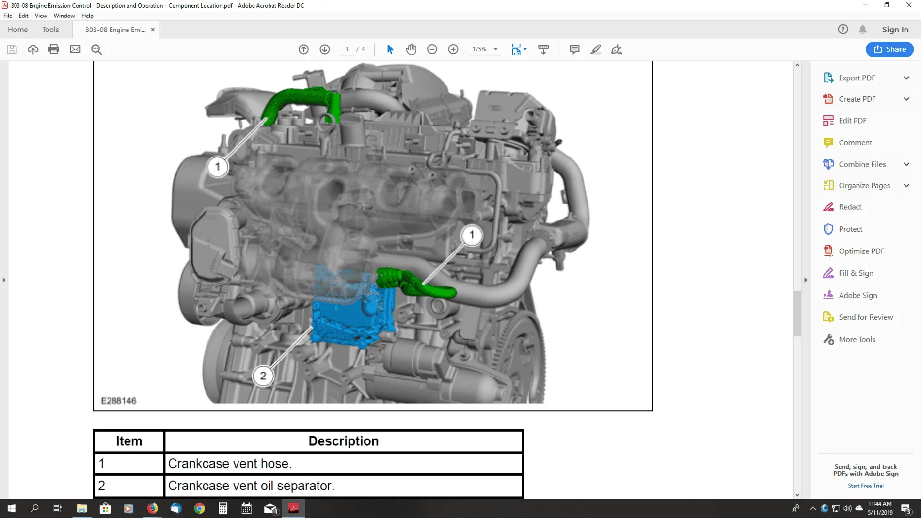

Dosen't the Ranger already have one built in. From the service manual.
I was going to ask the same question. It looks like it has one, or something to achieve the same result.
Here is an article that describes TWO PCV systems in todays turbo-charged engines and it discusses the vent oil separator shown as #2 in the diagram (the vent oil separator works only when there is a vacuum in the manifold....it closes shut during boost). The lone hose in the upper left is part of the PCV system that works under boost and this path is where a catch can would go (the valve cover itself has a 'built in' separator). The article also discusses the use of catch cans and from what I read I won't be installing one (I've got a lead foot to keep things clean :) ).
