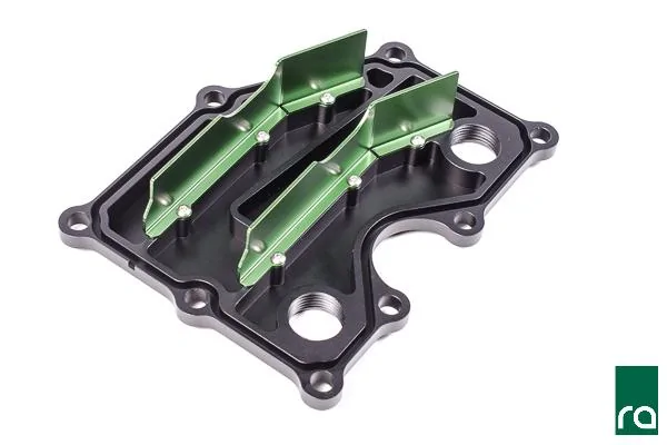

So, basically, you are talking about this: http://www.radiumauto.com/PCV-Baffle-Plate-Ford-EcoBoost-Duratec-Mazda-MZR-P1162.aspx#moreItemsPane
I wouldn't have a problem spending money on this in conjunction with 5k oil changes.

Soooo, you’re saying I might be able to address the intake valve deposit issue by adding this baffle plate and a better check valve? Rather than the other method of leaving the OEM baffle & check valve in place, then addressing the residual oil issue by installing an oil catch can?
If I understood you correctly, those are both rhetorical questions. I just want to make sure I’m following the logic. As someone else said, I would rather go this route and increase my oil change interval to address the fuel diluted oil (that normally would have escaped through the PCV and then baked onto my intake valves).

Yes that is correct. PCV has fuel and oil going through it so it can do both!
