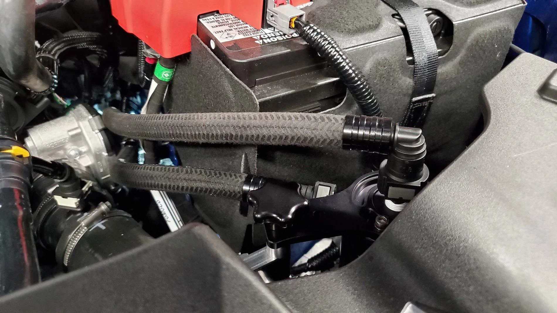

Just finished up fitment on the UPR 5030 can with check valve! We should have them ready soon.
Can’t wait, I’ll be ordering one as soon as it’s available
