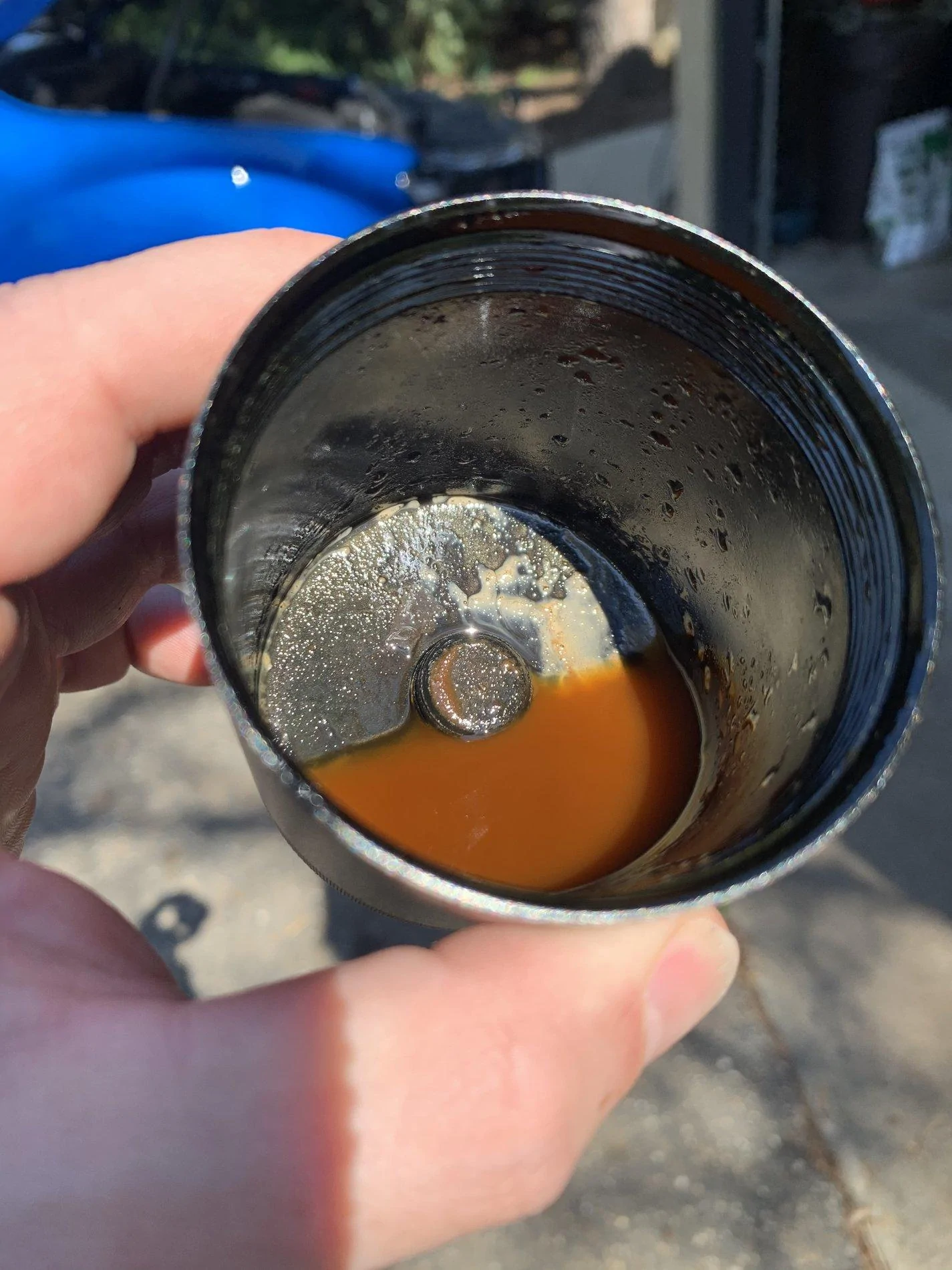

Hey y’all, went with the Mishimoto catch can after researching catch cans for awhile. Needless to say I’m sold on them. Here’s what I caught after only 1000 miles of the can on my Sport XLT ranger.
Giving another update after 1500 more miles with the catch can. Noticed more carbon on the bottom of the can, especially when I transferred it to the glass jug. Just more food for thought for those on the fence about buying one.
