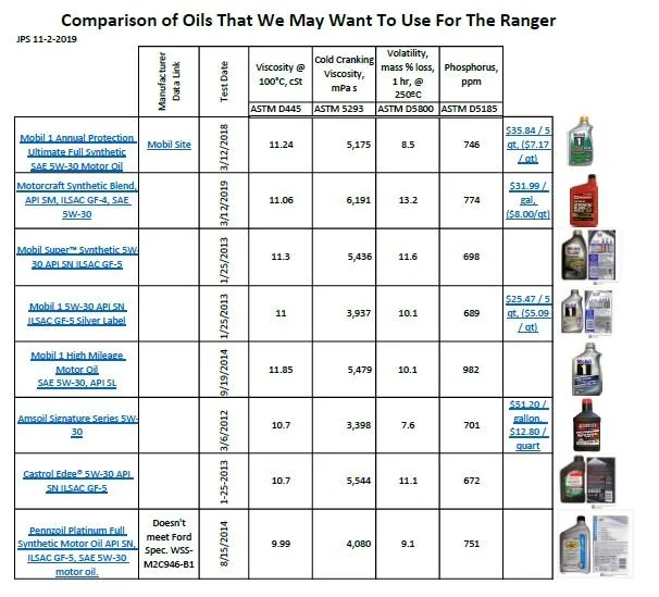

The next thing to do here would be a carbon deposit experiment, putting the residue from the catch can and (in a well ventilated area) heat it up to about 210ºF until the liquid evaporates and see what is left after that. That will give you an idea of what will be coating your intake valves....
Like a volatility test? Ford's Synthetic Blend isn't stellar....

not exactly, I was talking about a residue analysis of the substances collected in the catch can to get an idea of carbon build up; I realize not all will end up on the valves because it is intended to be burnt along with the fuel mixture
