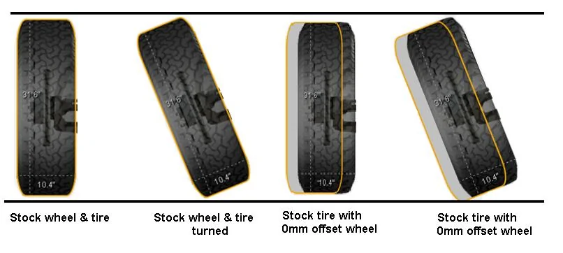

Hey Teo,
How are things in the Kootenays? That’s a nice fat tire for a zero offset wheel. How much is your truck levelled/lifted?
If it’s not, I’d suggest 2 to 2-1/2 inch level or lift. It might just solve your problem. If you’ve already done that, then your offset is the culprit.
Our stock offset is +55mm, as you get lower, you push the tires out. When you get to zero or to a negative offset, you’re pushing them out WAY further. Offset is the distance from center of wheel to hub interface. Zero offset means the hub interface is at the centre of the rim. Negative means it is closer to the inside lip of the rim.
As you lower offset, you increase backspacing, allowing you to clear the knuckle - a good thing. At the same time, you push your wheels toward the wheel well and crash bars - it’s a delicate balance. Go too far out and you rub - a bad thing.
Most guys with stock wheels and 285s only use a 1/4” or 1/2” wheel spacer to poke the wheels out a bit while avoiding the crash bars. That’s like running a +50mm or +42mm offset wheel.
Guys with low offset wheels tend to solve rubbing issues by replacing the crash bars with Fabtech, BDS or ReadyLIFT crash bars.
You’ve ventured into that area of Zero or Negative offsets that sometimes requires a larger lift or can only accommodate certain brands of tires.
With that said, @OFC Ranger has 285/70R17s on a 0 offset. I’m not sure what he’s done with his crash bars but he should be able to help as well. I think it’s his tire choice that is saving his skin on this.
This picture explains what low or negative offset does. The horizontal lines represent the crash bars - the shaded tires show their pushed out position.
Here’s a helpful link - scroll down to read the definitions...
https://tiresize.com/wheel-offset-calculator/
