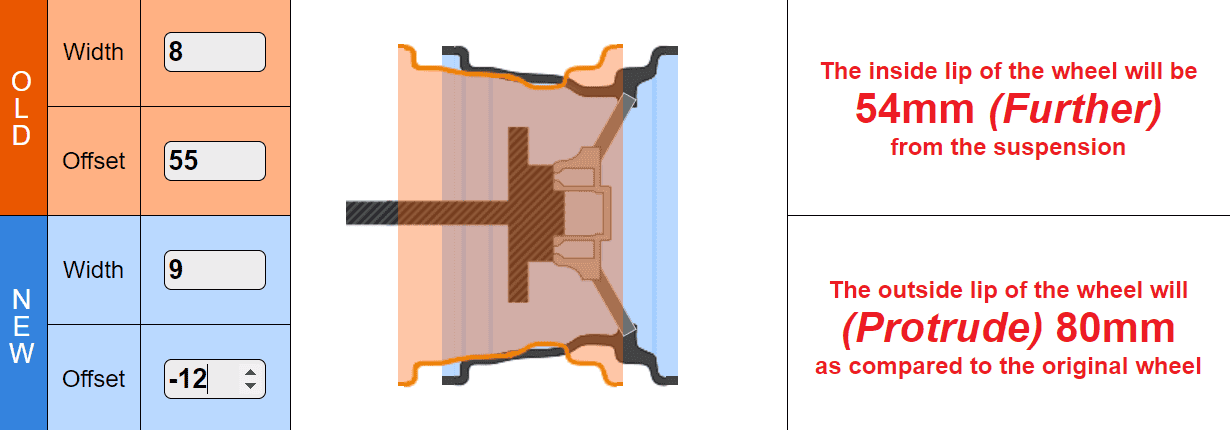

How wide are the aftermarket wheels? We're happy to help calculate how much further out the wheels are going to sit compared to the stock 18x8 ET+55 wheels.

If the wheels are 9-inches wide with -12mm offset this puts the backspace at 4.5-inches. Compared to stock, the front lip of the 18x9 -12mm offset will sit just under 3-1/4" further out towards the fender. Here's a visual, orange is stock and blue is the 18x9 with -12m offset.

The 9-inch width coupled with the -12 offset is on the aggressive side. With stock size tires it may work but if you go bigger you'll likely has some rub at near full lock of the steering wheel. Spacers will not help and will lower the offset which increases the potential for rubbing. A higher offset wheel may be a consideration if you want to reduce the chance of rubbing.
