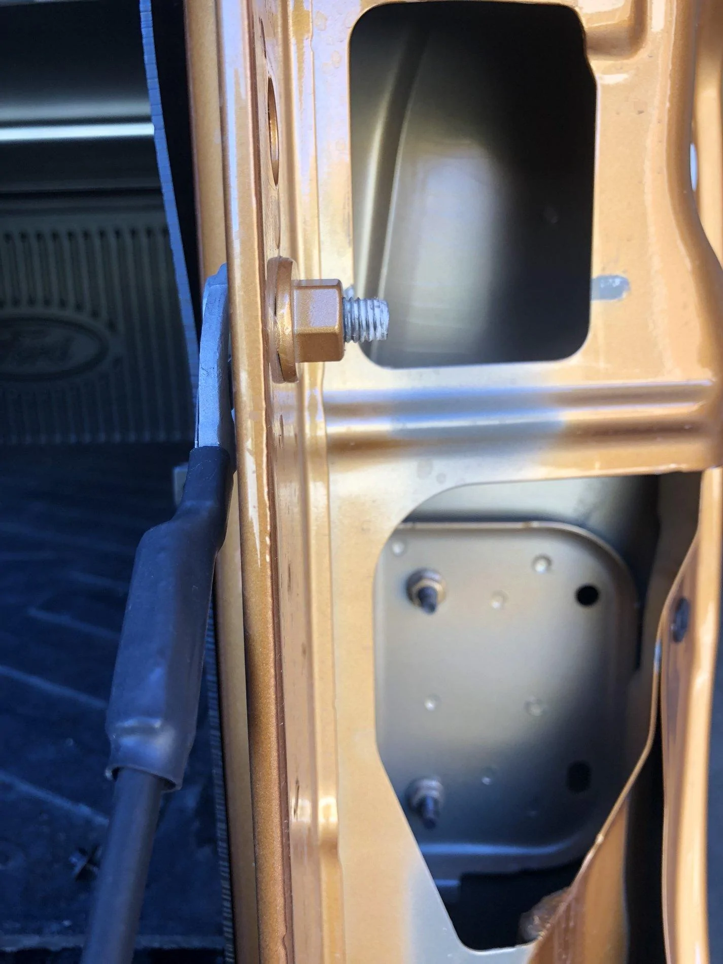

Has anybody pulled the taillight to see if a ball mount is already there?
I just looked and there doesn’t appear to be enough room back there but I could be wrong.
I hope I’m wrong.
Sorry guys but there's no ball mount in there.

I'm thinking it's not mounted in the taillight. It's just like that many others that have been discussed on this forum. Mount just below the cable clip and then the other end on the first bolt of the hinge of the tailgate.

I helped my dad install the equivalent kit for his Super Duty. If I remember correctly, the "ball mount" you guys are referring to is included with the kit and it replaces a bolt down below the tail light somewhere. Very clean install when finished, you wouldn't know just by looking...with the exception of paint color. It's probably going to come in black.

There's only 2 bolts in there and they're for the tie down brackets. In the video I posted above the ball mount is red and so is the truck. I would guess that if it was included it would come black,not color coated. If this one is for the Ranger maybe there's an adaptor that ties into one of those bolts? I'd call the dealer before ordering to verify.
