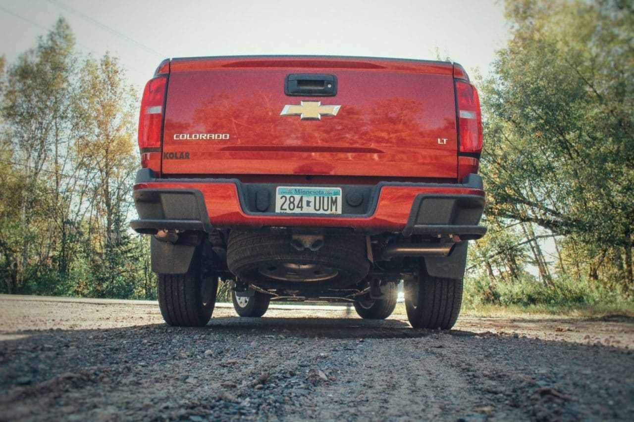

Be happy you don't the overloaded diaper problem Colorado's have...take a look next time you see one...you can't unsee it...I love how tucked up our spares are:like:

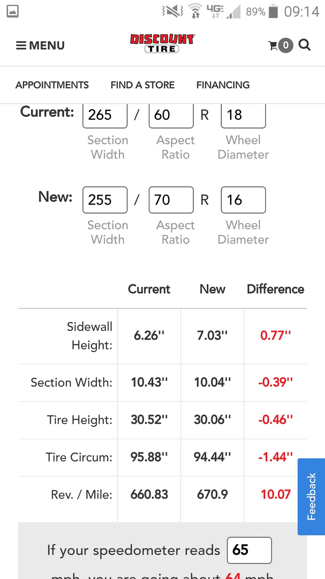

My 4wheels and tires are 265/60 X 18 but the spare is 255/70/16? The XLT is suppose to come with a 17 inch tire? Is it just mine or you too missing real spare size just in case?

I ran this. Significant difference with a .4 inch height difference. Maybe the engineers know better than me but I think we should receive the same size tire.

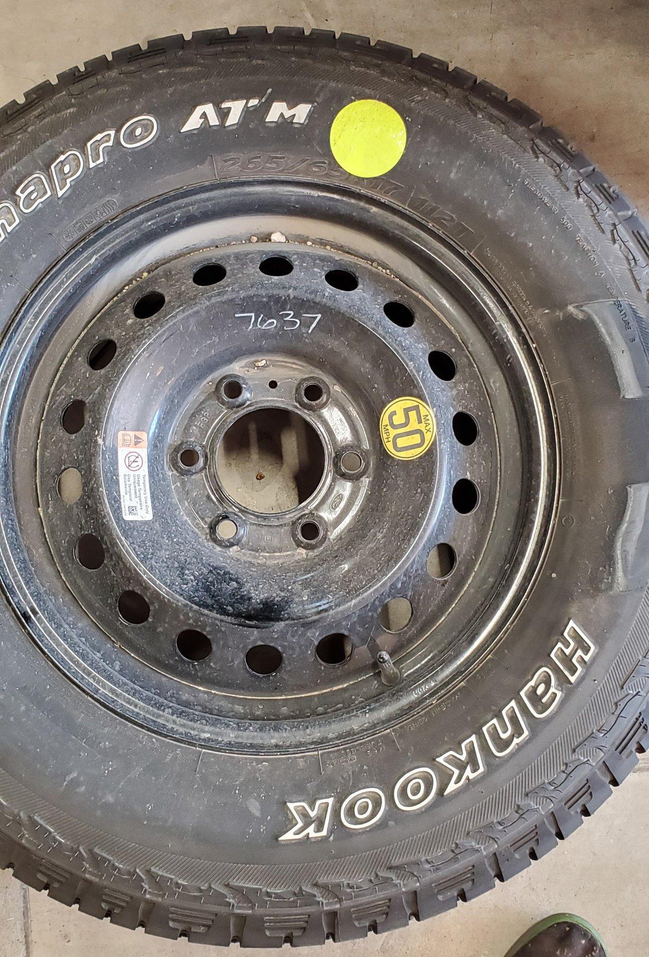

I took my spare down to familiarize myself with all the tools necessary and processes involved.
Mine is a 17" steel wheel with a 265/65R17 112T Hankook Dynapr0 ATM tire. It's mounted valve stem up, so checking pressure will require partial removal. It is marked with a 50MPH Max sticker.
My road wheels are 18" with same brand/style tires.

Temporary spare tires are meant for emergency use...as such, small differences in tire size won't matter to your drive train for the intended use period...I have 285/70-17 and there's no way to mount that under my truck...I'll either plug/patch with onboard repair kit or use the smaller spare...I honestly don't think it'll hurt anything in the short run...
