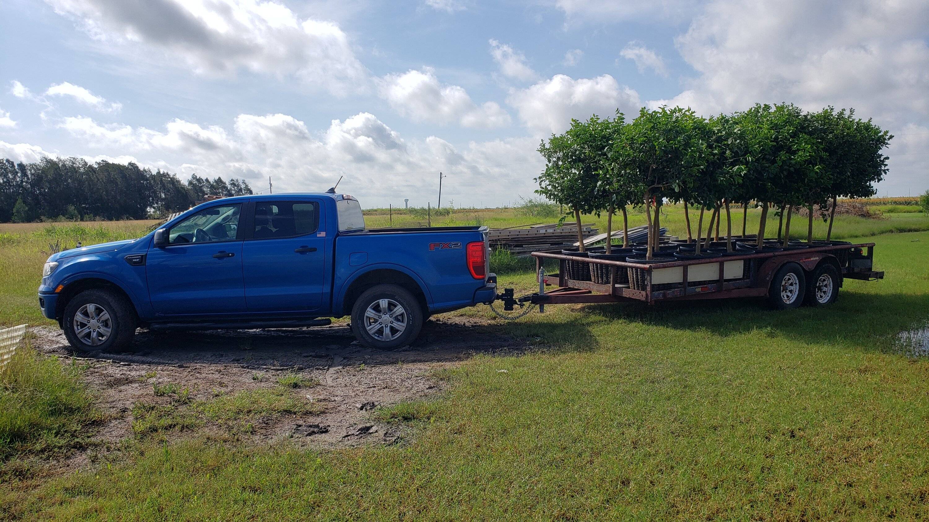

I second grumpaw's evaluation of the ranger for towing. I dobstuff like this a lot. And my fathers small cubota (i know spelled wrong) tractor. Or im towing a car or other big junk with trailers. Id like to know what towing in soft dirt and mud do to temps. A lot of you here always tell me you would get a fullsize to tow 7k and so on and so on. But the full size i would buy only tows 800lbs more and regular cab xl model and same cargo. And cost 10k more!? Why when i can have a luxurious xlt fx2. And do the same work. Except for f#$%*&! Shovels dont fit in the bed. So yeah, ranger is a little dirty all the time, i tow regularly. It is an awesome truck! I am stuck in the mud in the pick by the way.
