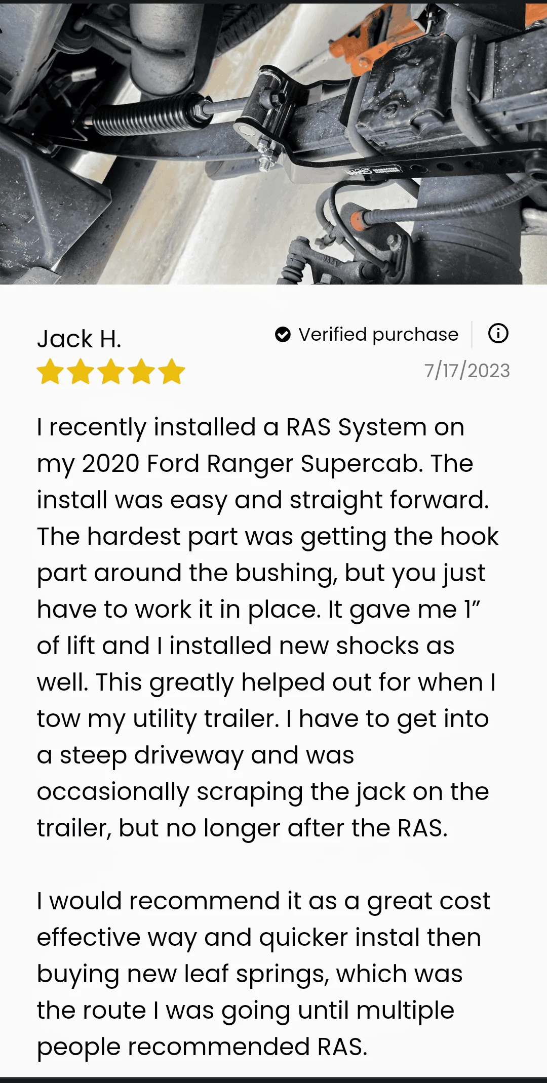

I got curious on how to further improve the rear suspension after switching to the ROW springs although there seems to be consensus there may be more squat with a load. I've long ago went with the Eibach shocks in the rear and wondered if there are even better options available but the idea of maintaining reservoir units is off-putting.
This brought me to this thread with @Grumpaw using the Roadmaster system. Expensive at over $500 and for my mixed use I don't know if I could justify the cost though the sales pitch is interesting.
Interesting note in this review on their site is the accessory raised the rear an inch... oh no. Is there anyone else who has sprung for this and long term what are your experiences?

Racket, all I can tell you is that they work. Yeah, raised the rear about an inch, but so do any larger size tires that many install.
Price...relative to anything else....cheaper than a rear sway bar, but takes the place of one. Cheaper than a good set of rear airbags, but takes the place of them. So if you were planning on getting either of those, than the Roadmaster is a better mod. Also acts as a traction bar set up. It's a passive system until you load up the rear, or like a sway bar, go into a curve or corner, than it becomes noticeable.
What I should have done prior to my install was to measure how much the rear dropped when I put 700 lb tongue weight on the hitch, and re-do the measurement after I installed the Roadmaster system.....should have but didn't think of it till after.

Sounds good and I would think the independent nature of the Roadmasters would be more desirable and safer when driving unladen. I would just prefer not to raise the rear any more than I have. I suppose that would be unavoidable unless Roadmaster has a solution or if it's a part of the installation?

It's just something I accept. No "fix" for it that I know of. Read thru their site, and owners statements, indicate almost all makes/models had rear raised a bit.
Also went to a slightly larger tire size in a 10 ply tire, and it was an inch larger diameter, so 1/2 inch higher. I also have a 2 wheel drive, with upgraded shocks and Sumo Blues, but my springs are stock.
