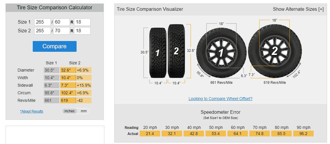

What was your OEM tire size? w/ the /70 are you noticing the speedometer being off a little?

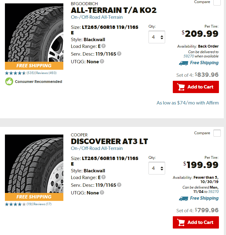

Not to change this discussion; but yes my speedometer and mpg is off a bit off using taller tires. The reason for me to switch out the tires was to have higher air pressure and load rating “E“ for towing my Airstream.
I understand that. We used to swap out a bunch of fleet vehicles to the BFG like these that are max pressure 80PSI and E rated.
