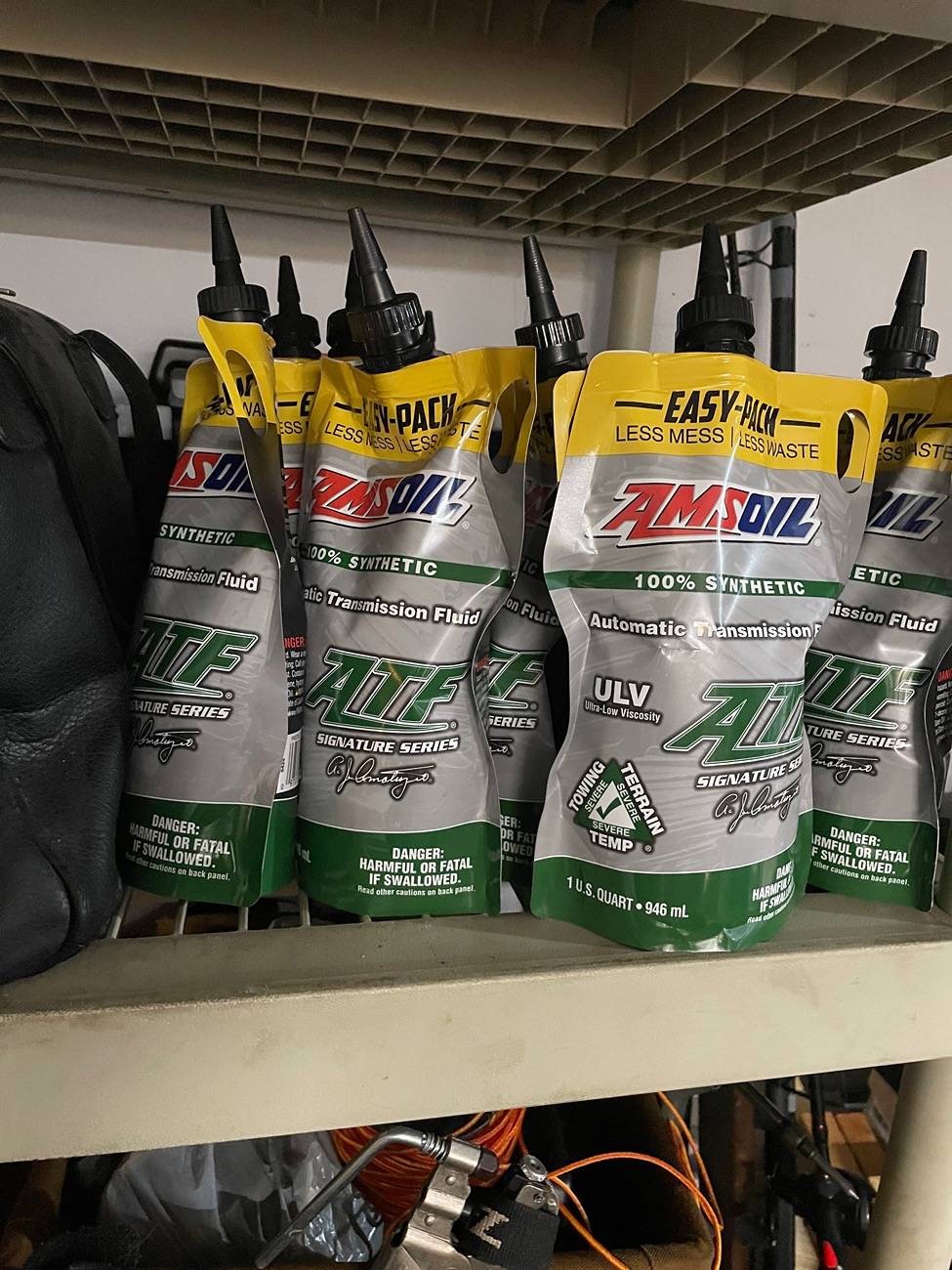

Well guys thanks for all responses, on the F-150 forum the topic was even more vocal , pro & con.
I only have 4500 miles since I changed the Fluid ,filter, and installed PPE pan and
the other dipstick available.
I have room on shelf and time to wait for someone to try it and report results.

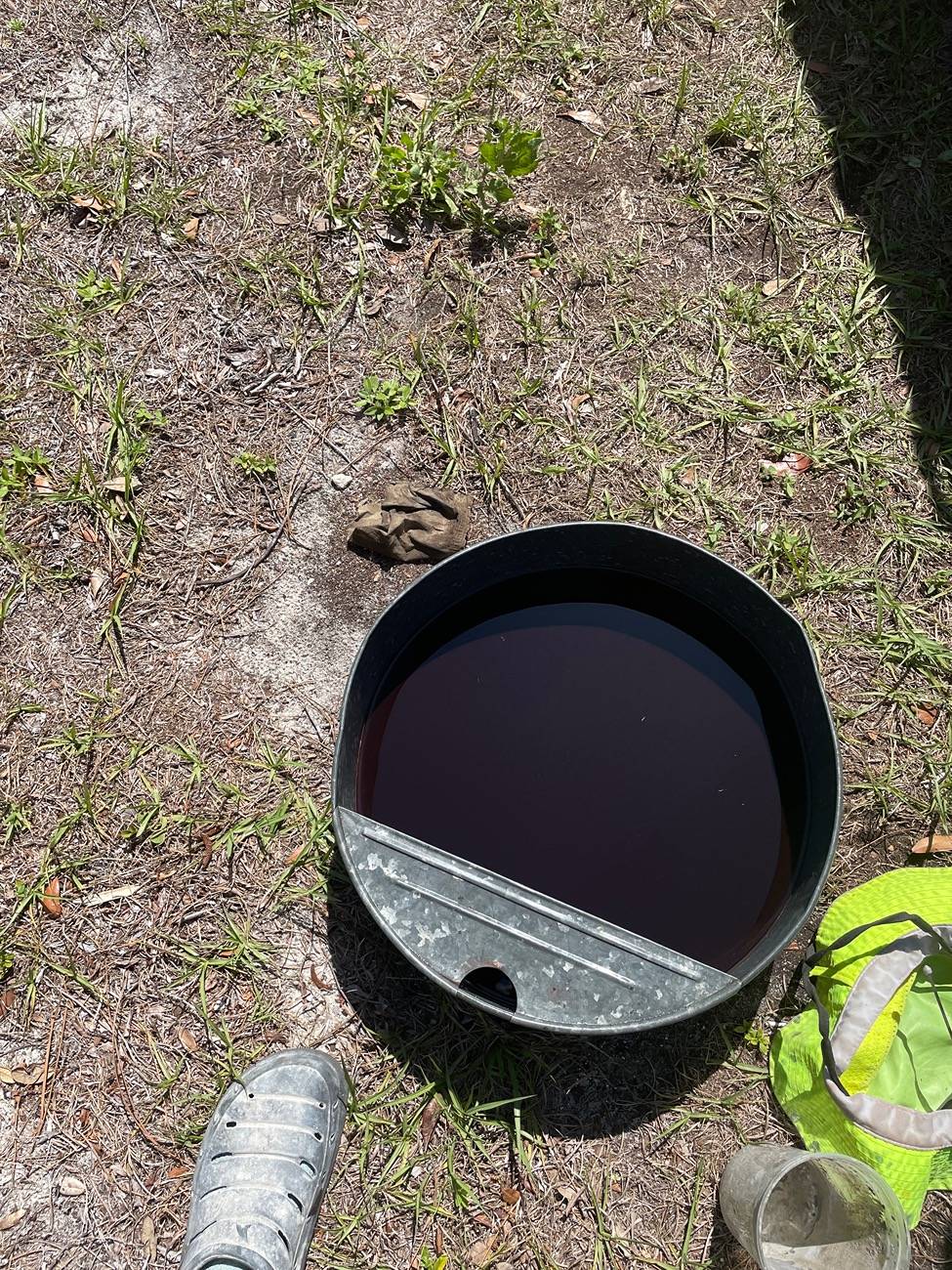

Ok. I helmed and hawed. Saw this and
decided to put the Amsoil ULV in.
The stuff came out darker with tiny amount of metal film on magnet.
I’ll let you know what happens on now scheduled towing 800 miles next month.
Test drive shifted smoothly.

WOW....they are sure proud of that stuff....3 times the cost of Motorcraft and Valvoline !!!
Have to take out a loan against the Ranger or 2nd mtg on the house !!!
Part of why I call it "ScamOil"

The fluid capacity is 12.7 QTs with oem pan, add 1 1/2 qts for extra capacity PPE pan. I drained out 6 1/2 qts, it took adjusting to 7 1 /2 QTs , driving it up to +180 F to get level to where it was on dipstick before drain. So now I have about 1/2 Ford and 1/2 the Amsoil ULV in there.
I posted the link to the guys oil analysis and picture of my dark red fluid for you to see.

After driving +10 miles I had to loosen drain plug and drain out one quart, and add half of it back to get to level on dipstick I wanted. The two fluids were blended fine. The real test will be more driving, the fluid temps monitored on my Glowshift gauge while towing camper in Fl heat in a few weeks.
