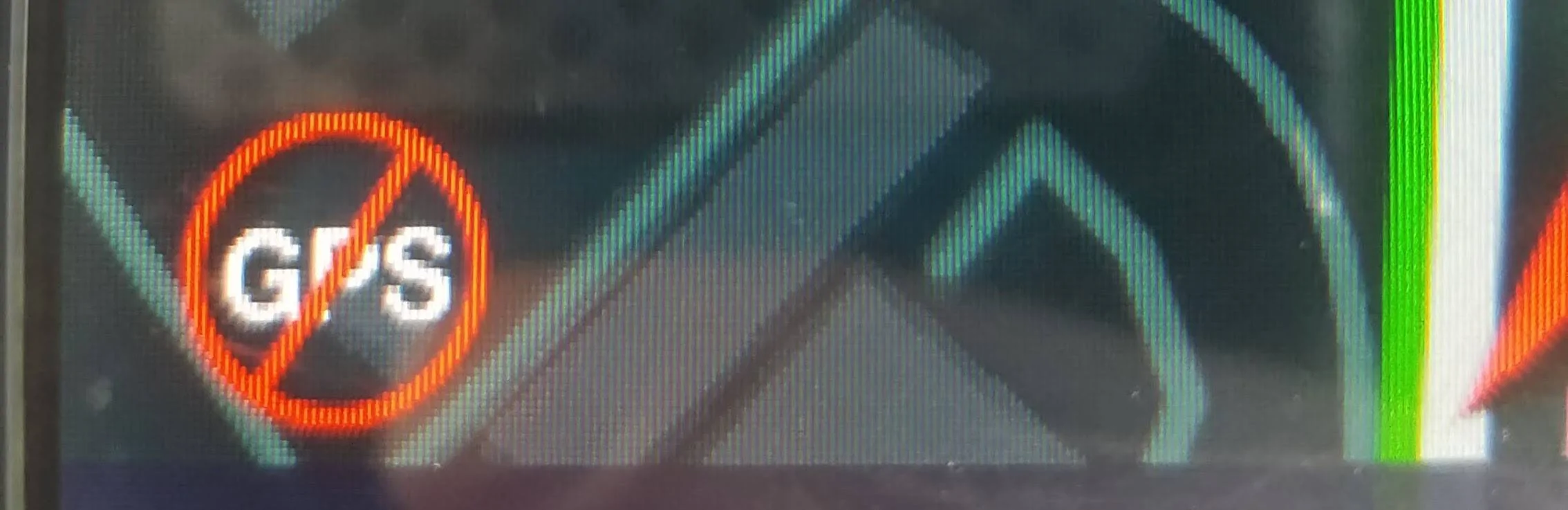

I’ve also seen that two times in my eight months of ownership. I haven’t a clue of the cause, but it’s gone after the next key cycle. ??‍Has anyone ever gotten the "No GPS" symbol in Sync3? If so, do you know what causes it?
It stayed on until I got to my destination (20 minutes), and then didn't appear when I turned the vehicle on the next time. I was driving under open sky.
FYI, cell phone reception has nothing to do with your GPS reception, they are two completely different and independent systems. It takes a minimum of three GPS satellites to triangulate your position. If you were in the mountains the GPS receiver in your Ranger likely could only see two satellites and that is the reason for the no GPS icon.I had it happen a couple of times, but both were when I was on low signal areas, in the mountains away from cell towers. I was gone the next time I started it.
I haven't had it since the dealer replaced the APIM.
