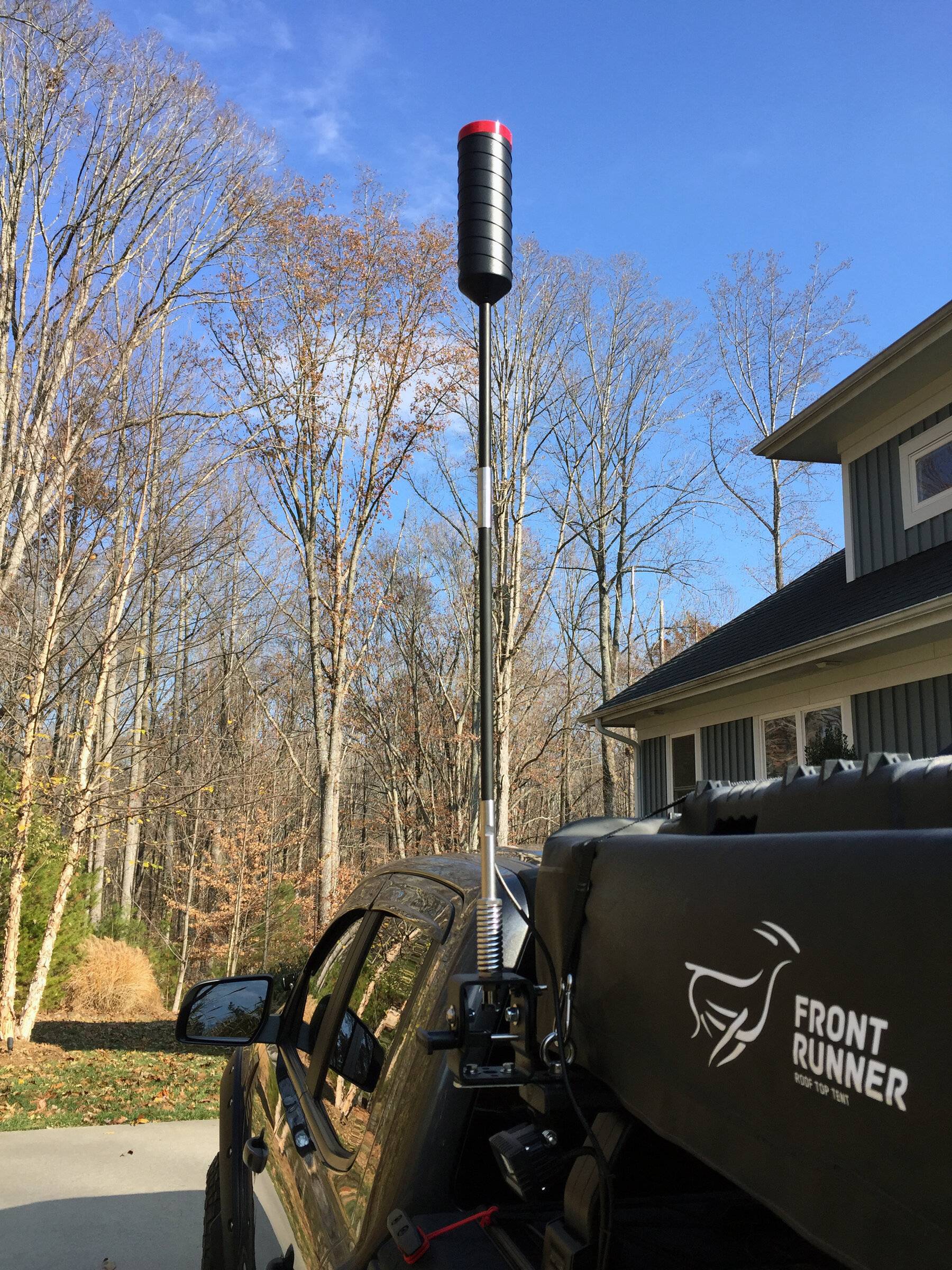

You're probably out of cell range?
Mine didn't have NAV but with my iphone/Carplay, I keep the signal boosted with WeBoost...
Navigation stuff does not require a cell signal - at least not for location data. For things like traffic data,etc, you'd need a cell signal.
