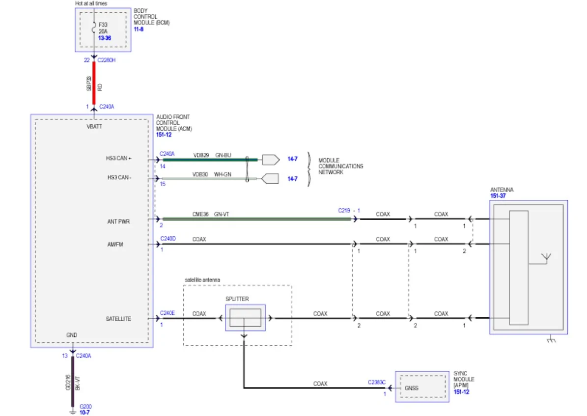

You may have a code locked in that is disabling the RF signals inside the APIM,
When on the Sync Screen, do you see a (Tab- Slider) for Bluetooth? to turn it on or off and is it greyed out.?
The above is an important detail for - T-Shooting
Plus, you might also look on your Sync Screen to ensure the:
Modem is displaying the ESN
You are displaying - Bluetooth & Wi-Fi Mac Addresses
I am thinking that a shorted (Coax) antenna is taking out the RF part of the APIM, even though Bluetooth is internal to the APIM itself
You may also try entering Bezel Diagnostics - (Press - Seek Up on - Steering Wheel & FCIM) simultaneously until the diagnostics screen shows, if I recall there are some signal strength parameters listed on these screens.
Mainly looking for GPS information (How many Satellites)? test when outdoors, not in a garage.
