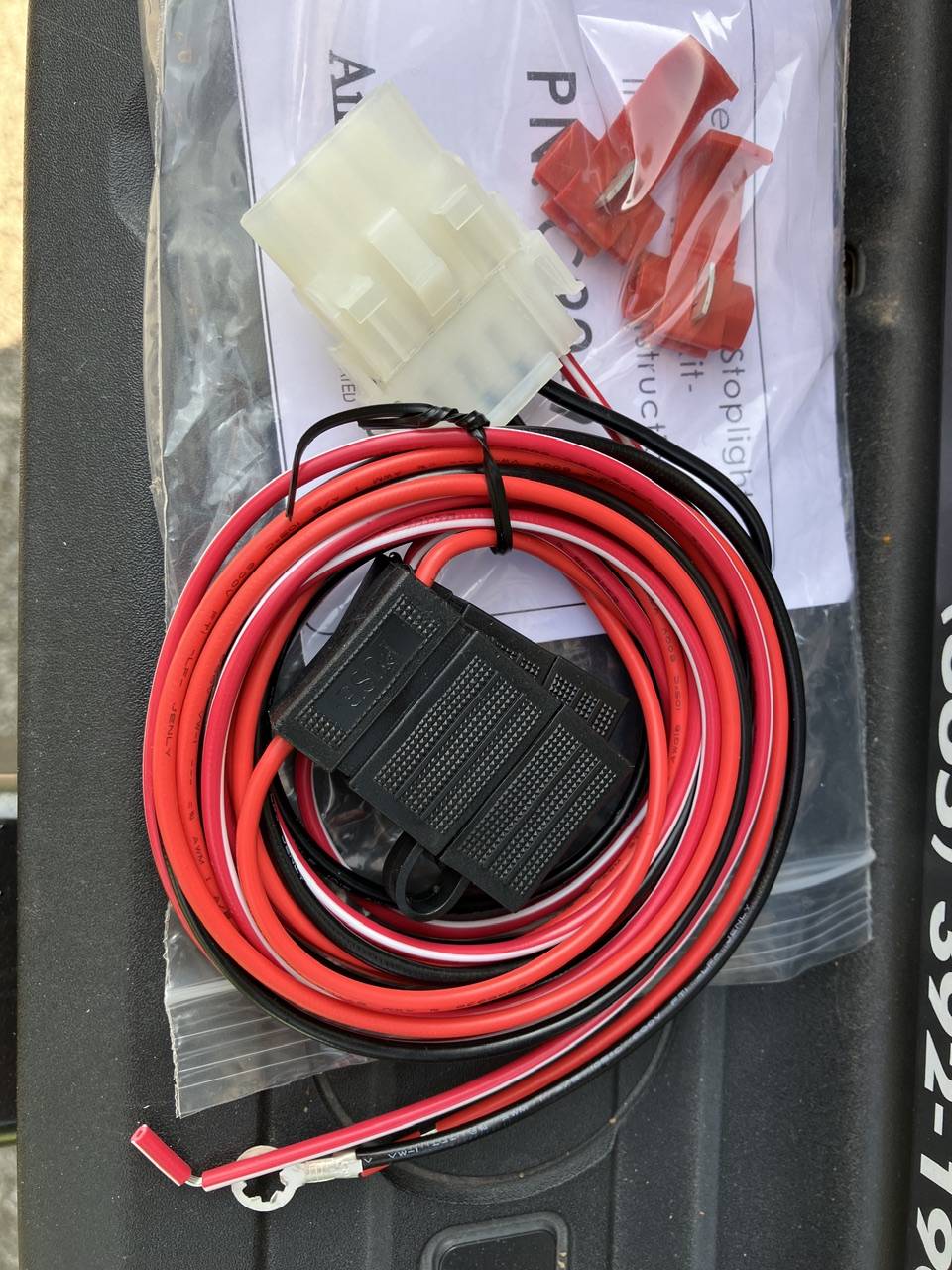

Really appreciate this. Items bought. Much nicer set-up. Looking forward to putting it together and replacing/removing the spliced connectors.
Cheers!
No problem.
Make sure you look at all the pictures for the female end at Wolfhaus site. He provides instructions.
Once you are done, you'll have a water proof OEM connection.
Edit
You get one chance when it comes to crimping. Make sure the polarity is correct.

Or you can make your own splitter from that plug. I don't like splicing. (see pic)
Wolfhaus had a 12 volt socket plus an extra wire connection. But I don't see it at his site. I made my own splitter instead.

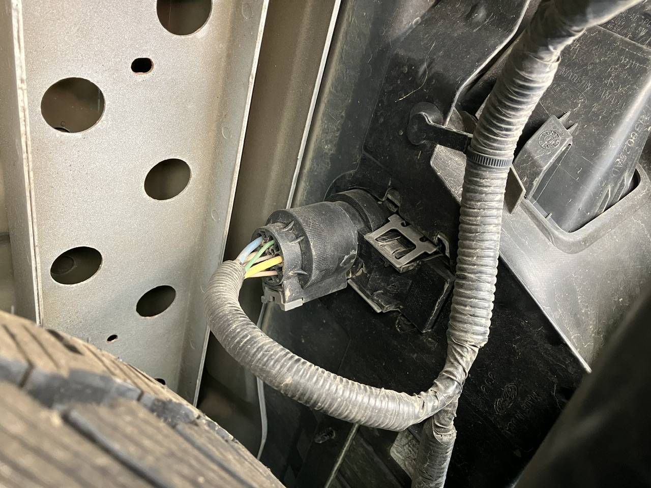

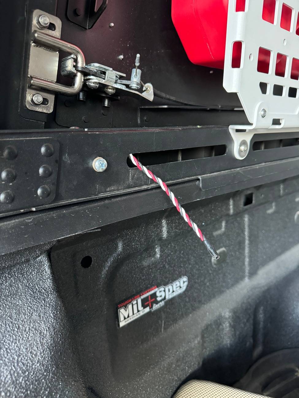

ok, here is where I’m at:
First pic is the wire and plug in the topper. Two left wires go to 3rd brake light on topper and two right wires go to topper dome light.
Second pic I ordered a “Topper wire harness 4 prong” from Truck Outfitters because it looks like it should hook up to my topper 4 prong?
planning on running that harness out of bed to splice the 7 pin connector Pic 3 for 3rd brake light. Wondering where to get power for dome light without key being on?
Here's the problem with doing that. The truck will think you have a trailer hooked up.
This is one of many posts that mention it.
https://www.ranger5g.com/forum/thre...-pod-reverse-kit-c1r-brake.23060/#post-516982
They have been splicing to the brake light behind the tail light instead.
The only way I can think of is straight to the battery.

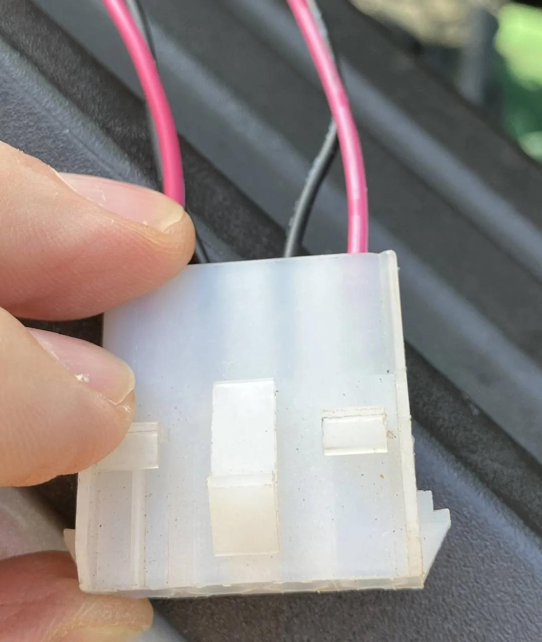

@underwhelmed, @Figarou I am bringing this thread back up and I need one of you to take out your big red crayon and draw me a picture. In otherwords, I need someone to dumb this down for me. I just purchased the Wolf Haus connector that I can plug into the factory wires. I do not need light hook up (I installed Hardkorr lighting using a 12V system attached to a power bank). I just need the 3rd brake light working which I have attached a picture of the wires. Power and ground. The question I have is where are you plugging this into the tailight assembly? You are having to splice into that..correct? And if so, how?

I’ll have to check. I know my dome light is spliced into the Wolfhause under the fender ad third brake iight into the brake light behind the taillight. I think there is a post on the forum somewhere with pics on third taillight splice.

Ok. I figured it out. Light is working as it should now. I ended up calling Super Pacific and asked them what color the wires were for: Red-Brake, White-ground, Black-tailight. I ended up using a 2-prong water tight connector and attached the red wire from the camper to the red wire on the connector. I then connected the white wire from the camper to the black wire on the connector. When this was completed I used a wire connector https://www.amazon.com/Posi-tap-Con...95455&hvpone=&hvptwo=&hvqmt=&hvdev=c&hvdvcmdl to tap into the red wire and black wire on the tailight assembly. Afterwards, I cleaned everything up with shrink wrap and we are good to go!
