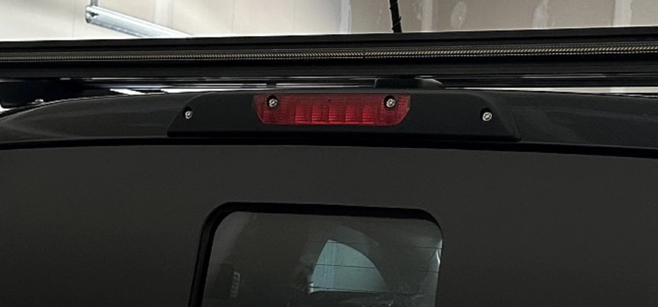

So, I just now found this thread as I was attempting to put in my new smoked third brake light into my 2022 Lariat FX4 SuperCrew. I am sure you've already figured this out on your own, but I just wanted to add my two cents.
I can say definitively that you cannot install it from the outside only. At least not on a 2022 Lariat. The wiring must be released from the truck from the exterior, but it is not long enough to pull through and access the required connection.
You must pull down the headliner in the back in order to access the connection. Then slide the brake light's wiring through and connect it. The headliner wasn't easy to pull down, but it did eventually. And there wasn't any lasting creases or anything that came about. It popped back in without much trouble.

One thing to note is that this brake light's connector does NOT fit exactly as is. I had to shave down small tabs on one side in order for it to fit correctly. But it connects then and stays connected. And everything works well.
Finding black screws to replace the stock silver ones was almost impossible at Home Depot (since my whole truck is blacked out, I needed black screws for the smoked out light). I did find some that didn't match exactly, but they work.

That is not the case for all 2022 XLT, as I did my buddy's completely from the outside. Maybe your wire was stuck on something or shorter than others.

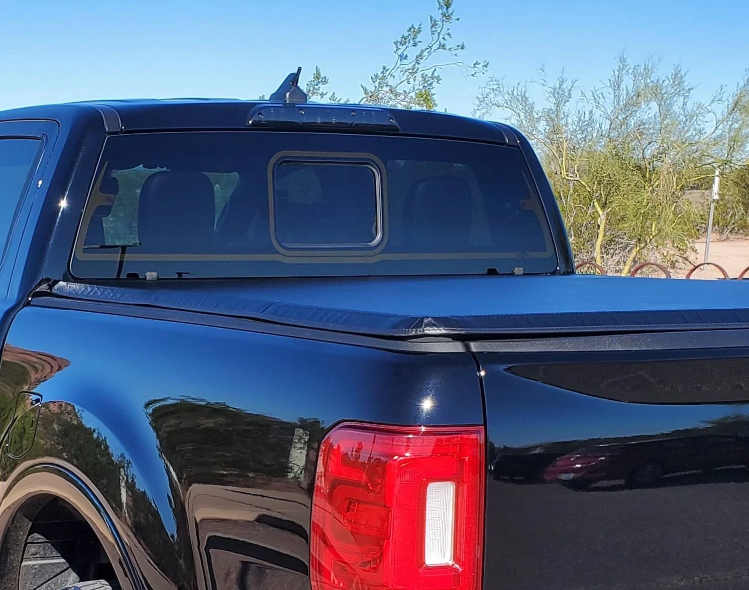

I also took mine out working only from the outside, 2020 Lariat FX4. I didn't replace it, just plasti-dipped the white lights to black.

I removed my 3rd brake light 2020 Lariat FX4, and my buddy's 2022 Lariat
Well, that figures. I mean, yeah, you could be right. The wire could have been stuck on something inside somehow. Of course, I wasn't going to keep jerking on it to try and get it longer. Just made it harder for me, I guess, but it worked out in the end. Just figured I'd give a warning to others who might come across the same trouble. It's still possible to do even if the wire connection doesn't come all the way out of the hole. Sure wish I'd had your wire, though. Would've saved me probably a good half hour.
