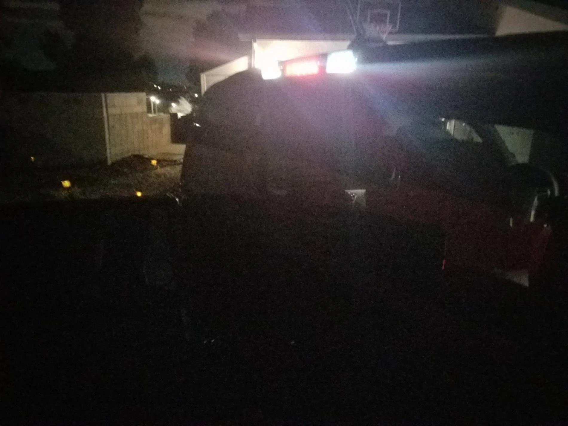

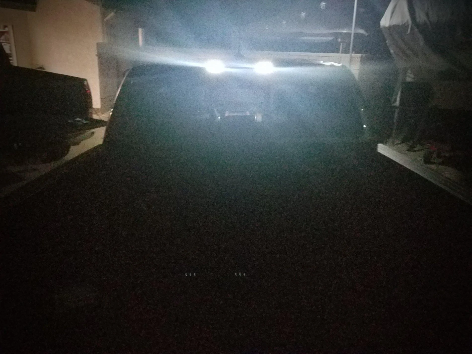

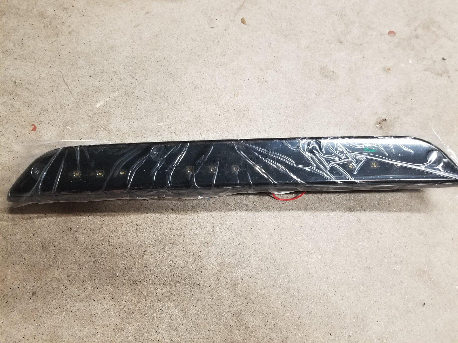

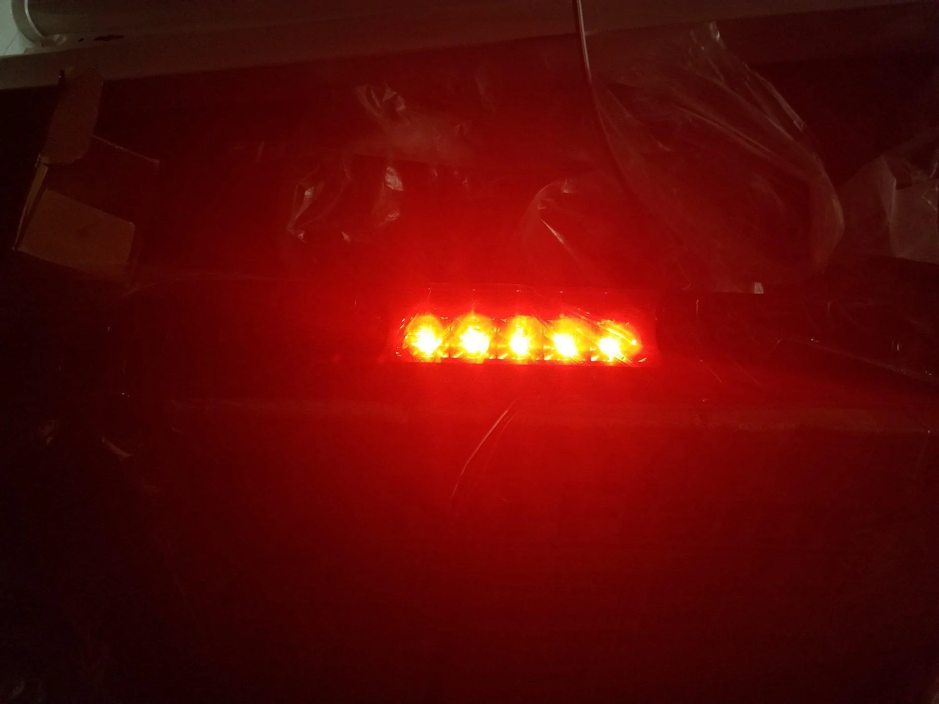

Here are some pics of what the light actually looks like. I wired it up to a old car battery, so the lights may be brighter when actually on the truck with a full battery. I also haven't removed the protective plastic yet.
Stock

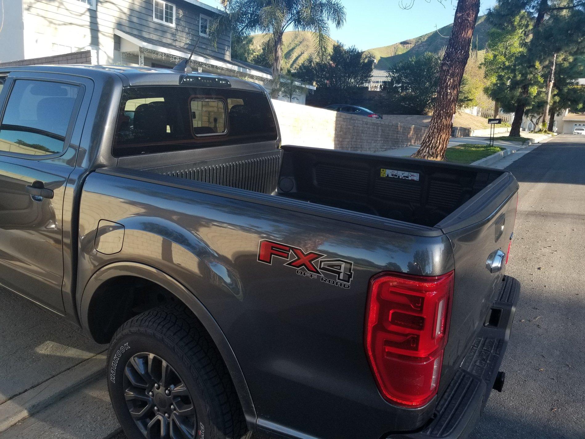

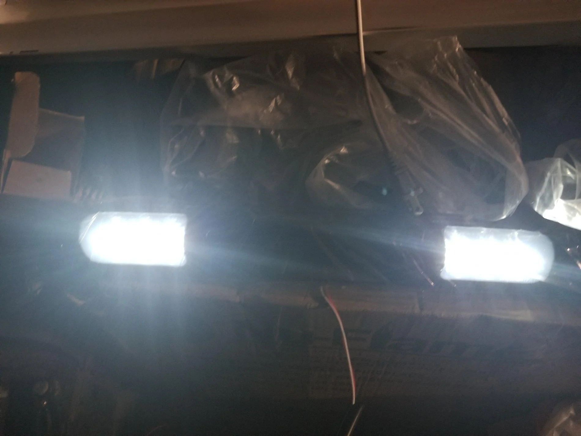

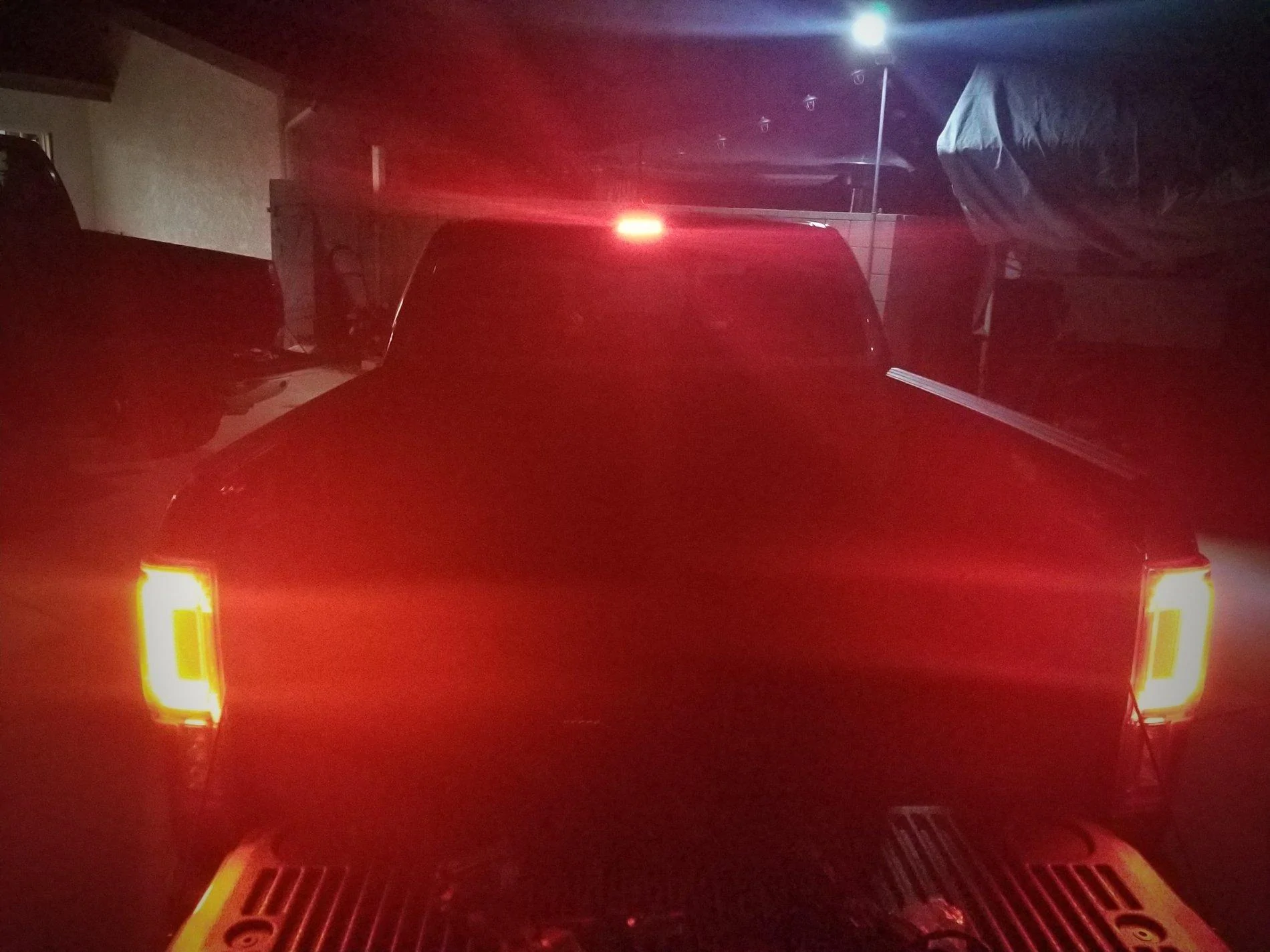

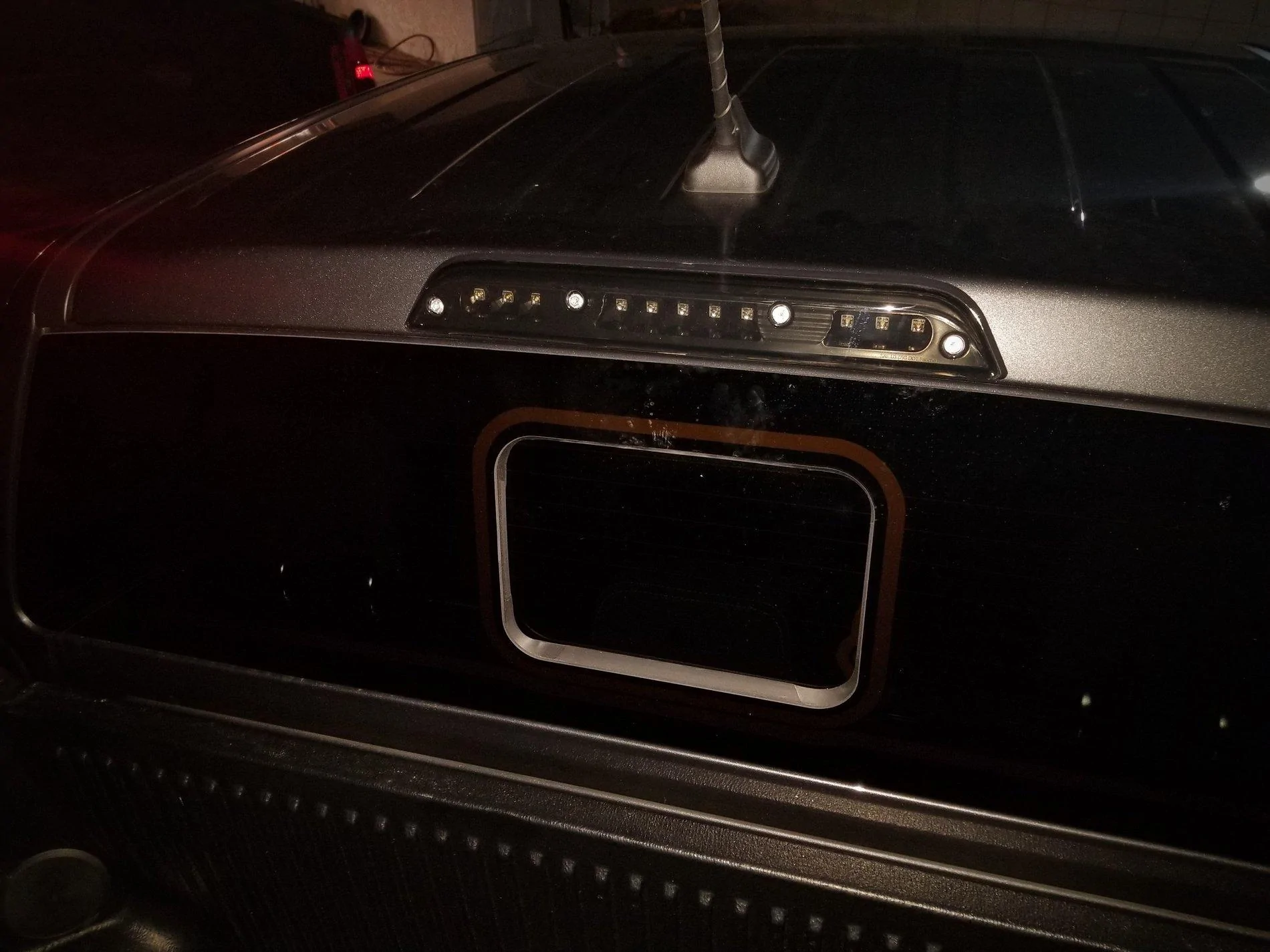

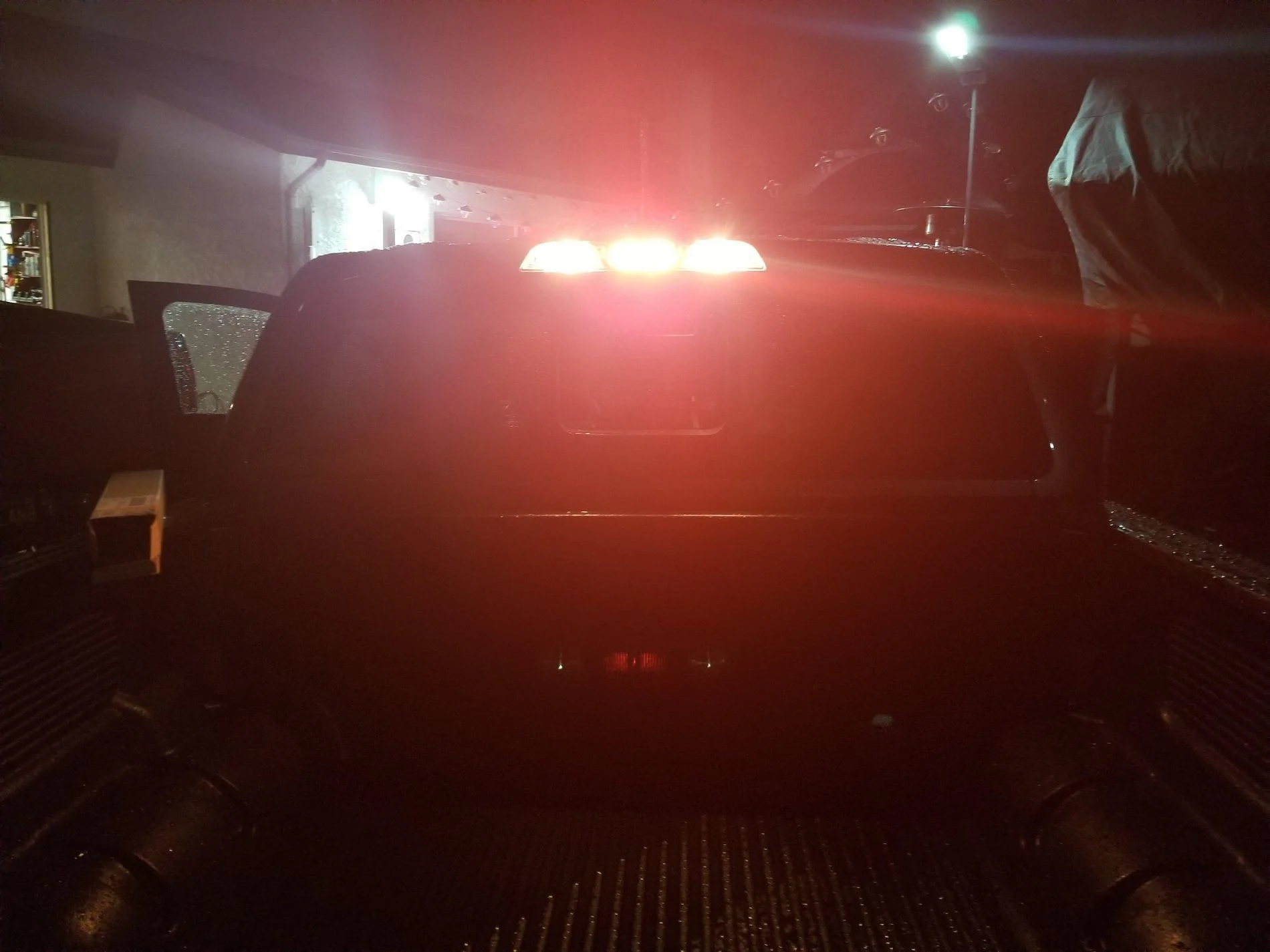

Got this installed tonight. I was able to just pull the headliner back a bit and get my fingers in there. You do have to push a push clip away from the body on the light side. Other then that and you'll need to file down some nubs on the new light and then it plugs right in and works.
The brake light comes on quicker and is more noticeable. The cargo lights.....well they look neat, kinda worthless for bed lights though:thumbsdown:. I will also add some silicone around it to be on the safe side. But it's pretty much plug and play.
Anyway on with the pics.
