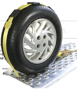

I said in a different post that the conventional wisdom of the setup folks is if the tires aren't low they're good to go. The factory deliberately over inflates the tires so that they don't compress when strapped to the rail car or transporter. This dencreases the chance of the straps becoming loose in transit and allowing the vehicle to move fore and aft, potentially bumping into an adjacent vehicle.
