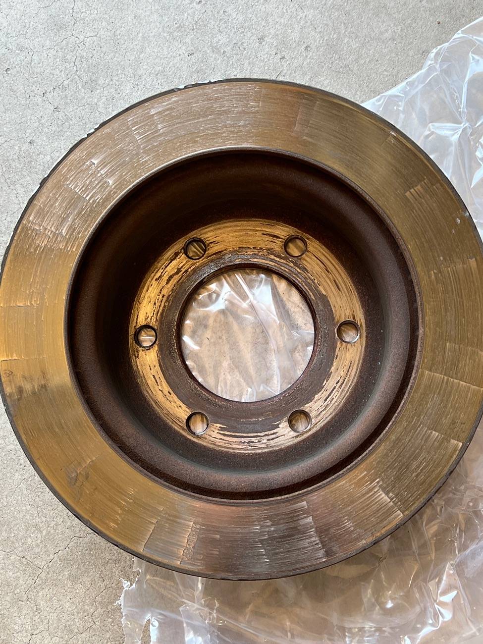

Had the same shudder. It is the rear brakes. Same looking rotors as what has been posted here. It was REALLY noticeable when towing (IE Putting more heat into the system). 58,000(ish) miles on the truck. Pads were only half way used, but they're in the trash now.
They're not cracks, and they really don't look like a typical pad deposit. Who the hell knows, if you're getting shuddering from the rear, shit can the rotors and pads. (And don't put Motorcraft ones back on)
Just another in a long line of 'Ford, you could have done better'
And no, the 'cracks' aren't aligned with the vanes, some are, but some aren't, no real pattern I can see.
