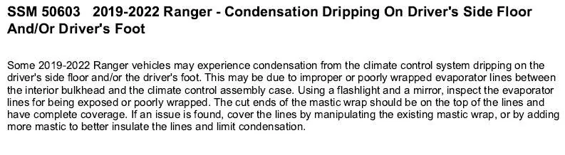

Water in the cab - known areas for leaks (Rainwater)
The door seals (weather strip)
The windshield adhesive sealant, more noted along the sides.
Condensate Drain (Leaks)
Clogged drain line (difficult to access) as it is above the transmission bell housing (buried)
when its clogged up, you will get (dump) out from the bottom of the HVAC box on turns, think pan full of water sitting on the floor (in a turn) momentum pushes it over the sides.
This is more noted on the passenger floorboard
The EVAP lines (insulation) wrapping - This is only noted on the Driver's Side as the EVAP lines are on the Driver's side.
Here is the SSM for that and the one referenced in the video
The video points out (and the first I have seen) that another possible source for condensate draining into the cabin floor is (the best I can tell) from the video is that the drain tube does not stick out far enough and is backflowing into the cabin.
