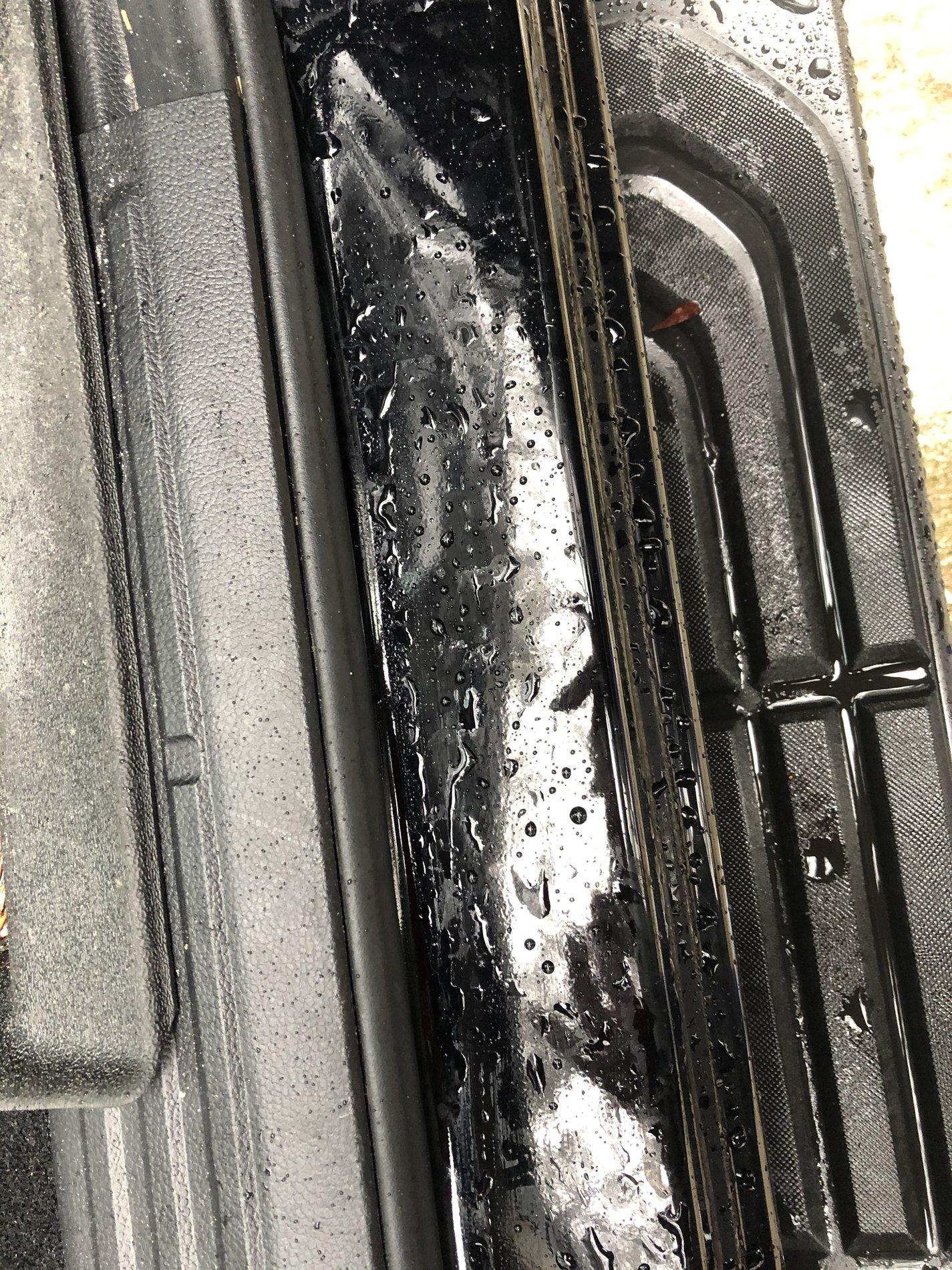

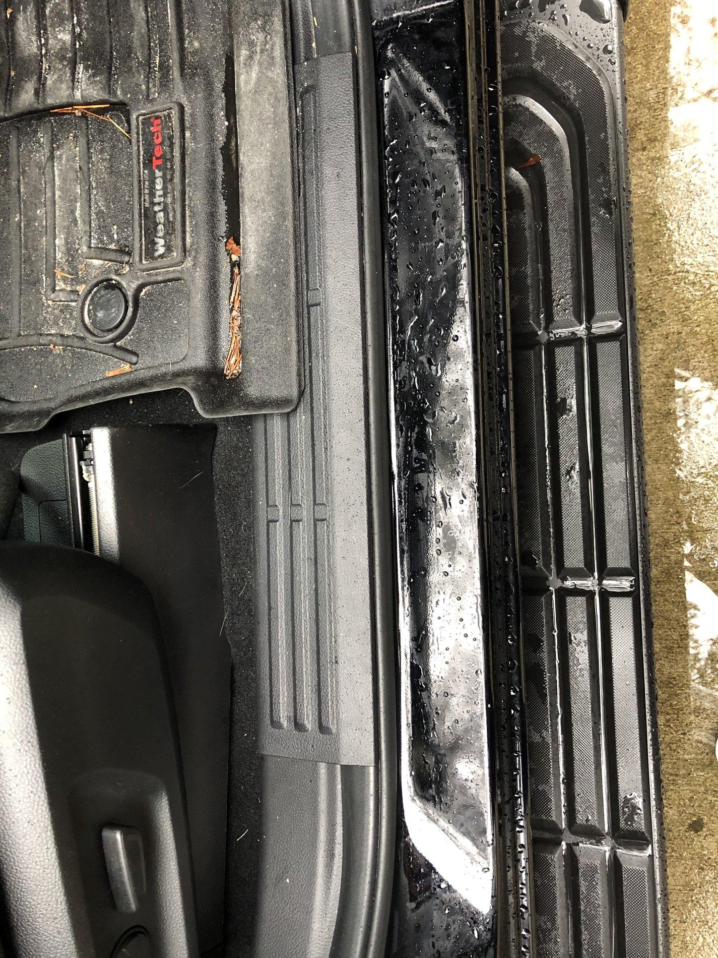

Has anyone had an issue with the carpet being wet in the floorboard? My driver's side is wet. I have noticed water on my door sills and wondering if that is causing the water in my floorboard. I have a worthless service department at my Ford dealer, so before I drive miles to the next nearest dealer, I wanted to see if anyone else has had this problem. Thanks

Water on the metal sill is to be expected - the door seal is inboard of the metal sill, so I doubt that is the issue.

door sills on both sides are wet, but it's only the carpet on the driver's side that is soaked. It rained hard Tuesday and i didn't go to work yesterday, so it didn't get driven.

Is it water or something else? There was at least one report of a leaky heater core some time back. Does it smell like coolant? Or is it just water? If it is just water, see if you can see if it is more soaked in one spot which would point to where it is leaking in.

It's just water, but smells musty and the carpet is only wet about halfway across starting towards the door, that is why I was thinking it was leaking near the door sills. I guess this is why my truck never had that new car smell, I thought it was the leather seats.

The door seal may be cut/pinched/out of line somewhere around the door.

Dealer called today, looks like the water was coming in from the back window seal. They are going to reseal it and dry my carpet out, should get it back on Friday. I hope the carpet doesn't get funky smelling when it warms up around here.
