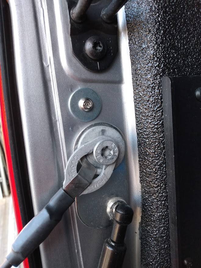

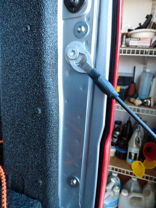

After following this, I just went out and bought a pack of license plate security torx screws.
1/4 " x 3/4 "....pack at Advance Auto is $6 bucks. Comes with a 27 torx wrench, but I happen to have a set of security torx sockets.
If it slows someone even a few minutes extra, so be it....

Steve are those in existing holes? Thanks,
Yes...the small hex head screws that hold the lights in take an 8mm wrench/socket to remove.
The threaded part is 6mm x 20mm long
A 1/4" x 3/4" screw is within .3mm so about the same size.

You screwed it through into the lamps?! ?
Of course...they replace the hex head screws that are used...the one's that screw into the taillights.
