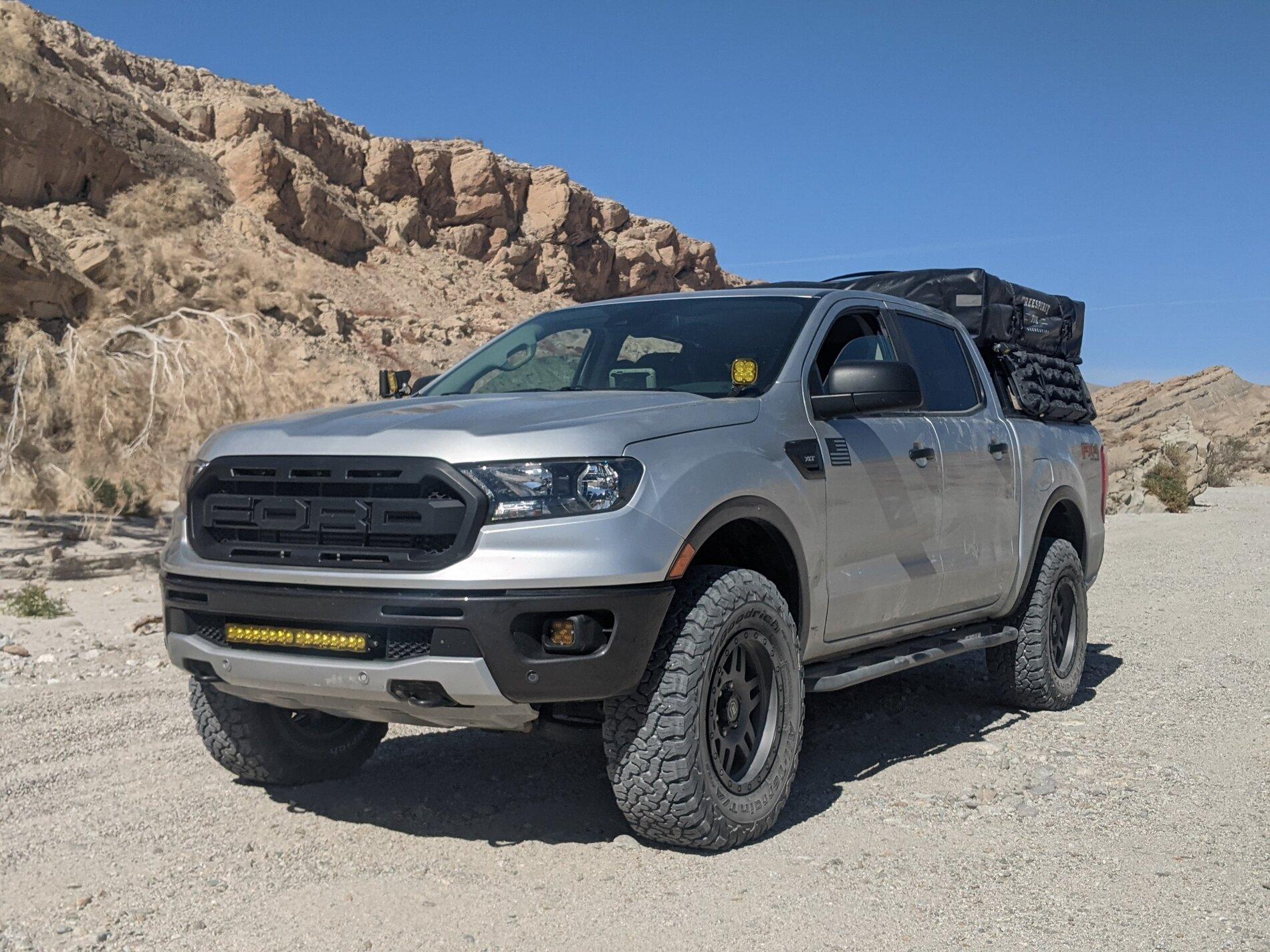

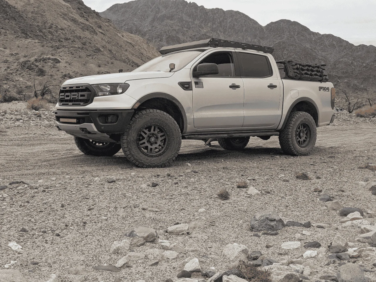

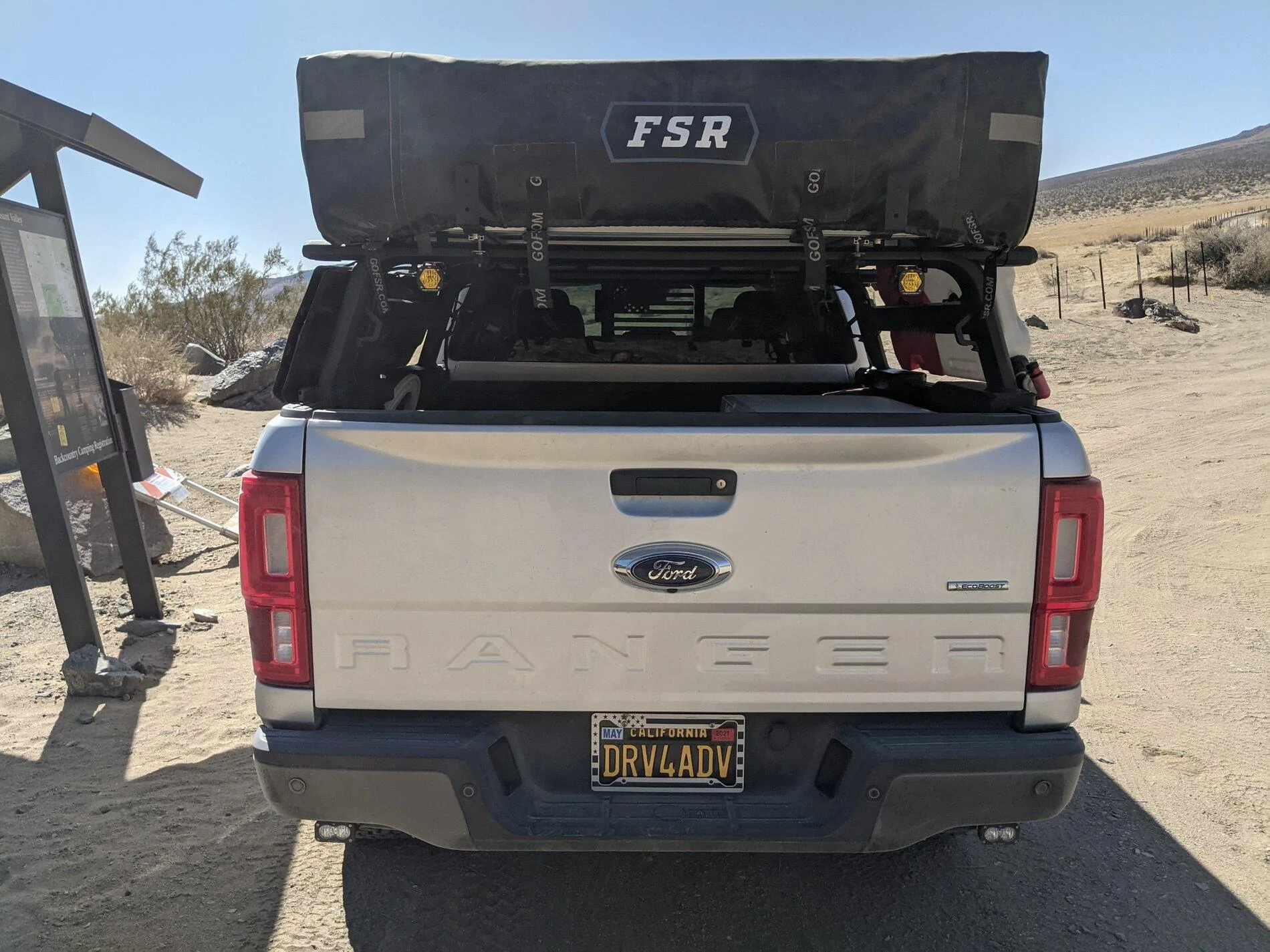

Here are the After pics.
Fully geared up with 400+ lbs in the bed
A slightly different angle
Rear with no weight in the bed. It is a much smoother ride with some weight back there. Without the weight the ASS sticks way up in the air like a dog wagging it's tail.
Great-looking Ranger! How on Earth did you get it on the moon? :wink:
That's Anza-Borrego. It's a beautiful desert with great camping and even cooler trails. Look up Sandstone Canyon. There are countless YouTube videos on the place.
Death Valley also looks a lot like the moon. It's where parts of Star Wars was filmed.

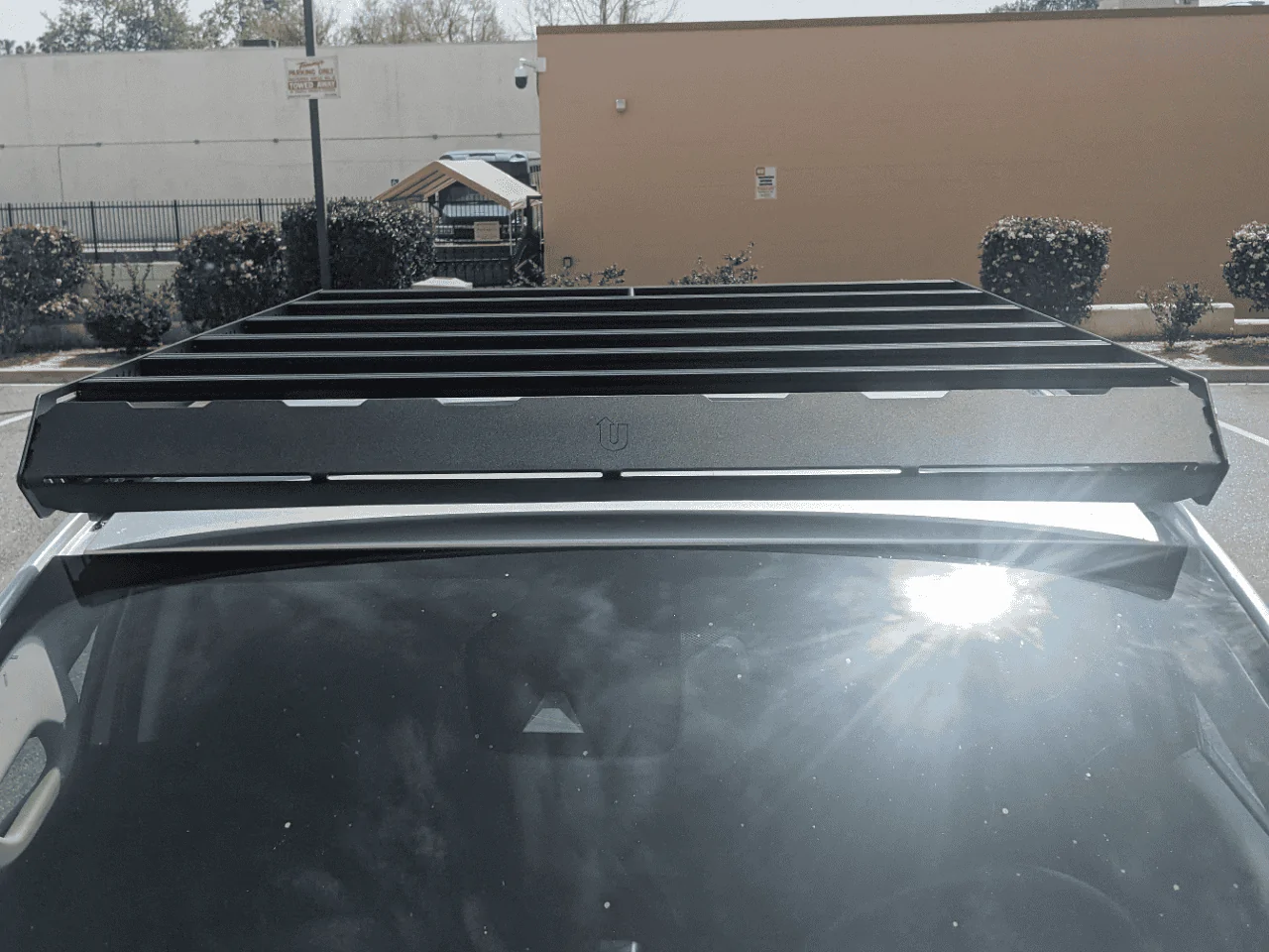

I just ordered the Bravo Roof Rack from Up Top Overland. 8 week build time!!! I'm running out of space for these longer multi-week trips. I figured it's about time that I expand my cargo capacity. I'll probably mount solar to the front of the rack and one or two boxes to the rear of the rack. Looks like I have about two months to decide how to configure the space :crying:
I looked at Prinsu but it was $200 more after shipping. Rhino Rack was even more expensive than that. So was Front Runner. Up Top Overland came in at $600 shipped! Not bad if you don't mind the wait.
https://www.uptopoverland.com/products/bravo-ford-ranger-roof-rack-2019-2021

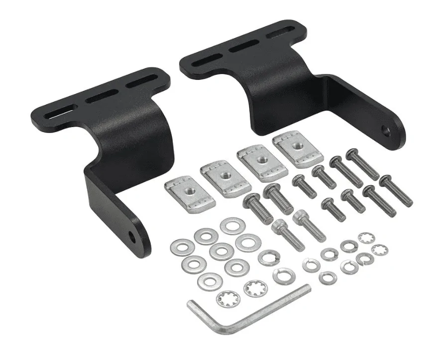

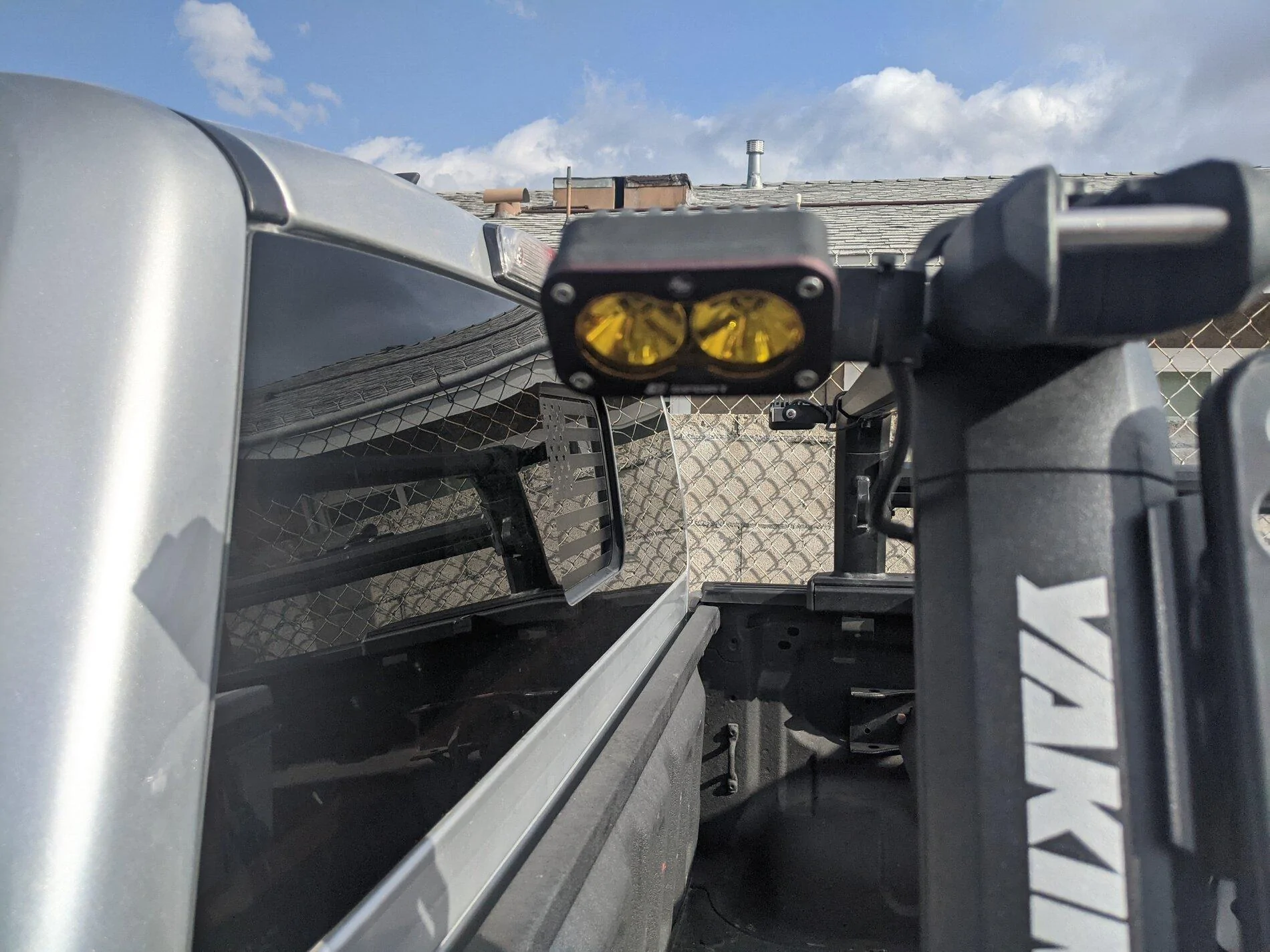

Where did you get the bed rack light mounts?
The brackets for the side facing lights are the Rhino Rack 43174. It's for a light bar but I used them as individual light mounts instead.
The rear Chase light brackets are just some L Brackets that I had laying around. I think they came with my Rhino Dome 1300 awning.

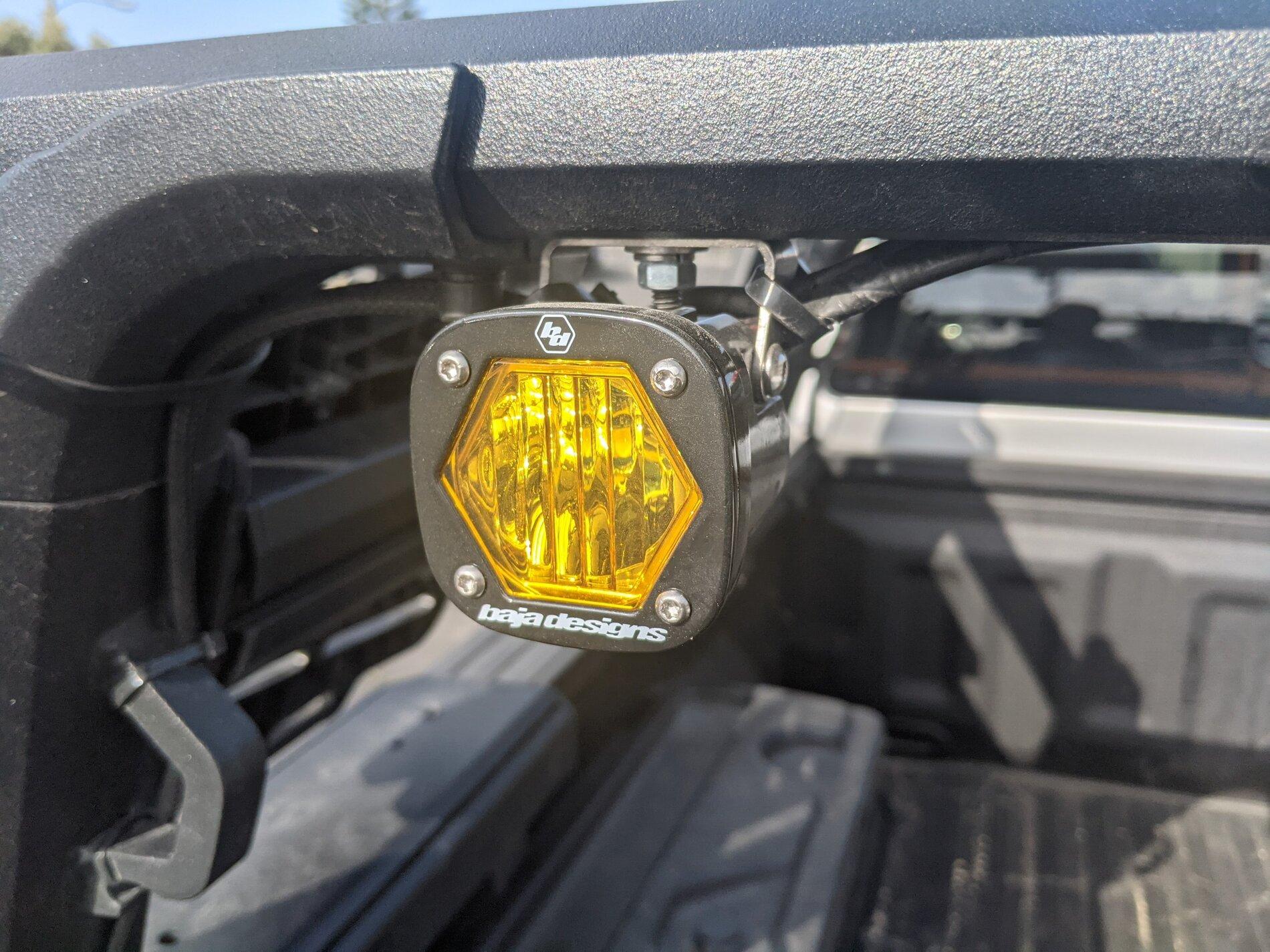

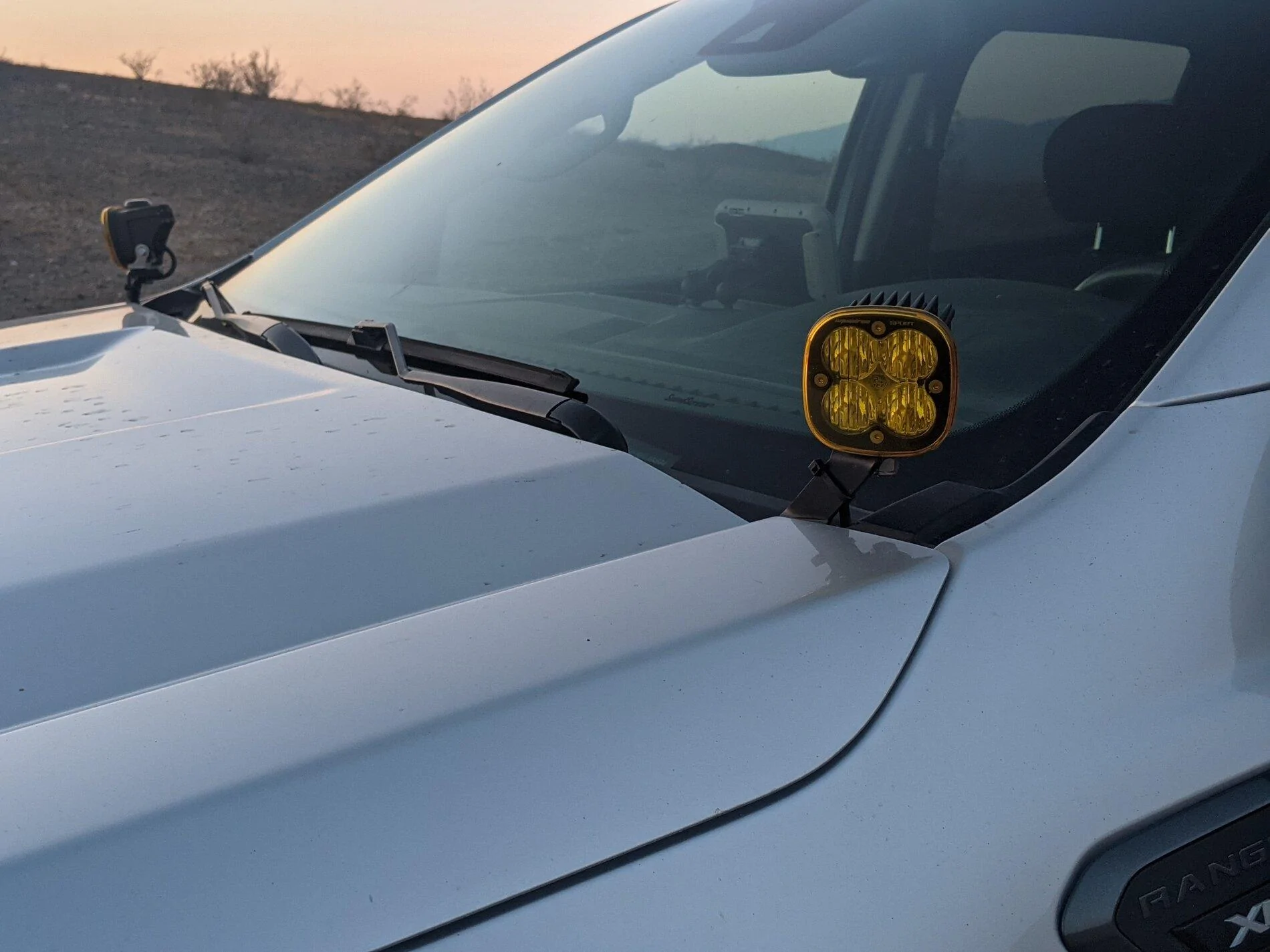

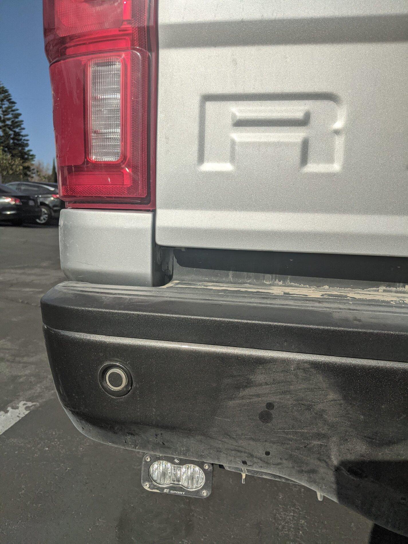

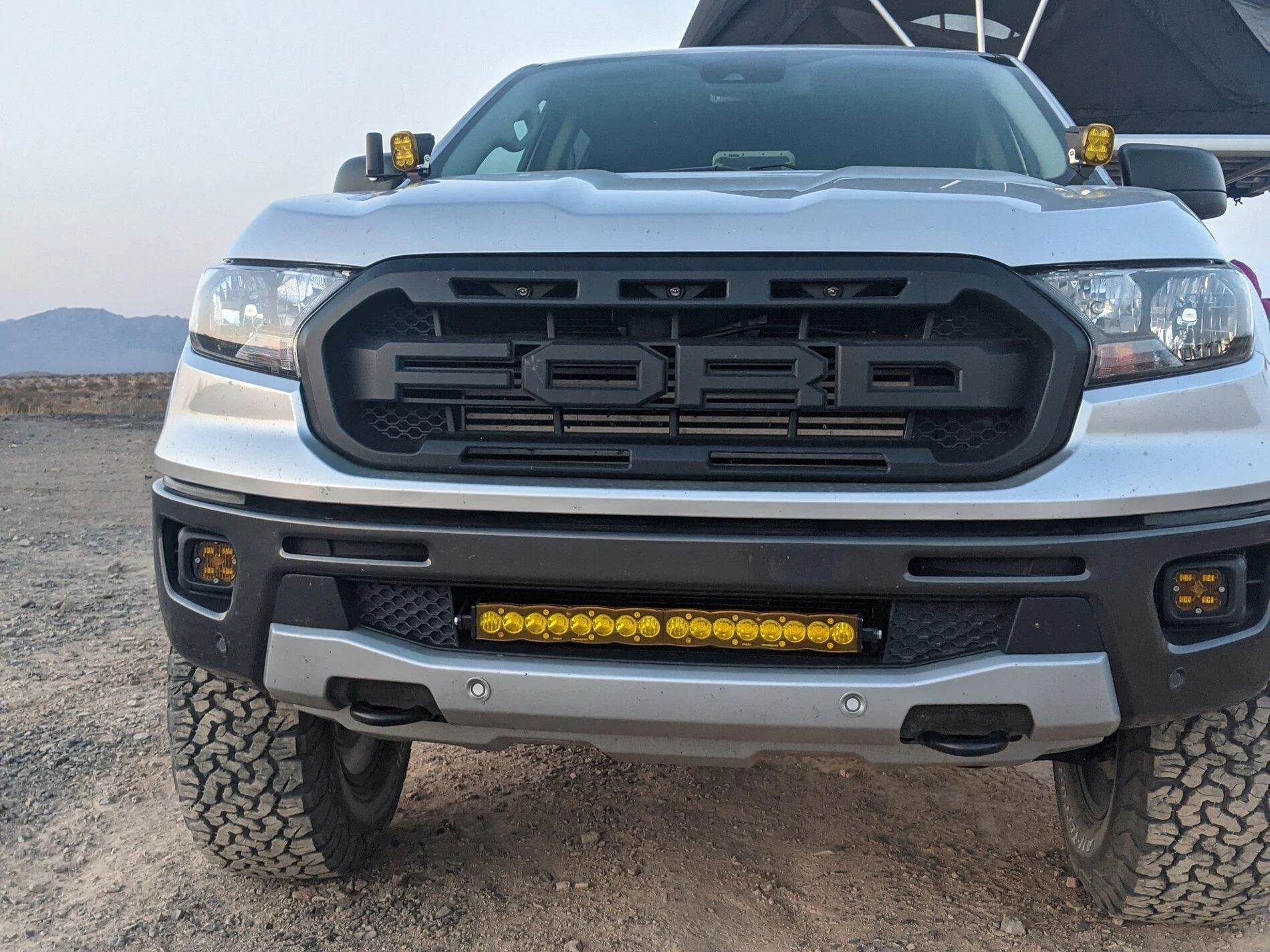

I realized that I hadn't talked about my light setup yet.
All lights are from Baja Designs. They aren't the brightest ones available. I chose Baja based on low power consumption, clarity, throw, and color. All of which are top notch. I have the S8 and Sport models. I wanted good light output without spending thousands so I went with their mid level light options. If you want to go brighter then go with the Onx6+ and the Pro models.
Lightbar
Baja Designs S8 20" Lightbar in Driving Combo in White with Amber lens covers.
(Also Shown)
Fog Lights
Baja Designs Squadron SAE in Wide Cornering in Amber
Ditch Lights
Baja Designs Squadron Sport in Wide Cornering in White with Amber lens covers
Backup Lights
Baja Designs S2 Sport in Wide Cornering in White
Side Camp Lights
Baja Designs S2 Sport in Work/Scene in Amber. I will be replacing the Amber lens with White for more perceived brightness
Chase Lights
Baja Designs S1 in Wide Cornering in Amber (These are really bright)

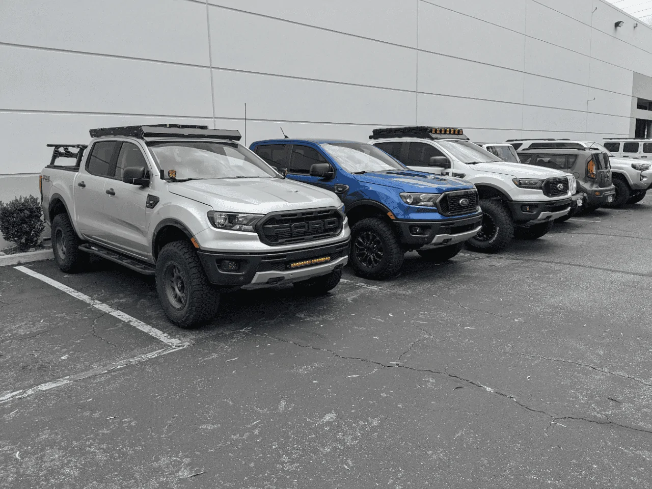

3 Rangers parked next to each other !!!
This was at a sales event by Overland Vehicle Systems. I ended up buying their 6.5 awning. Waiting on a rack specific mount before I bolt it on.

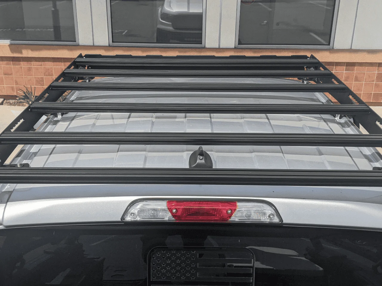

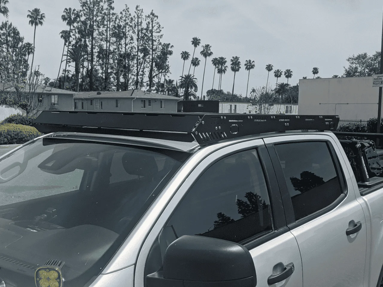

New Rack out in the wild
Your truck build looks great!
How's it going now that you are putting some miles on it with the roof rack on? Is it noisy or does it whistle at higher speeds? How was the install process? Would you recommend it to others?
Sorry for all the questions, but I recently bought the KC Hilites M-Rack. I'm not happy with the way they redesigned it. Plus it's so dang expensive to add lights to, since it's designed for KC lights. I'm returning it and now I'm torn between buying the, UpTop Bravo, Prinsu or Front Runner Slimline.
Any answers and advice is appreciated.
Yes and No for the recommendation.
The rack looks great up there. Noise is minimal compared to other racks that I have used on various vehicles. Install sucks. You must drill into your roof. Proceed with caution. This is the case for Prinsu and UptopOverland. I assume KC as well. Both Prinsu and Uptop use extruded aluminium for the the track system. This is ok. What I do not like are the sizes of the tracks. They both utilize M6 bolts instead of M8. The track nuts are crap but make for easy installation of mounts. The Rivnuts Plusnuts to mount the rack are garbage. I would use fender washers, split washers, bolts and nuts instead if I were to do it over again. The slats are adjustable so positioning them to fit your accessories is easy. Everyone and their mother has a prinsu installed on every taco that I see. Almost no one has the uptop so it's kind of nice being different. My rack is fairly quiet at 80+.
I have the following installed on the rack:
  • ARB Tred Pros
  • Goal Zero 100 watt solar panel
  • Axe and Shovel
  • 6.5' awning
I'll take some pictures this weekend of the entire roof rack setup. I did not opt for any light bar cutouts. I may go for the 30" cutout in the future but doubt it as I like my lights low
