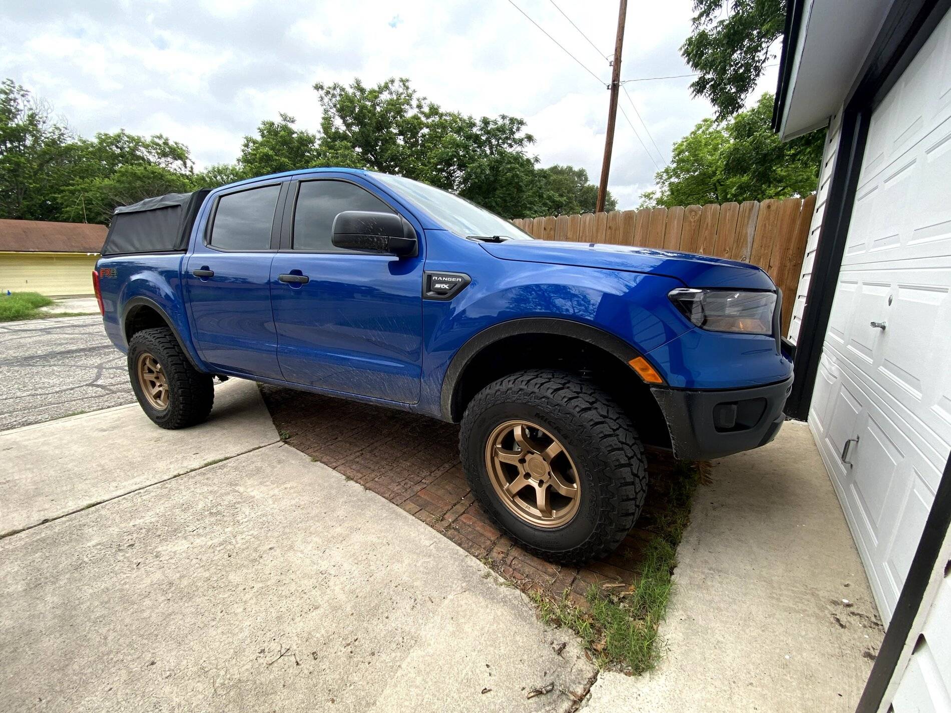

Here's a boring pic of my truck I plan to take better off road pics soon too.

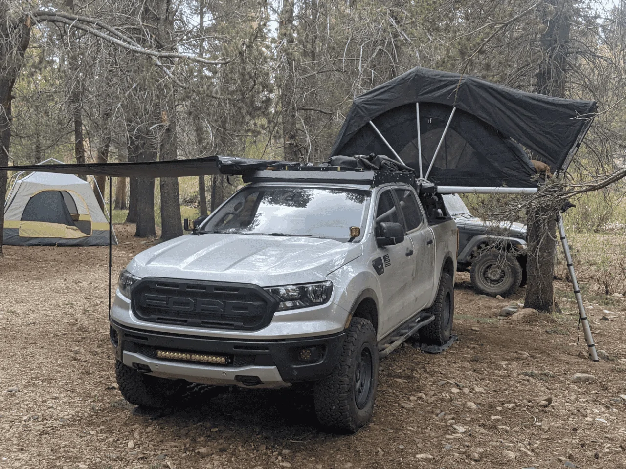

It is incredibly difficult to snap a good picture of the items installed on the Roof Rack with the Tent in the way. I need to park it next to a huge boulder and stand on it to get a quality picture. I will try doing that next time that I am out.
I made a bracket for my solar panels. I am using the UpTopOverland brackets for the Axe and Shovel and the Awning. After that there isn't much real-estate left. The Shark fin antenna kind of limits the use of the last crossbar unless you position items from front to back rather than side to side.

What brand is that awning? How well does it stand up to windy conditions?

OVS - Overland Vehicle Systems. They are a local shop. They had an event where I got to see products on display on multiple rigs. Setup is quick and easy. Winds? I don't know. I've only used it in mild wind so far. Nothing that would warrant using stakes.
Construction is like everything else. Made in China. I believe the same company makes the awnings for 23 Zero and a slew of other rebranded Chinese products. OVS just has them for cheaper because they are not a huge brand yet. The 6.5' awning is a great choice. 4' is just too small. I almost went with the 180 but it weighs too much for my liking.

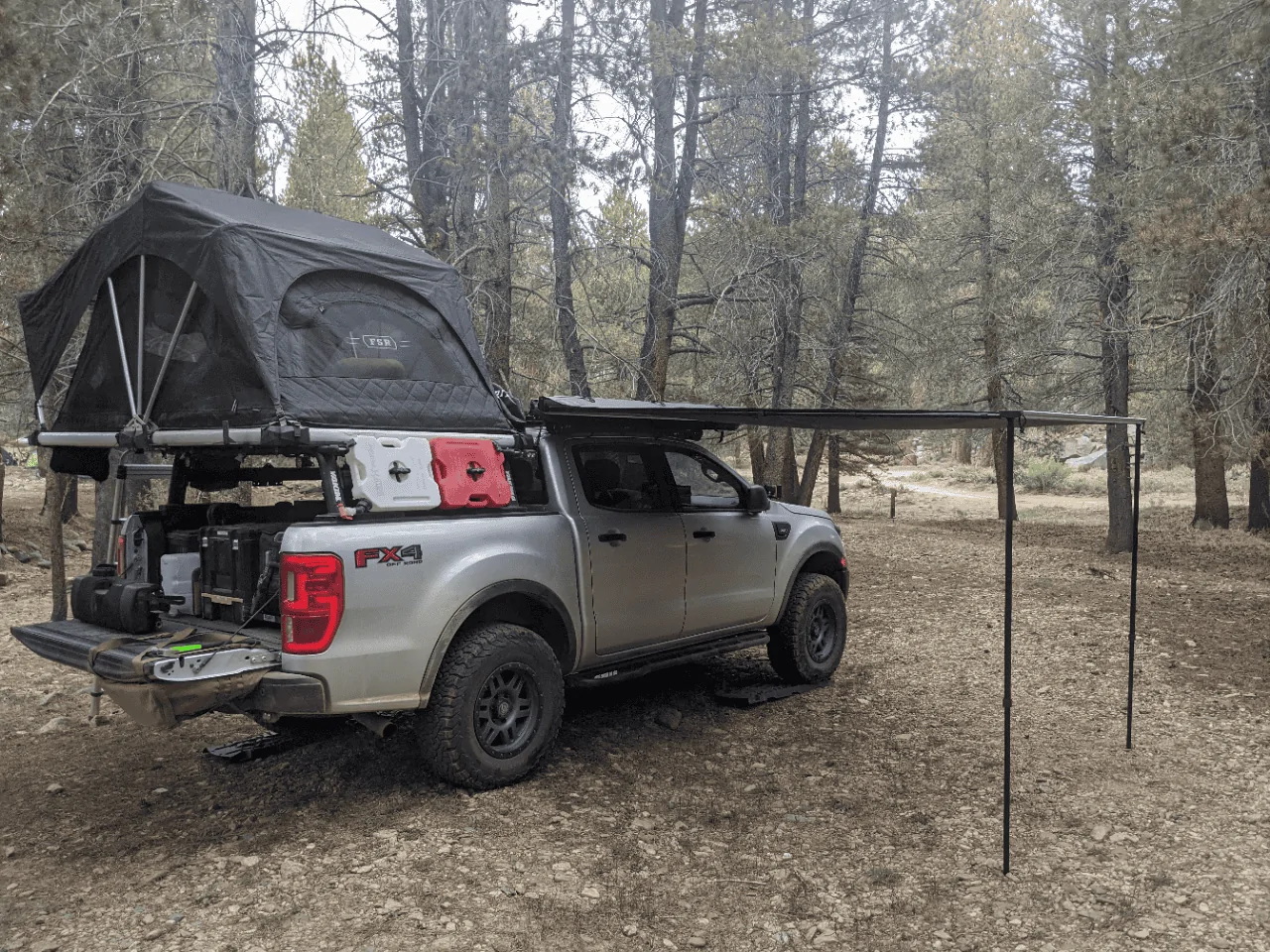

This a pic of the items installed on the UpTopOverland Bravo Rack.
  • ARB Tredpro Recovery Boards
  • Goal Zero 50 watt panels X2
  • Fiskars 36" Splitting Axe
  • Fiskars 44" Shovel
  • OVS 6.5' Awning
I purchased the Awning bracket and the Chop & Dig mount from Uptopoverland. The recovery boards are using a modified Yakima recovery board mount. The solar panels are using a bracket that I cut down to size and drilled out. I had to rewire the panels due to the cables being to short to fit in this orientation.

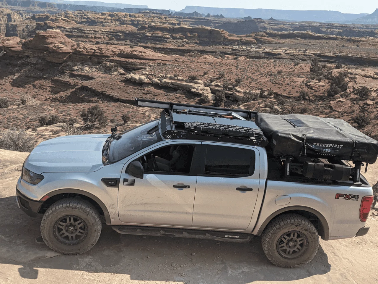

Here's a shot out in the wild. Picture taken on a trail to the Colorado Overlook in Canyonlands NP.
I have added the 3.8 gallon Waterport day tank to my setup. You can see it attached to the driver side bed rack. I upgraded the quick connect hose fittings to brass and swapped the hose itself. It came with cheap plastic fittings.

Is it just me or is your RTT base bowed from the weight (rear) in this picture?
That's funny. No, the hinged half that hangs over the ground isn't always level. I have to level it out by adjusting the extension height of the ladder. Sometimes when I'm on uneven ground I use blocks underneath the ladder. Or I get lazy and deal with a bit of lean.
The FSR tents have no floor. There are aluminum slats that hold a hard foam base in place. Then a mattress goes over the foam base. This design is very different from other manufactures. I get no condensation build up with this design. I was skeptical at first. After using the tent 50+ nights I can comfortably say that this design is great! I'm heavy and this thing has held up nicely.
