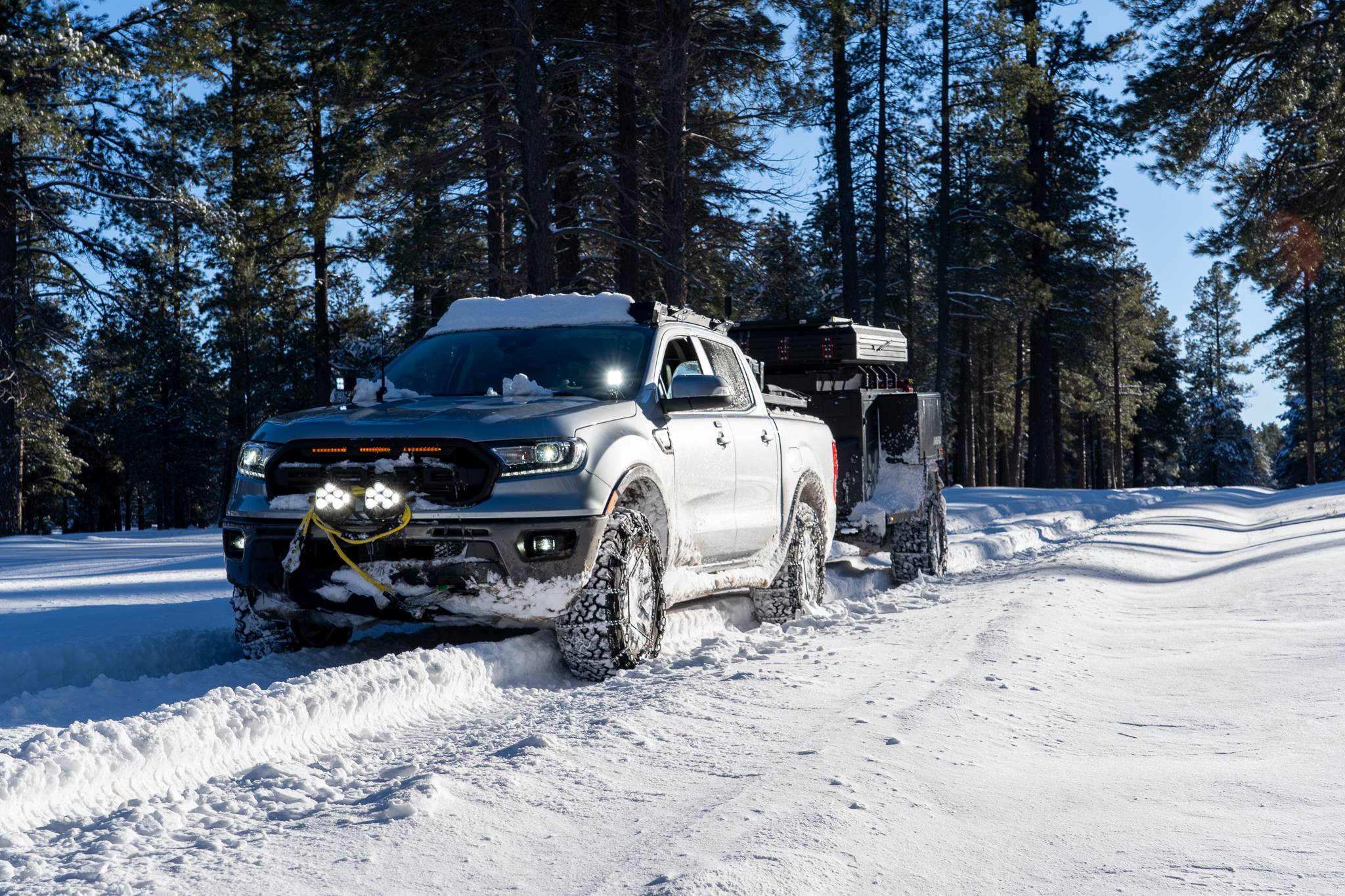

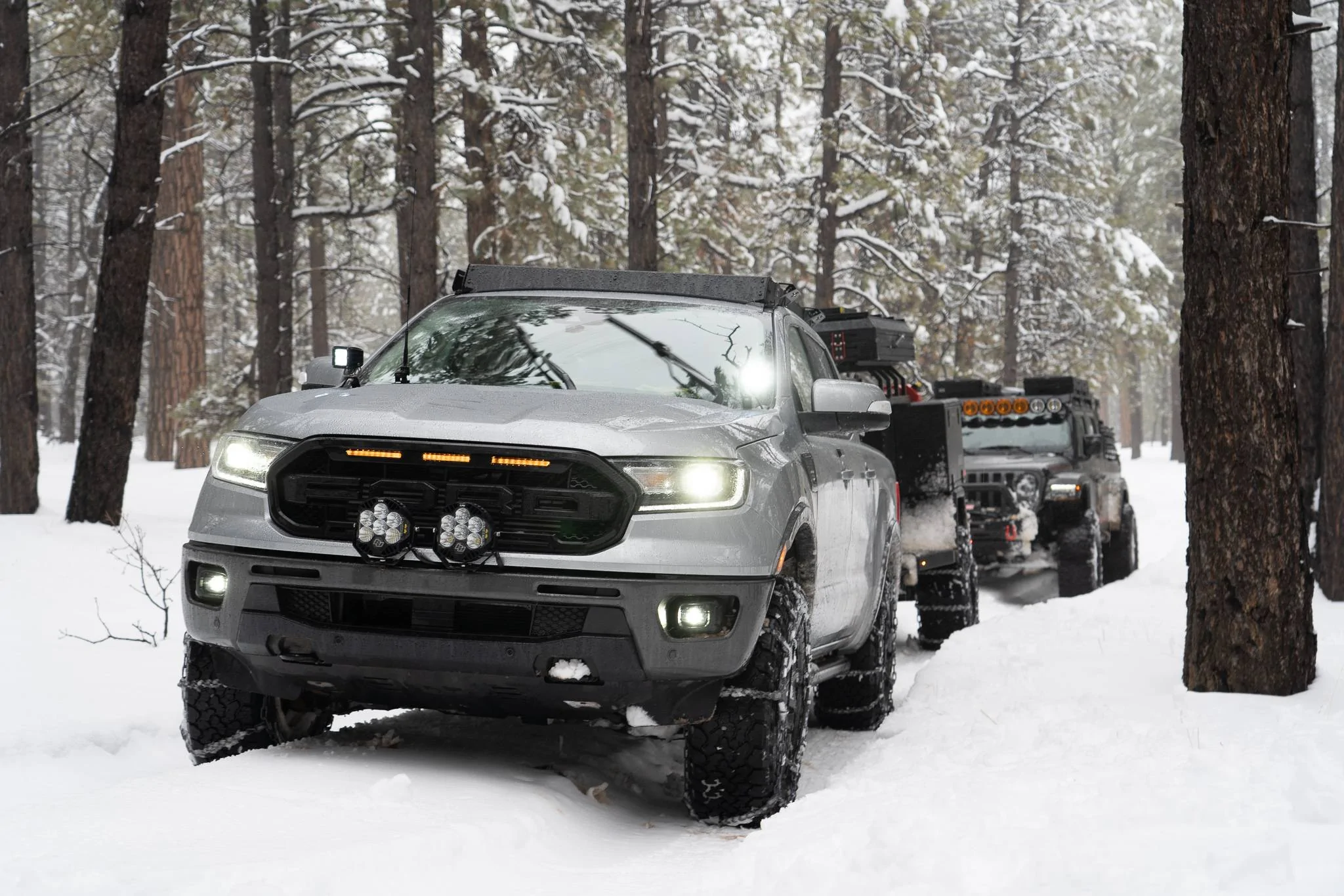

I want more info how you mounted those Baja lights and on the roof rack!
If I understand what you are asking, are you talking about the grab handles that double as lights? Those are actually a product from frontrunner for the slimsport rack.
If you are talking about the front lights, I used a straight bracket from something I had laying around and I found two holes in the steel bumper just in that slot between the bumper and front fascia. It was luck but it actually is stronger than any bracket I have used before!

What mounts and lights are you using on the front bumper ?
The lights are the Baja Designs LP6s and I happened to find two holes in the bumper. I used an old straight plate I found lying around and it actually worked to bolt it on. No disassembly required! and they are pretty dang rigid.

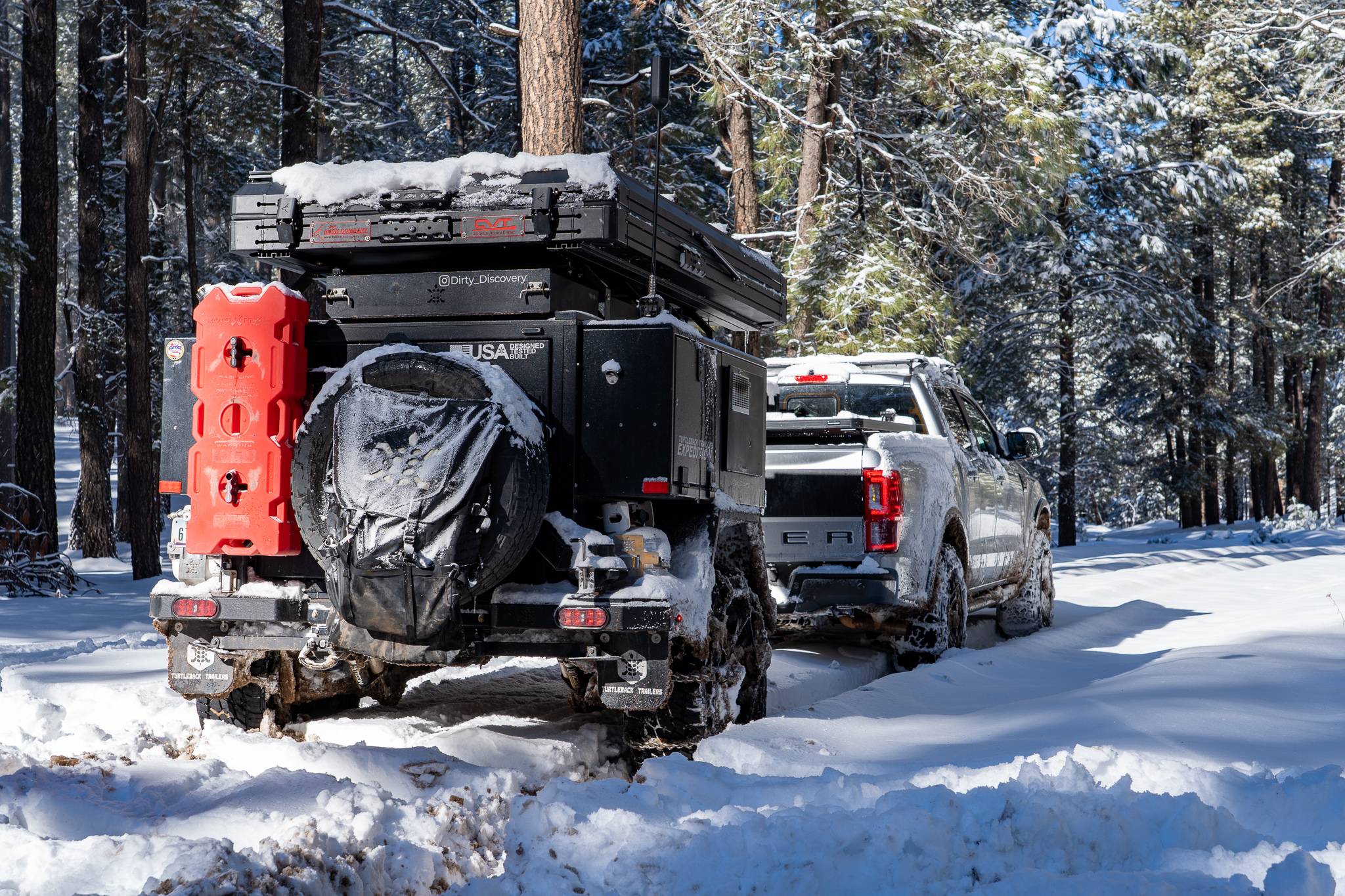

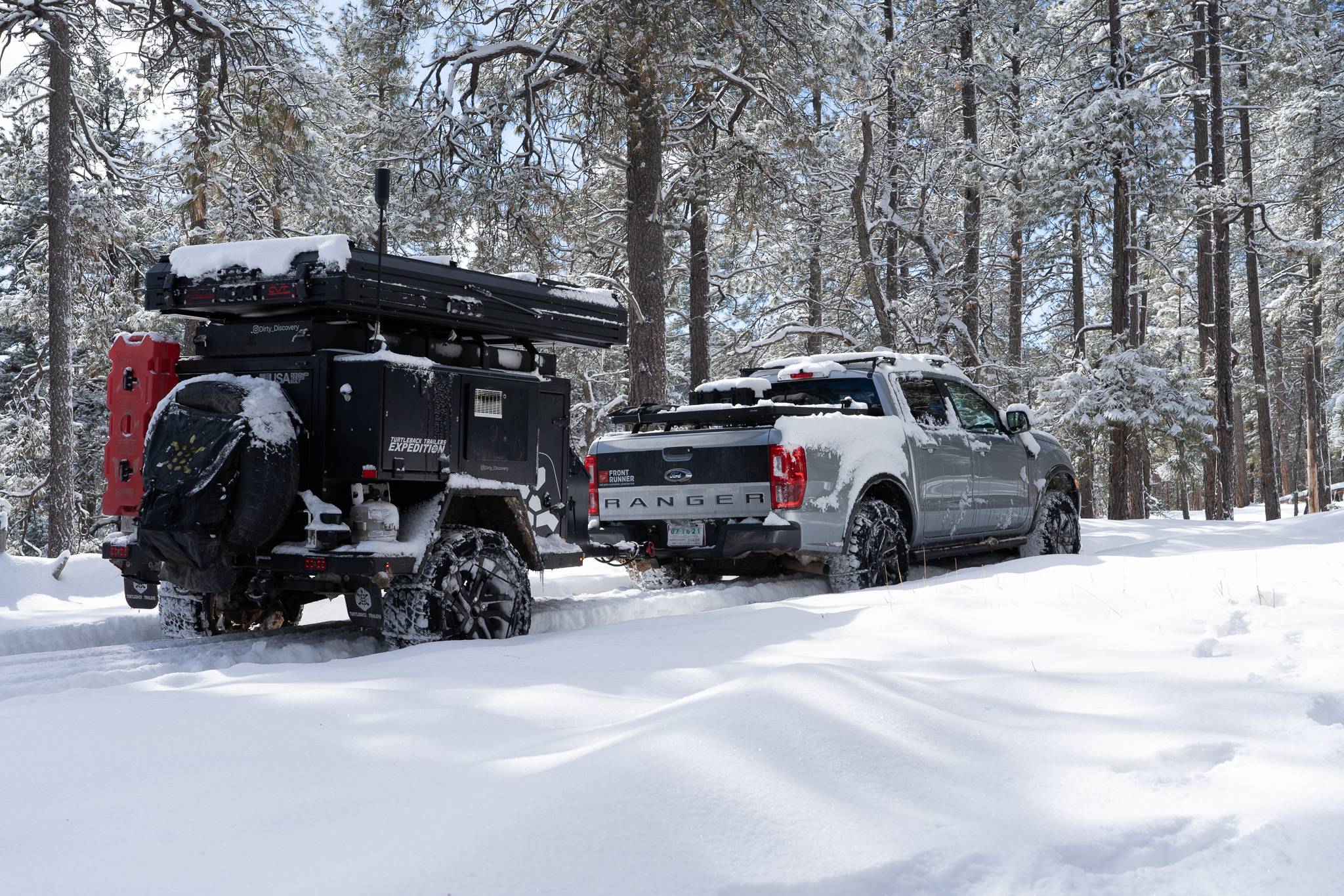

Sounds like you have a good baseline.
I like the slimsport rack because it is super low profile and has a ridiculous static load. You can stand on a single crossmember and not flex almost at all. I also like the grab handles on the side because they have integrated lights on them. I can post more photos of how I actually wired through the roof and in to the cab for the switch.
You hit is spot on about having a trailer. It can be a pain to reverse, turn around, and go up really technical stuff, but I love that I can leave camp set up and go in to town or on a late night run on a trail. Plus I have tons of room in the cab and my camping setup is as easy as food in the fridge, water in the tank and go!
I looked at a few trailers, mainly the turtelback trailer which I have and the Patriot campers. I also looked at Bruder, xpedition trailers, and a few other sleep ins. I went with Turtleback because their quality is insane and I can get it serviced by them in the US. Not so with Patriot. Turtleback also has a really cool team and awesome culture. They do group trips frequently.
If you want sleep in go with xpedition. It is a new trailer, but I spent a lot of time analyzing it to see if I wanted to make the change. Incredible experience from the company in other fab stuff. It just didn't work out for the budget and I just spent 5K on a new RTT
As for the packout boxes, I just use Frontrunners strachett to secure them with some hoop things. I dont know what they are called haha.
Thanks for the reply. i was thinking that would be a great place to mount up some lights!

Holy !&($ that is something to strive for. Just out of curiosity, I've never seen anything like it-- what on Earth is that trailer set-up? Looks wicked

If you want sleep in go with xpedition. It is a new trailer, but I spent a lot of time analyzing it to see if I wanted to make the change. Incredible experience from the company in other fab stuff. It just didn't work out for the budget and I just spent 5K on a new RTT.
I’ve narrowed my trailer selection down to Xpedition and Boreas. I’m going to rent both from XGRiD Campers out of Vegas and see which I like best. Feeling pretty confident that Xpedition is the way to go, but the chassis and suspension on the Boreas appear to be bomber.

What are the advantages of Front Runner’s SlimSport over the SlimLine roof racks?
The slimsport is much lower profile than the slimline ii rack. I assume that the wind noise on the slimline ii is much greater than the slimsport rack. It still has a lot of useful load, but its just closer to the cab.
