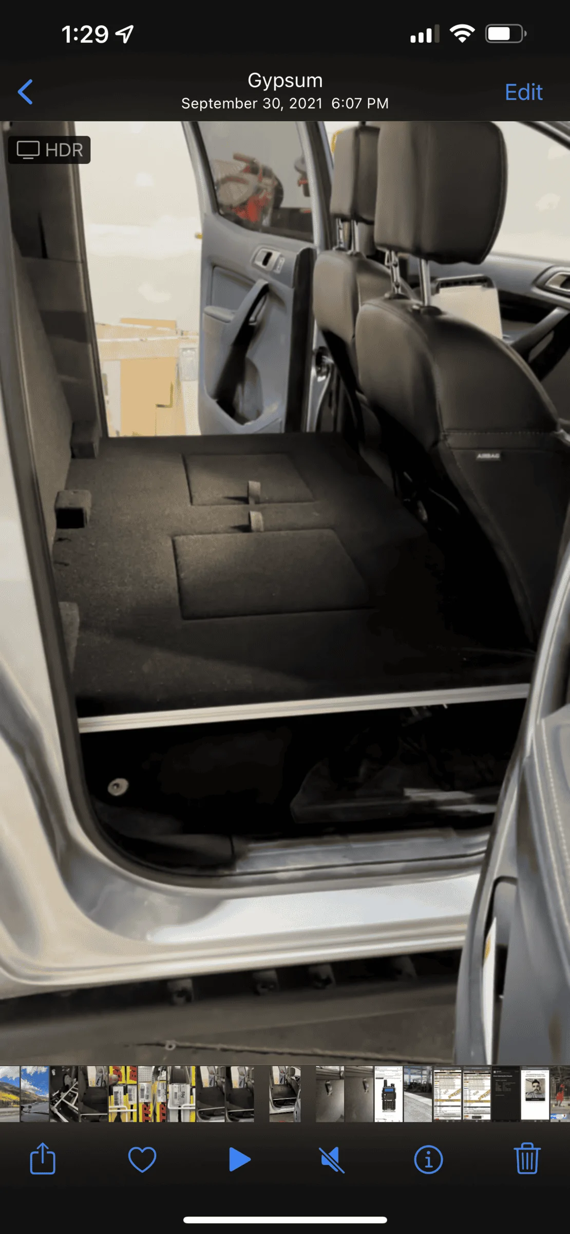

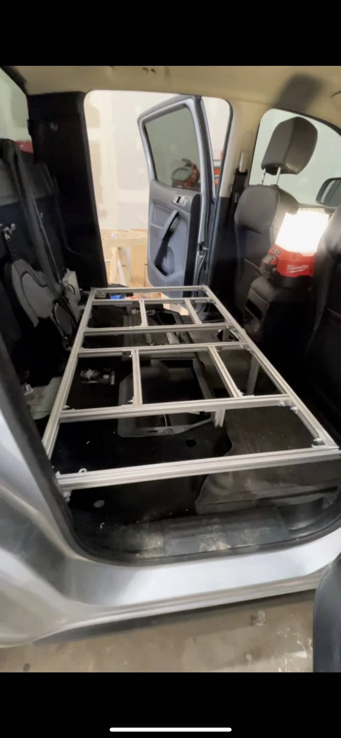

Hey John,
I just watched a youtube video on how to remove the back seats and then I used 80/20 aluminum to build the frame and mount directly into the existing factory seat holes. I then used the frame that I built on top as a template to cut out some plywood in order to mount that on top.
The seatback portion was a little tricky. I couldn't find a way to mount it, so I used a buckle and some straps to hook to the seat mount, just to keep that thing from falling forward. And then I used some blocks on the bottom and screwed in to the back portion in order to keep the bottom from shifting.

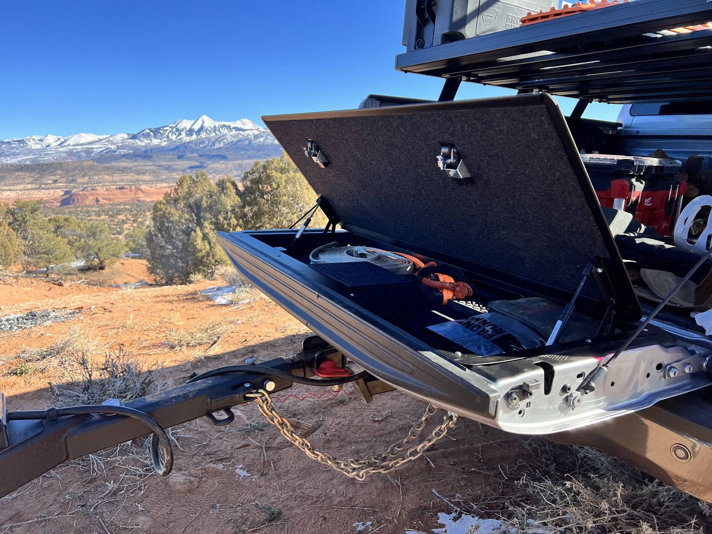

A few more details here. I will continue to post and update my build progress.
Here is the Huracan Fab rear tailgate storage solution and a seat delete I built for the rear seats. I will be building removable storage modules.
Your tailgate has 2 dampers...
