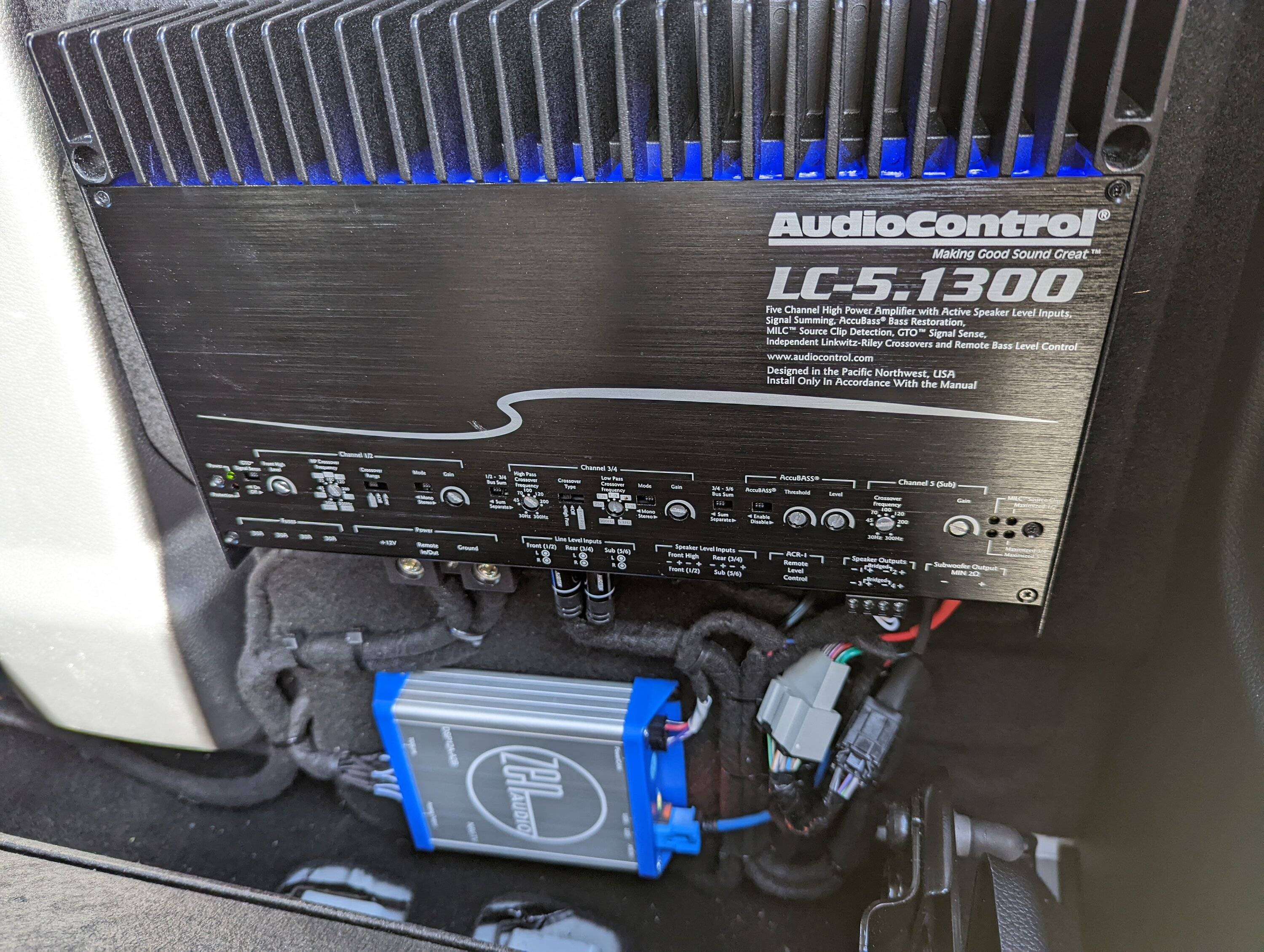

I would highly recommend using an Audiocontrol 5 channel amp. Its clean, gives you lots of adjustment capability to include summing, and it has the power needed to run all of your door speakers and subs.

Very true. I like the ability to set and change gains with zero distortion. I have adjusted it to my liking at the moment and will continue to tweak it as I listen to it more. Clarity and an even frequency response is what I look for. I like punchy bass and matching midbass to match it. So far so good! I am very impressed with it, although it wasn't cheap. Maybe I will sell all of my B&O equipment now. This would make a really nice system for someone.

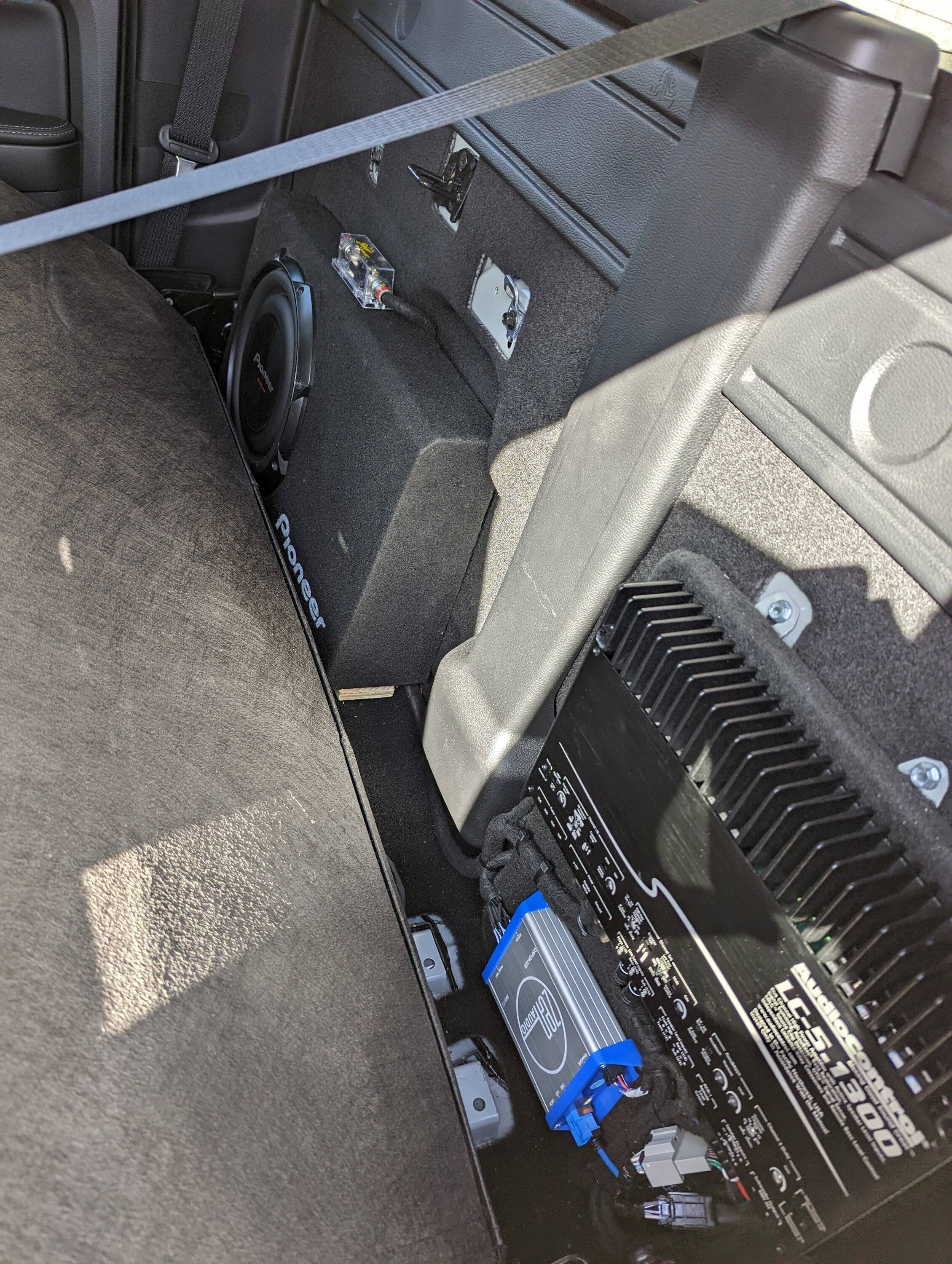

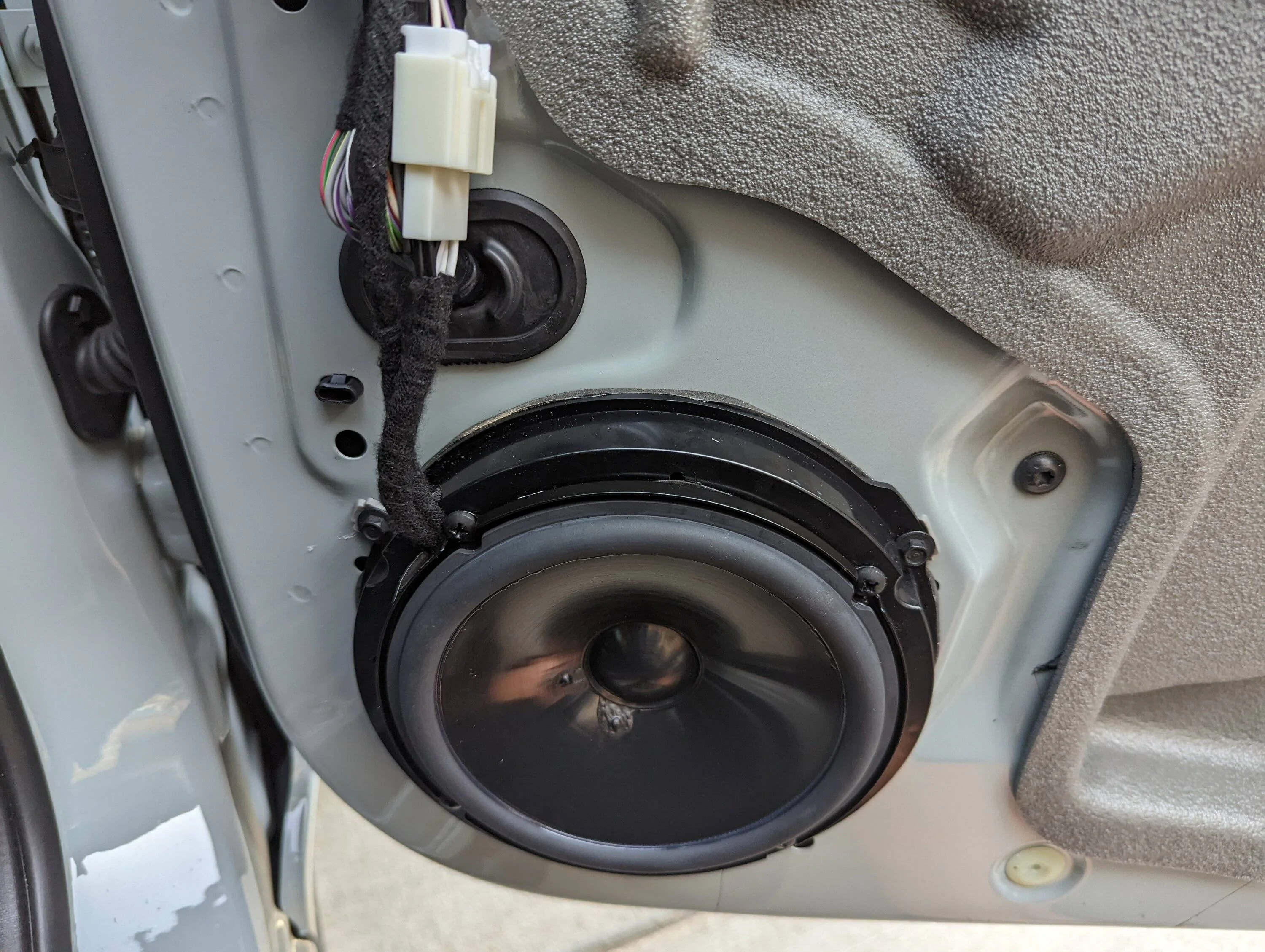

I did a lot of research prior to changing out the B&O system in my 2021 Ford Ranger. I swapped out the front door speakers with Infinity component 6.5 inch. The rear doors I swapped out with 2 Infinity Coax 6.5 inch speakers. I removed the B&O Amplifier and added a nav tv a2B zen interface and a 5 channel audiocontrol 5.1300 amplifier which gives me 100watt RMS per channel to all of the door speakers and 500 Watts RMS at 2 ohms to the 2 Pioneer 10 inch subs. After tuning this beast it sounds amazing! Just the right amount of crisp clear mids and highs with nice tight bass coming from the 2 sealed 10 inch enclosures. Check out these pics and thank you for checking out my build!

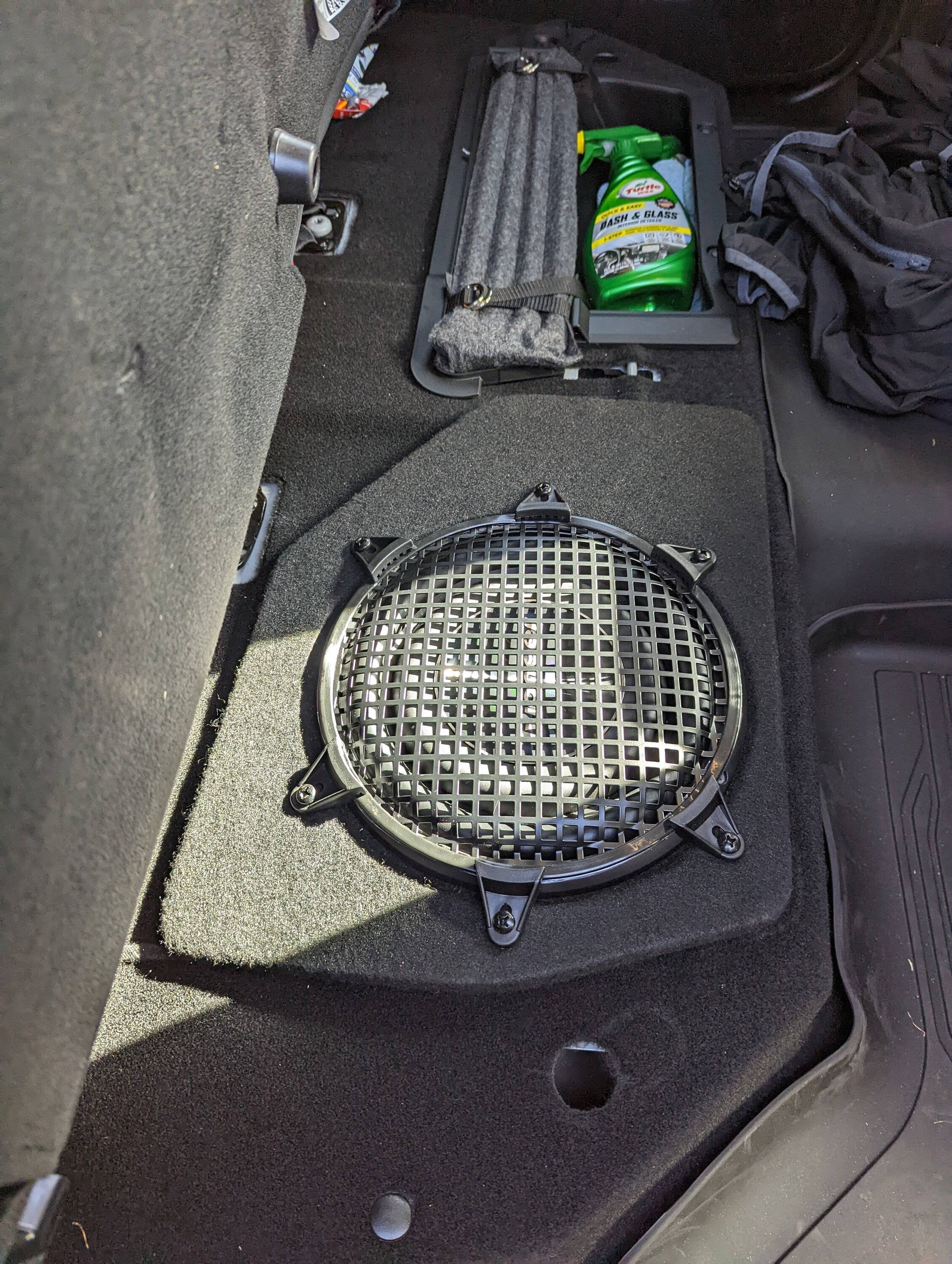

What pioneer sub/box is this ?
I bought it used with the sub in it already so I'm not 100% sure. After looking for a new one to purchase for a couple weeks I determined it must be discontinued. I'm going to be building a new one which will be more narrow but longer and have slightly more airspace. Thanks for looking!
I put a 10" Pioneer TS-W254R subwoofer driver in an old Kenwood speaker cabinet, ported and tuned to about 25Hz, driven by a BOSS 2000m Monoblock amp. Speaker rides in back seat like passenger. Very ugly but sounds GREAT. VERY deep bass. Your setup is WAY more aesthetically pleasing. I also killed all of the motor / exhaust sound "enhancements" with forscan. Otherwise stock system gets plenty loud w/o distortion as the sub offloads some of the power which would otherwise go to making the little door mounted speakers do the bass.

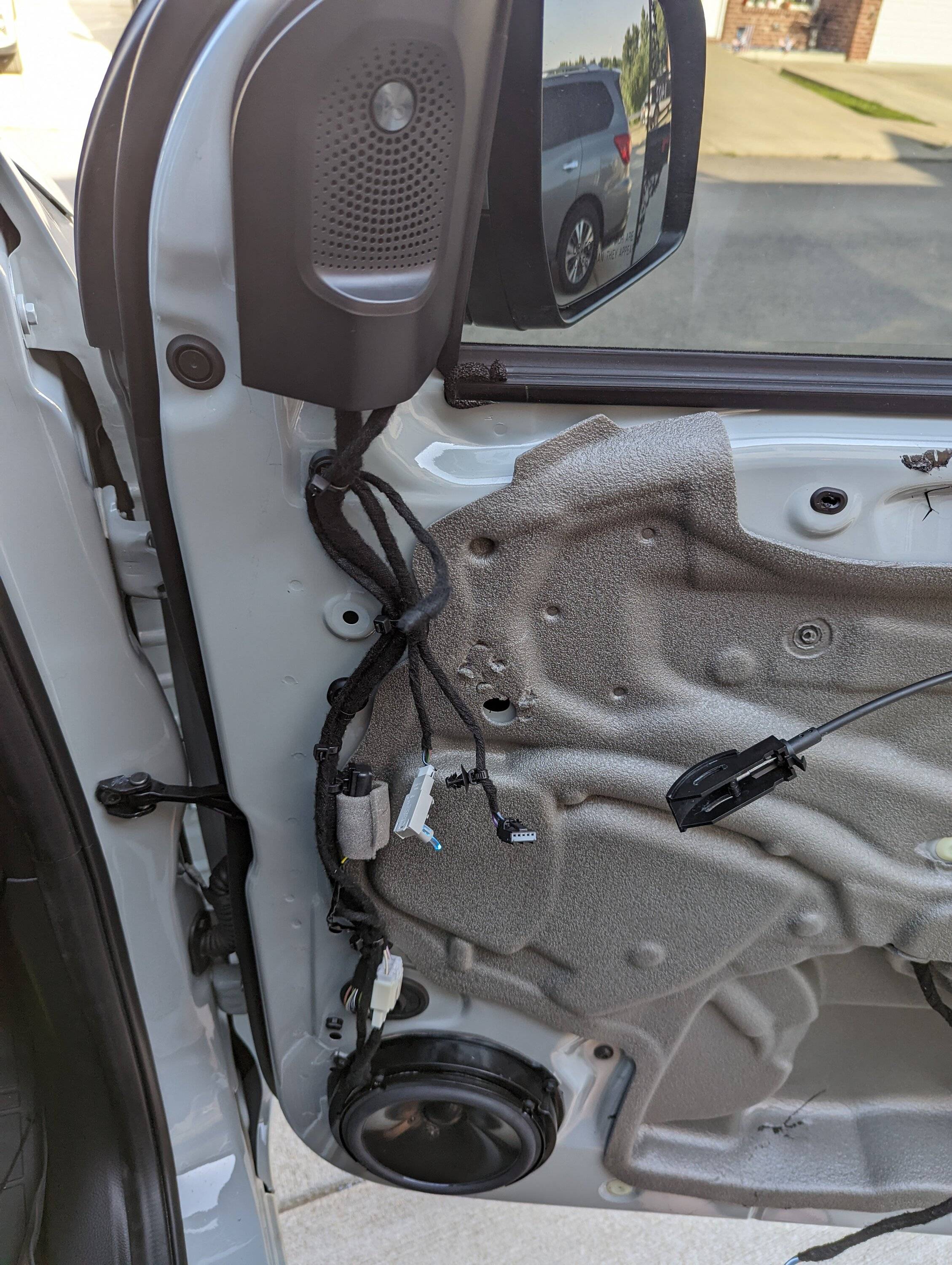

Road noise can be difficult, however I have lined my doors and rear wall with sound deadening and it did make a huge difference. It's impossible to get rid of all of it but my Ranger now sounds more like a Lincoln or caddy inside.

I was surprised how much better the stock system sounded just by adding sound mat.
