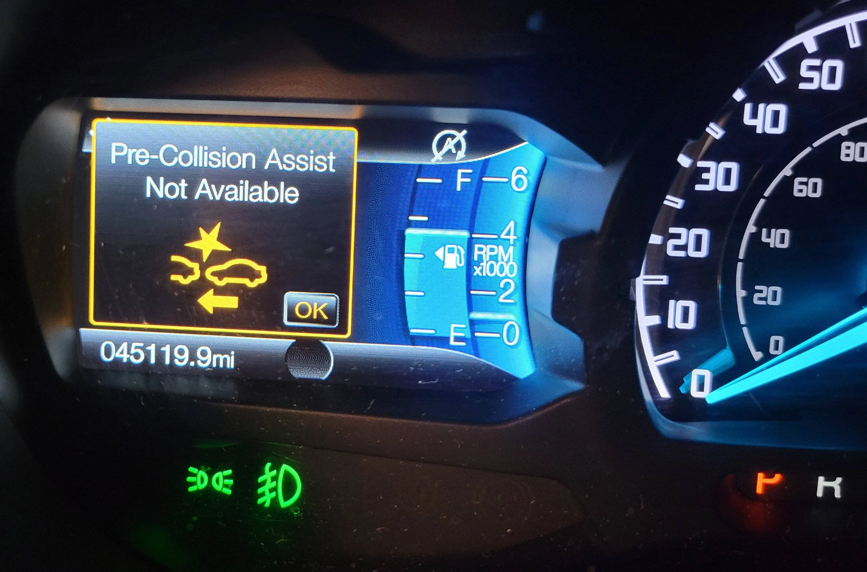

I'm hoping to tap into some of you Forescan pros out there for some ideas.. Over the past year, I have become fairly fluent with using the program and have really enjoyed many of the changes, particularly The Battery Saver Mod, Bambi Mod and the Tire/Speedo Recalc for my Larger tires, just to name a precious few.. Recently, I went back in and as I was making a few more "tweaks", I apparently got too greedy and inadvertently inflicted myself with a "Pre-Collision Assist Not Available" error that I cannot seem to clear. I found the code easy enough, which gives you multiple choices to select the following: 1) None 2) Disengage 3) Radar Assist 4) Camera Assist. I have tried writing all 4, but it will not remove the error, unless I clear it using the OK button from the steering wheel at each start up. I've also gone in and tried modifying the adaptive cruise control settings, since I know this could be tied to it, but still no luck what-so-ever. In the past, I've discovered, that by disengaging, then re-engaging selections that this oft times resets the item you're attempting to reprogram. - Made that mistake changing the rear camera from analog to digital, but even that maneuver has been fruitless.
That all being said, if anyone out there has encountered something similar or has any fresh ideas, I'd love to hear from you.

Only thing I can think is to clear the area in front of the radar in the grill, or in front the camera on the windshield... I forget which that uses. Once when I was driving in wet snow my radar would get covered up and I'd get a warning about something not being available... I forget now what it was.

Thanks Tom,
If there was a way to have done an excel of all of the defaults in the beginning, that would have been the winning ticket for me, then I could have had an extra tab of the changes.
I know I don't have anything blocking it. The error came immediately after making several bulk changes. I made the heinous mistake of not doing them one at a time, then noting them. Chances are, its a combination of things which will take a good bit of time poking around to find. Unfortunately, it's just not clear what the cause is.

Thanks Tom,
I wouldn't think anything in forscan would change that pre-collision, but I honestly have no idea.
But, there is a way to find/download all the as-built stuff for your VIN. I can't point you to it, but hopefully someone will. You can download exactly how your truck was built and put everything back to stock.
Ask mr. google:
https://forscan.org/forum/viewtopic.php?t=4393
https://forscan.org/forum/viewtopic.php?t=22741

I believe we may be on to something. The As-Builts would have the original defaults. - Of course, if I roll it all back (assuming I could even do that), I would just have to redo all of my previous updates again. Might actually be less of a pain to do it that way, quite honestly, than hunt and peck.
On a completely different side note; I accidentally discovered that the Factory settings were incorrect for the stock tires. Anyone out there with a Lariat having the Hankook 265/60/18 will likely have 2356mm as the stock values. This is actually for the 17" rim and not the 18" rim, so your speedo and MPG reading would slightly be skewed.
