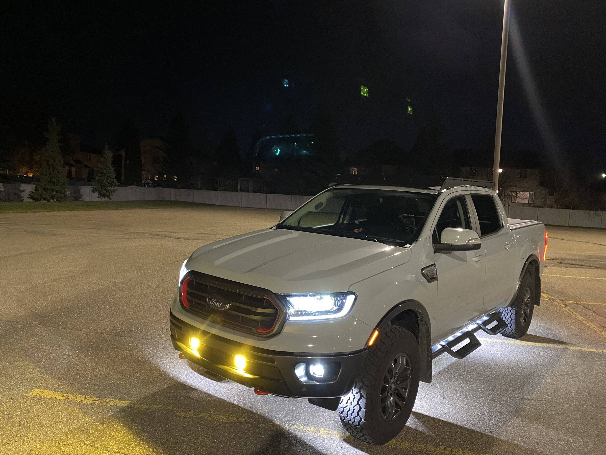

I could’t bring myself to remove the OEM fog (driving?) lights. So I just added the DD to the middle opening in the bumper. ??
Can I ask what brackets you used to mount? I was going to put a light bar there but realized I couldn’t with adaptive cruise.
I made my own bracket. I do t have great photos.
I used 1”x1” aluminum angle. I attached a vertical piece to each of the bumper mounts. I then attached a horizontal piece to those vertical pieces.

under the lip of the front bumper where the lp holder goes is two small holes that go into the plastic but also through the steel of the bumper. I used those to put mounts in the past. worked well. no drilling.
