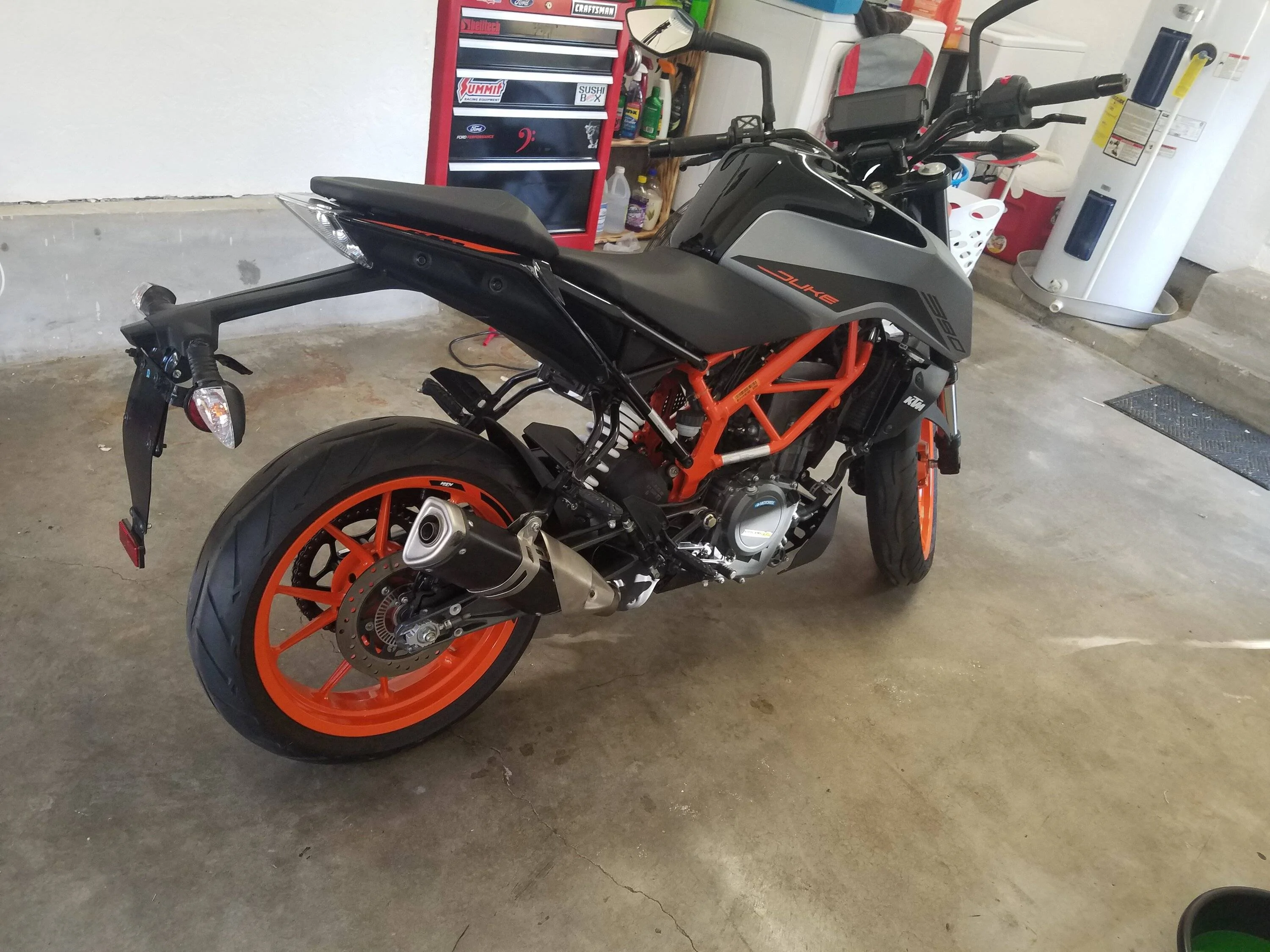

Just got my first motorcycle. Managed to snag a '21 KTM Duke 390, 2500 miles for $2,000 at an insurance auction for theft recovery.
It's definitely a bad time of year to try to get into a MSF course. Every class near me is booked for weeks. I managed to find an open spot about 2.5 hours away.

Did the bike suffer any damage from the theft?

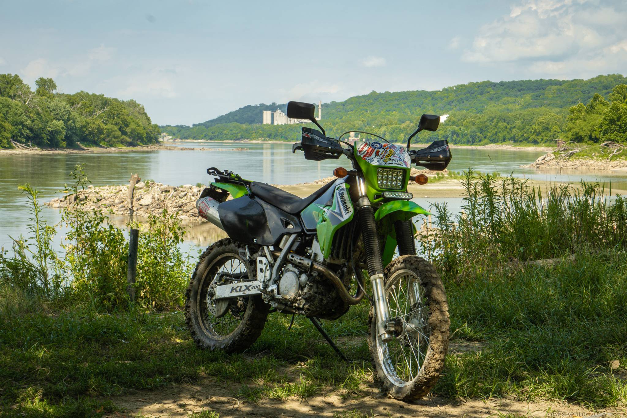

Sigh no more ridding for me… kazuma has had an issue with its timing chain so we found out it was the adjuster was jammed and fixed that so it was running great for awhile and went out and did some single track and had fun but on the way back it started running really bad and started stalling at stop lights… we’ll eventually it stalled at a light and I went to turn it on and it failed and now it won’t start… it just spins so I’m thinking either the timing chain flew off or broke or something in the bottom end was the main problem but my bike is dead for awhile so there goes what I love to do on the weekends for a break.. can 2022 be over? Not much has gone right this year…
so since the bike broke i have taken it apart partially when i have the time...
first thing i found is the timing chain is intact and tight so thats odd right? looked at the cams and they seem to be alright as well.. so i put a 17mm on the crank to spin it by hand (after taking the spark plug out) to see if the piston moves up and down which it does! alright but still issues and still no start then i noticed that when turning the crank by hand all that moves besides two things... the timing chain and the cam shafts do not move with the rest of the motor... so im gonna pull the cover off on the clutch side after draining the coolant to see what all is broken down there...

Ignition and gas cap were trashed. It was missing a couple component covers and bolts. Needed a new battery. The tips of both levers were broken, and 3 out of 4 signals were broken. I'm probably in around $400 for parts, fluid changes and maintenance, but the bike is pretty much back to brand new condition.
